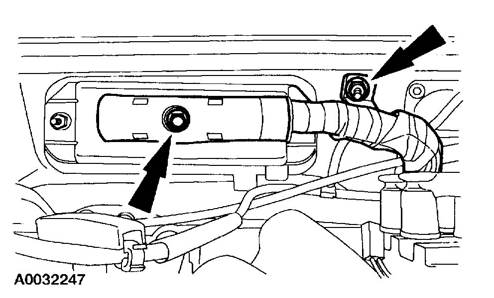

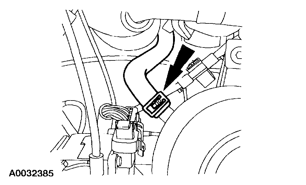

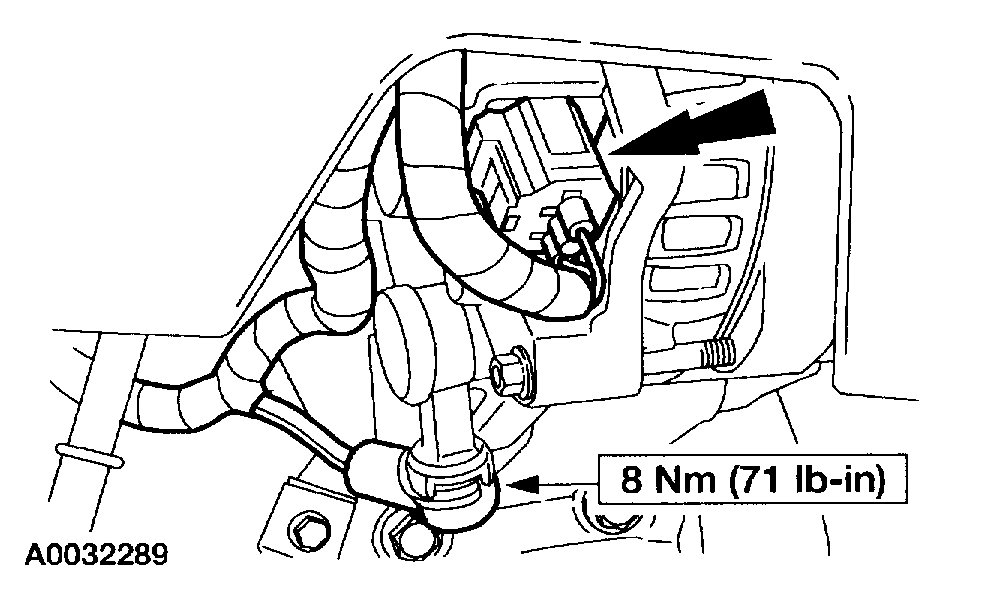

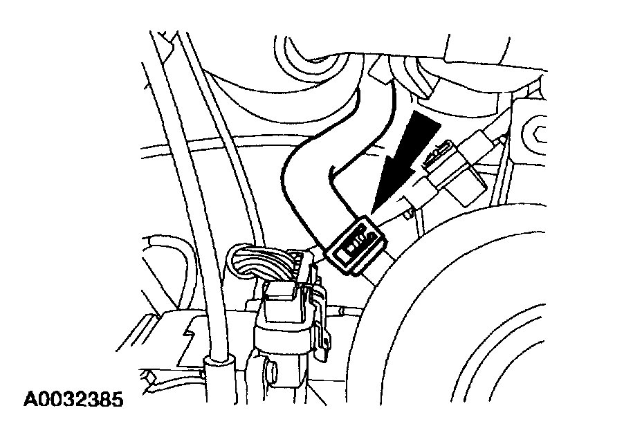

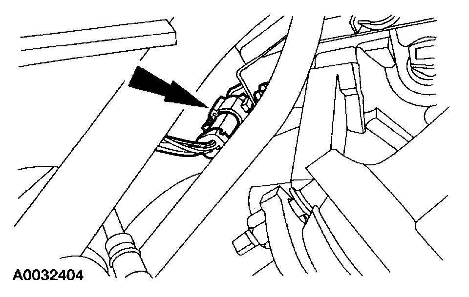

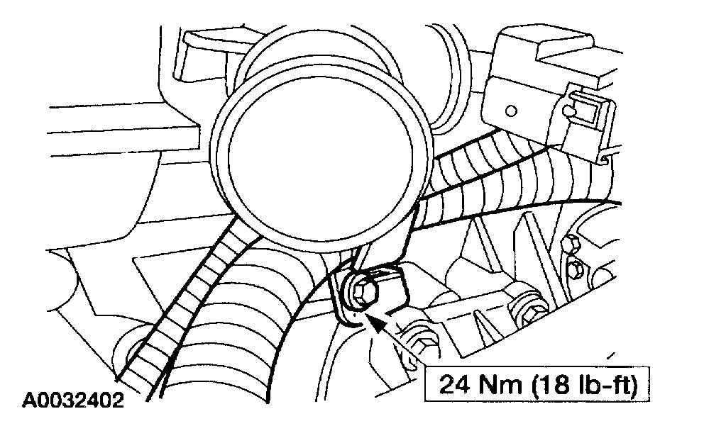

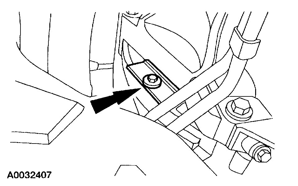

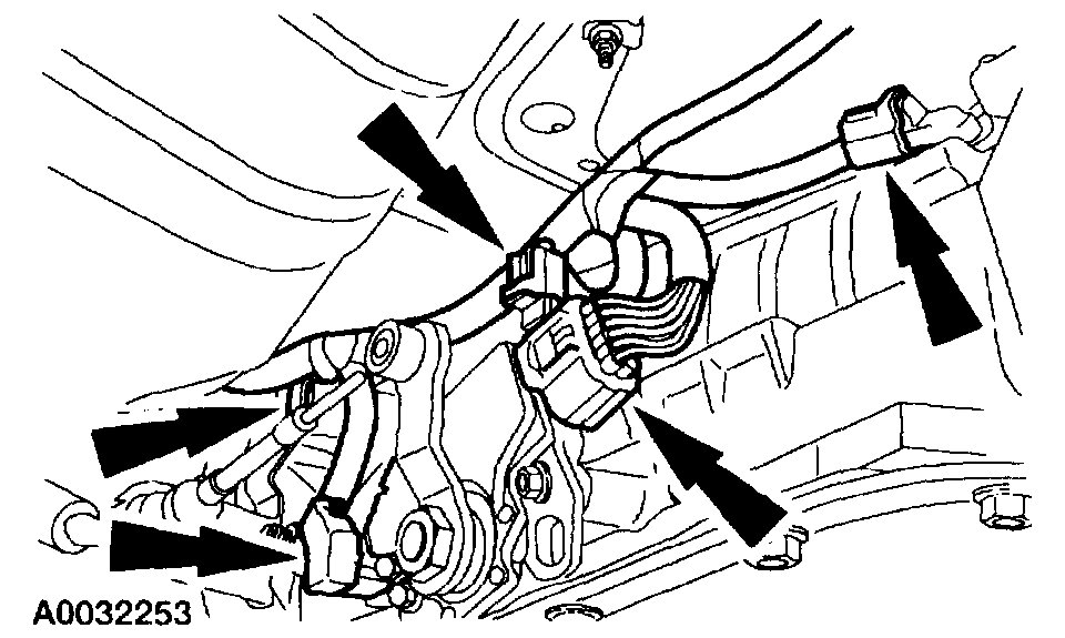

Do you have a step by step video on how to remove an engine for the truck listed above?
Mar 5, 2020 at 9:38 AM
Good evening,
I attached a YouTube video for you of the engine removal.
https://www.youtube.com/watch?v=_flmBs03uDY
Mar 5, 2020 at 10:16 AM
  • 110,236 POSTS

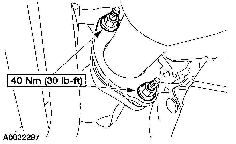

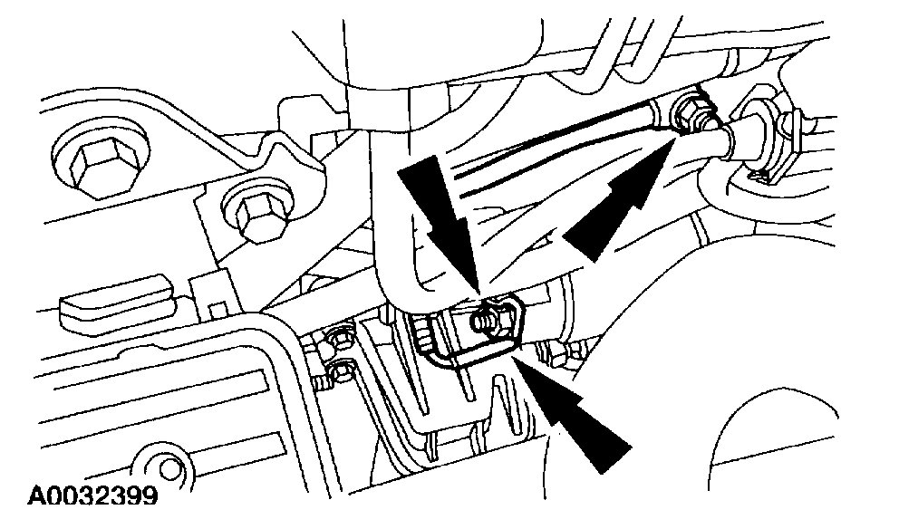

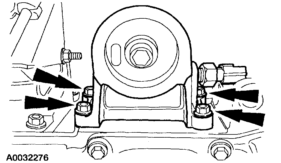

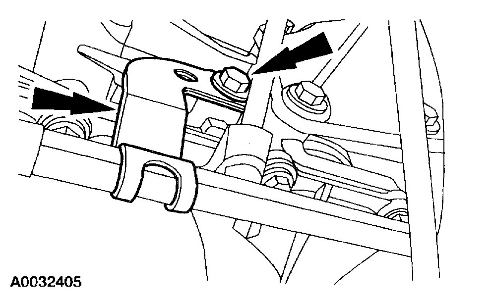

I don't have a video, but do have step by step directions. Here they are. Note that I am assuming this is a 2wd vehicle. If it is a 4wd, let me know.
_________________________________________________________________
2001 Ford Truck Ranger 2WD L4-2.3L VIN D
Removal
Vehicle Engine, Cooling and Exhaust Engine Service and Repair Procedures Engine Removal
REMOVAL
Engine

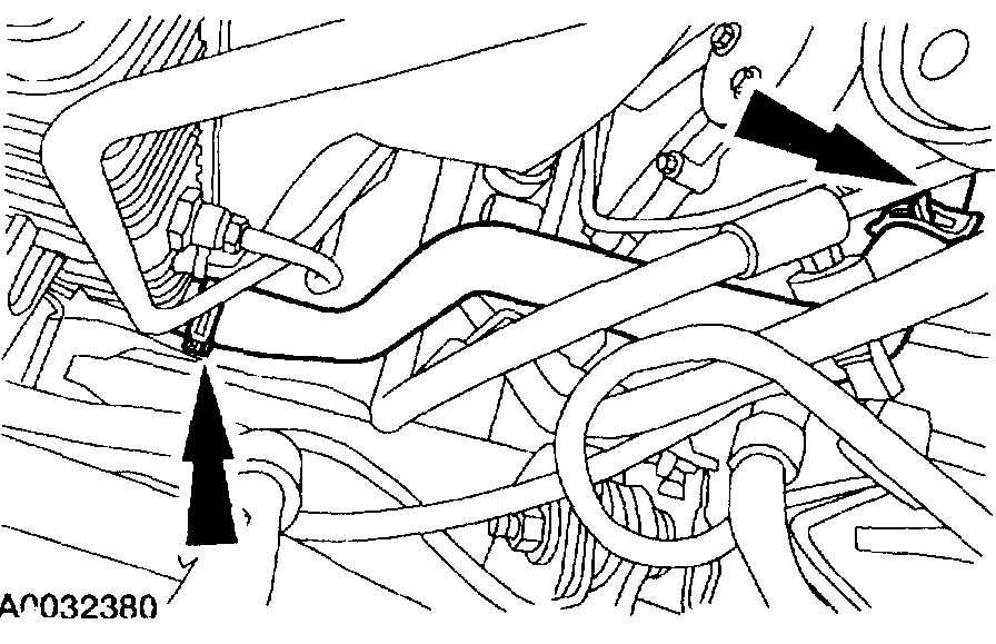

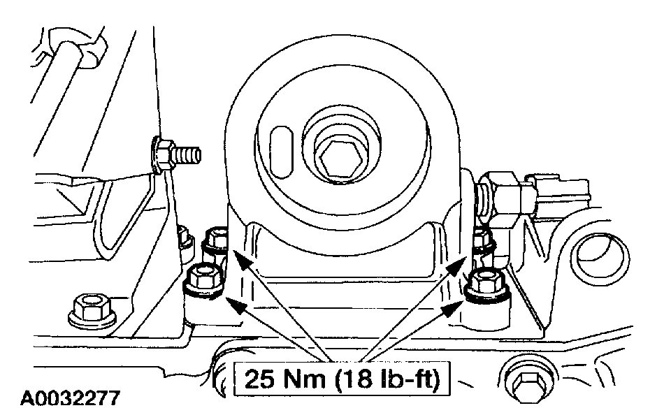

pic 1

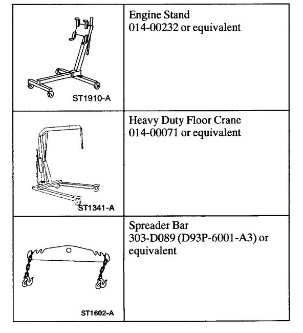

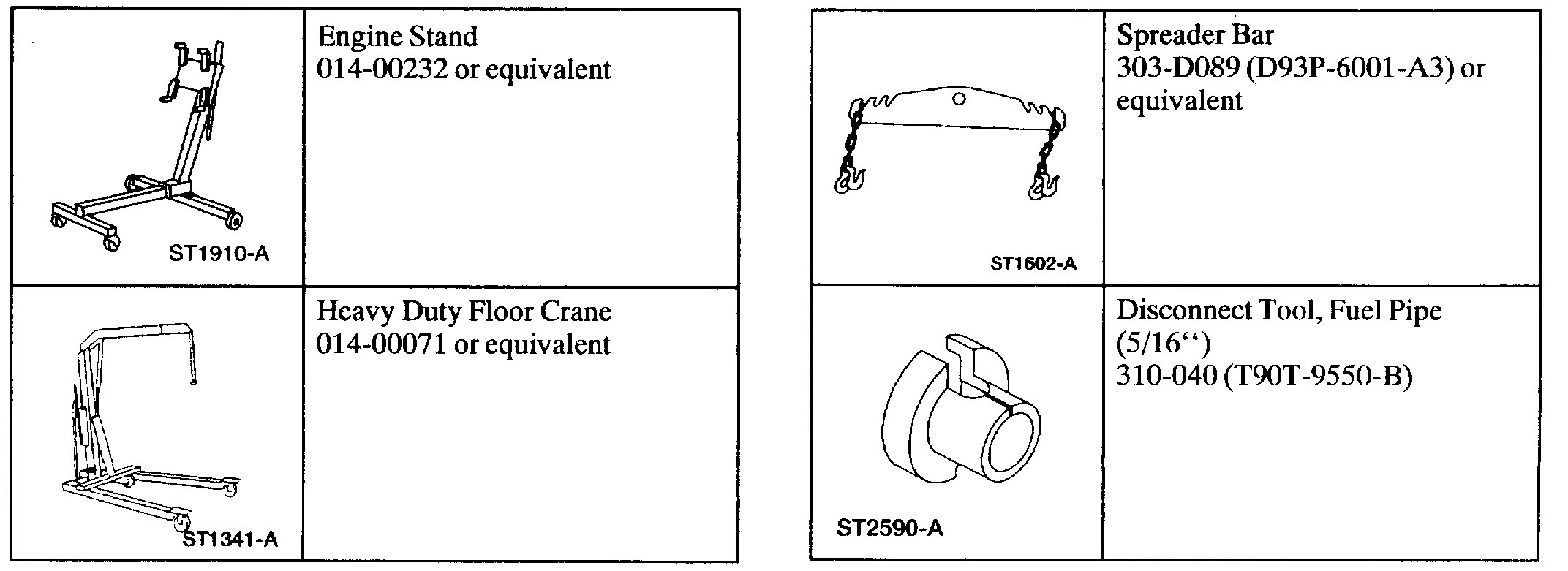

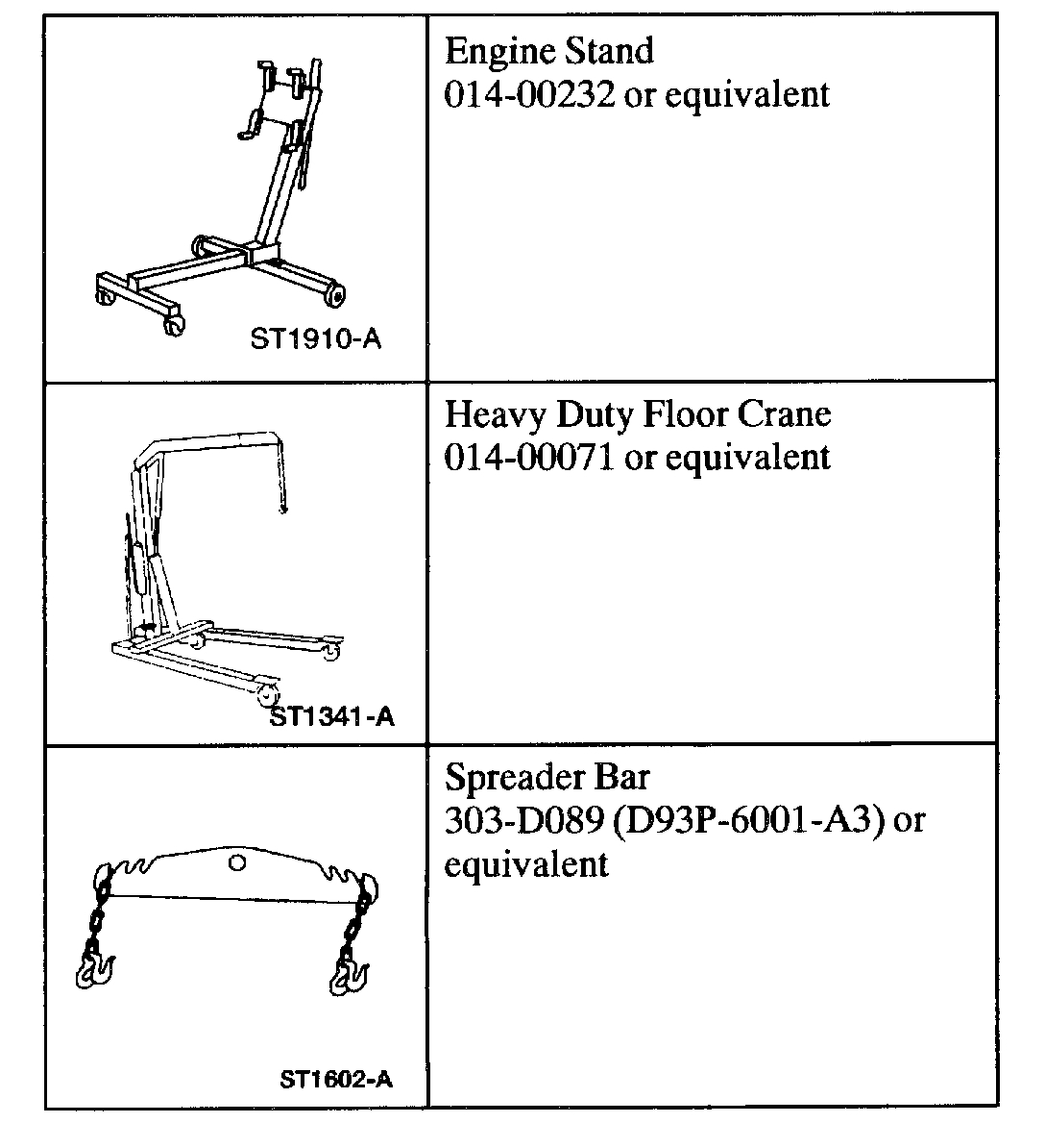

Special Tool(s)
1. Relieve the fuel pressure.
2. Disconnect the battery ground cable.
3. Recover the A/C system.
4. Drain the engine cooling system.
5. Drain the engine oil.

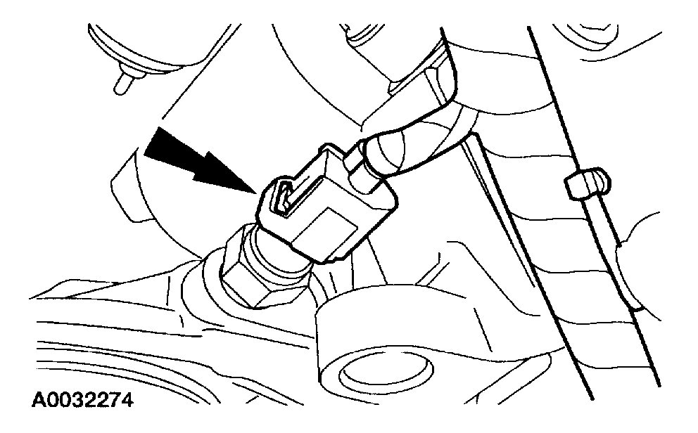

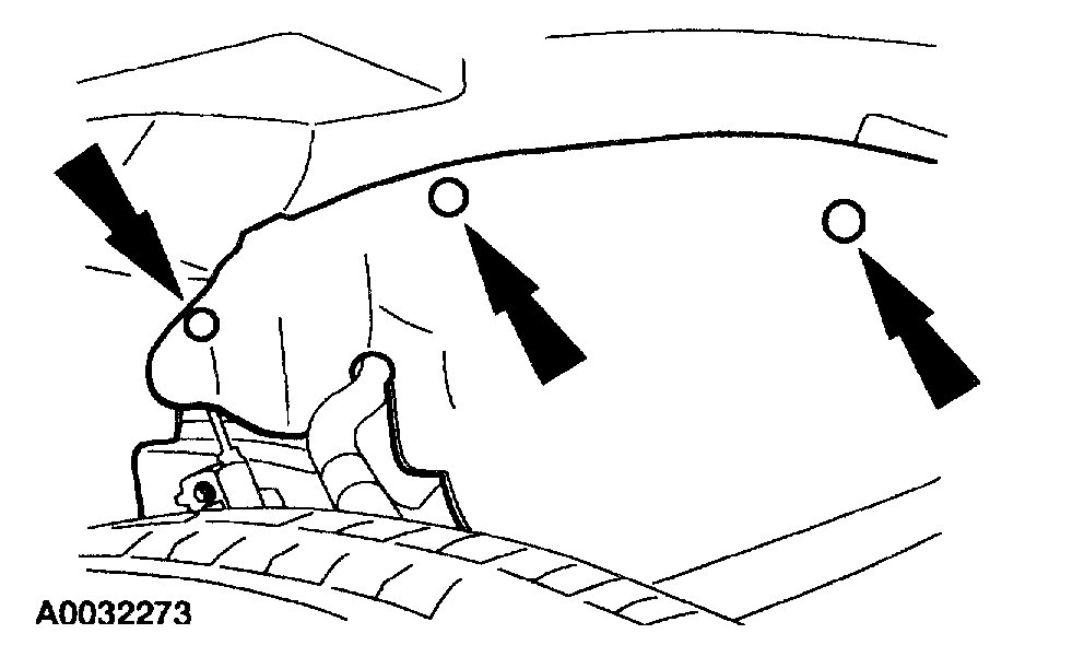

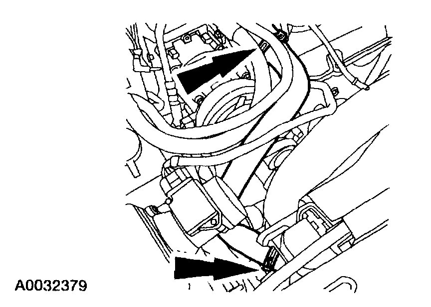

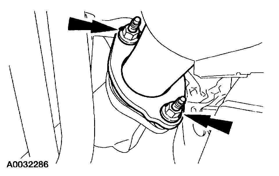

6. Remove the hood.

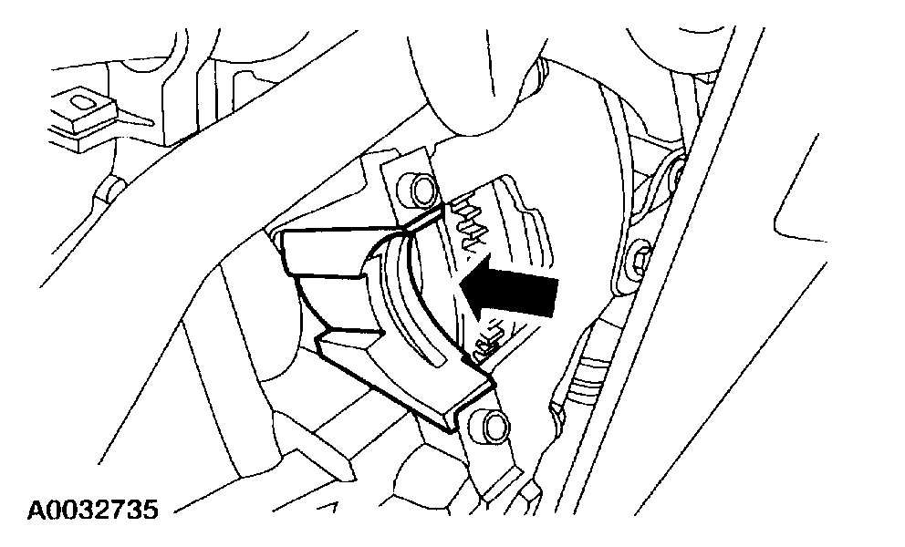

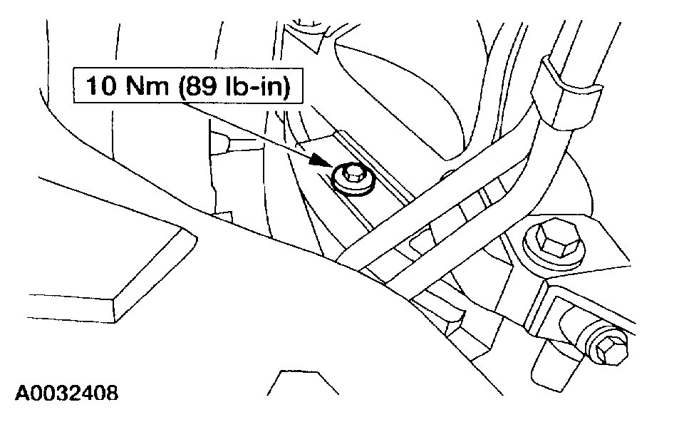

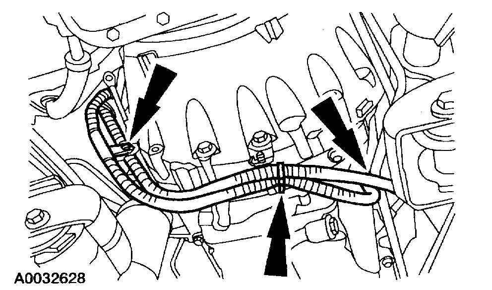

pic 2

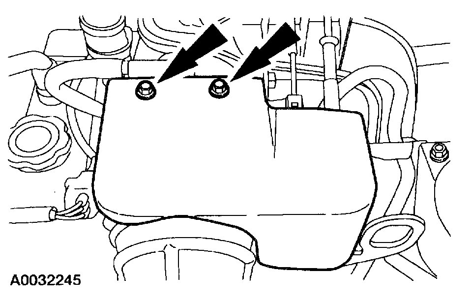

7. Remove the accelerator control snow shield.

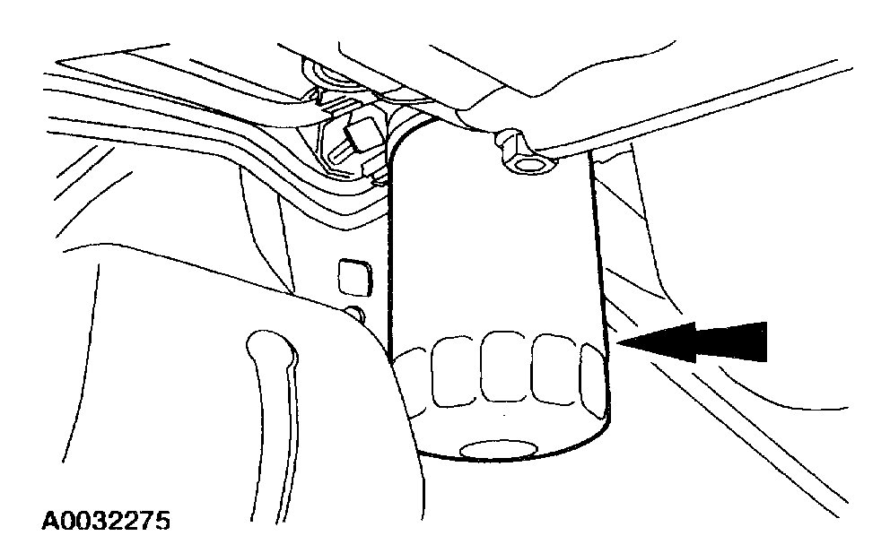

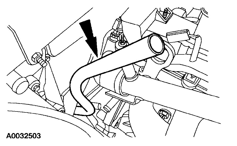

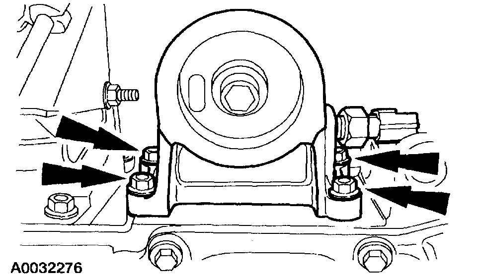

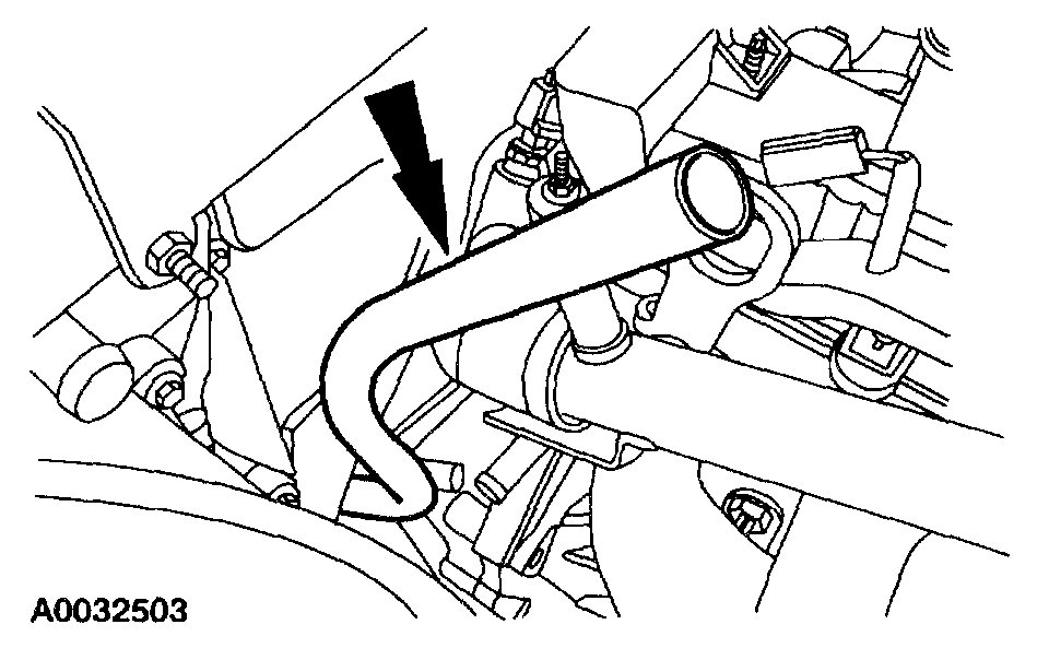

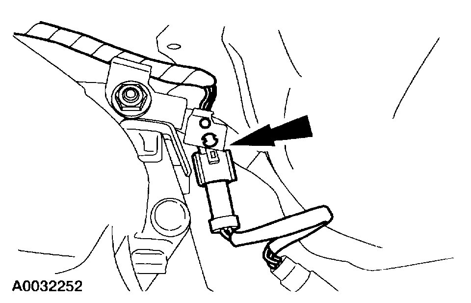

8. Remove the air cleaner tube.

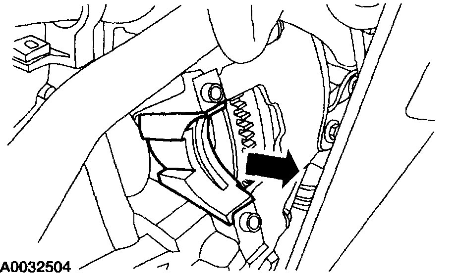

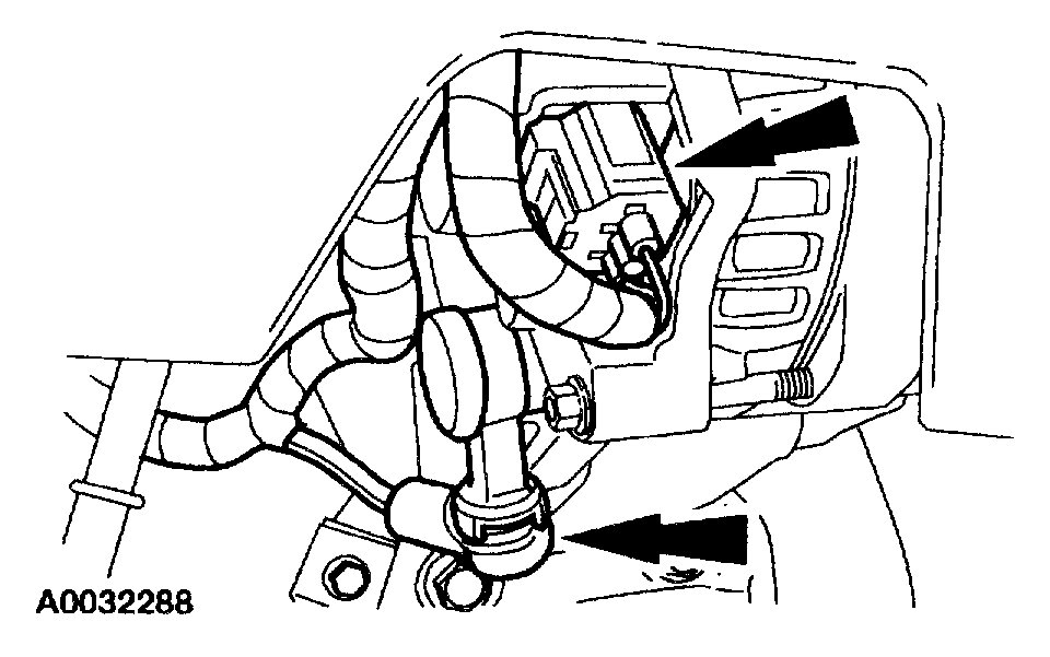

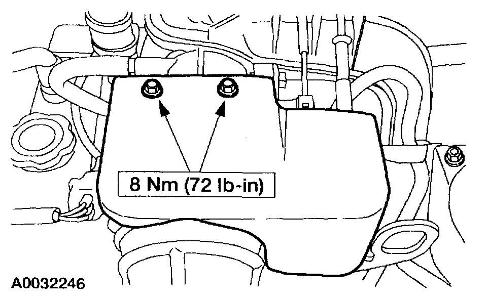

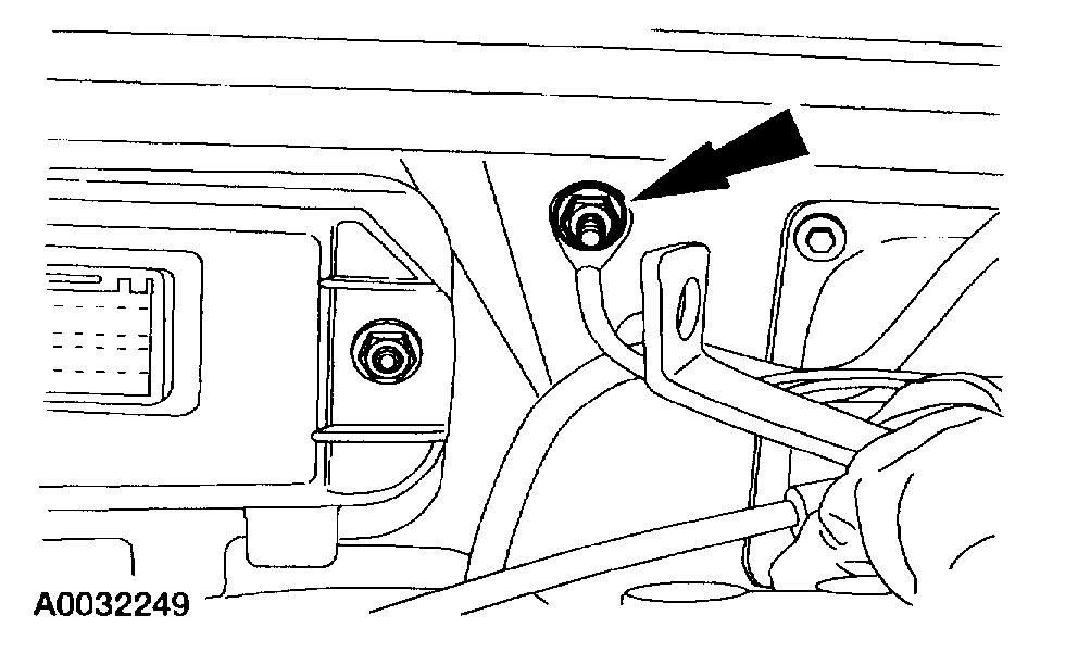

pic 3

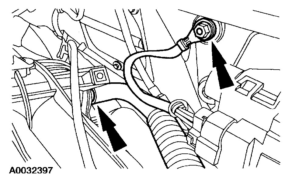

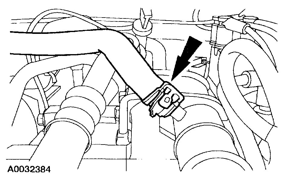

9. Remove the upper radiator hose.

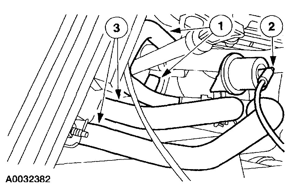

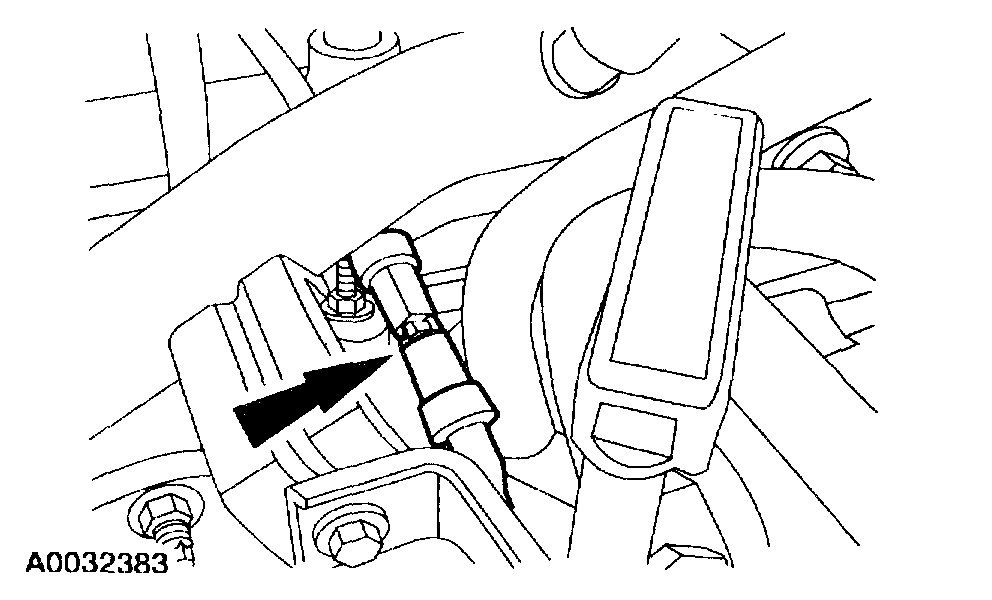

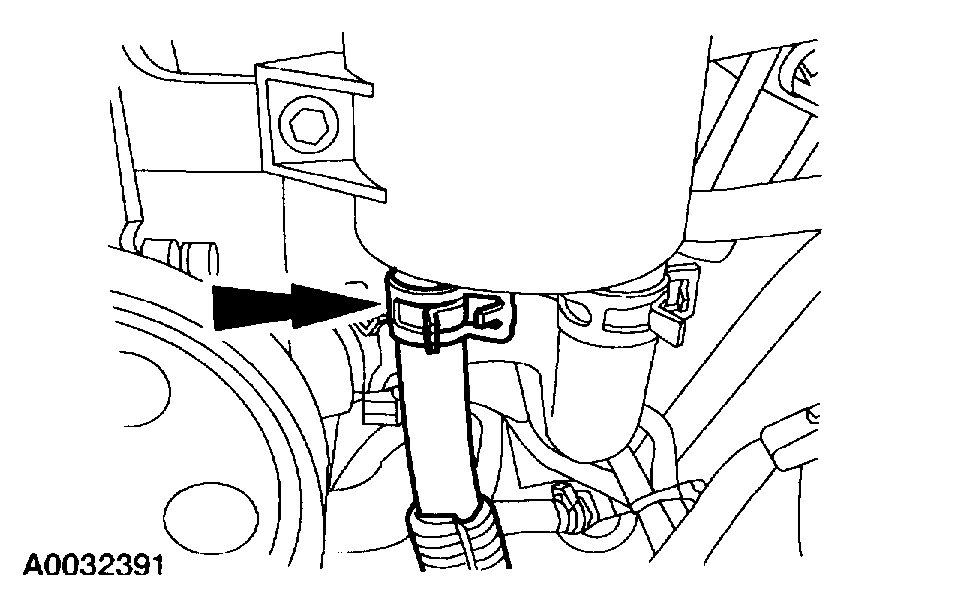

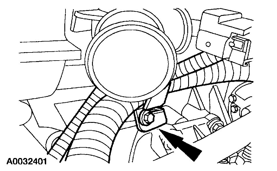

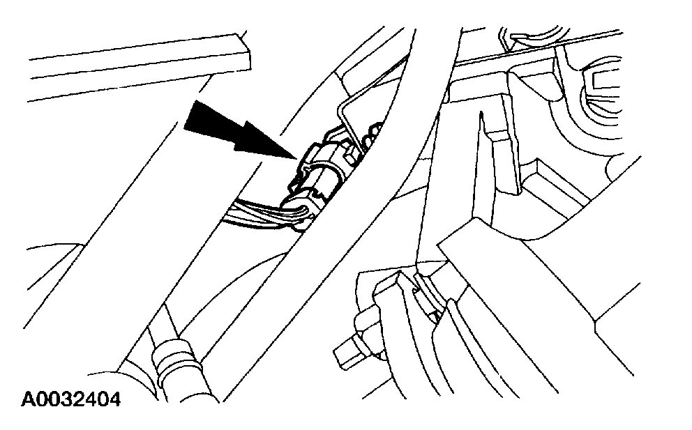

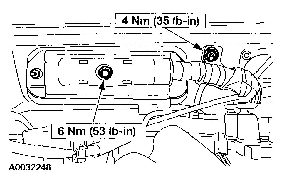

pic 4

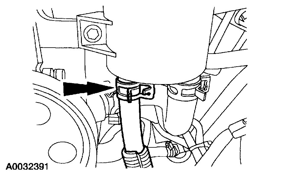

10. Remove the lower radiator hose.

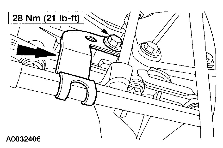

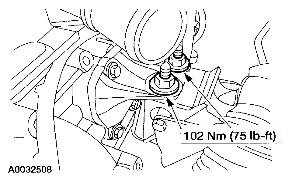

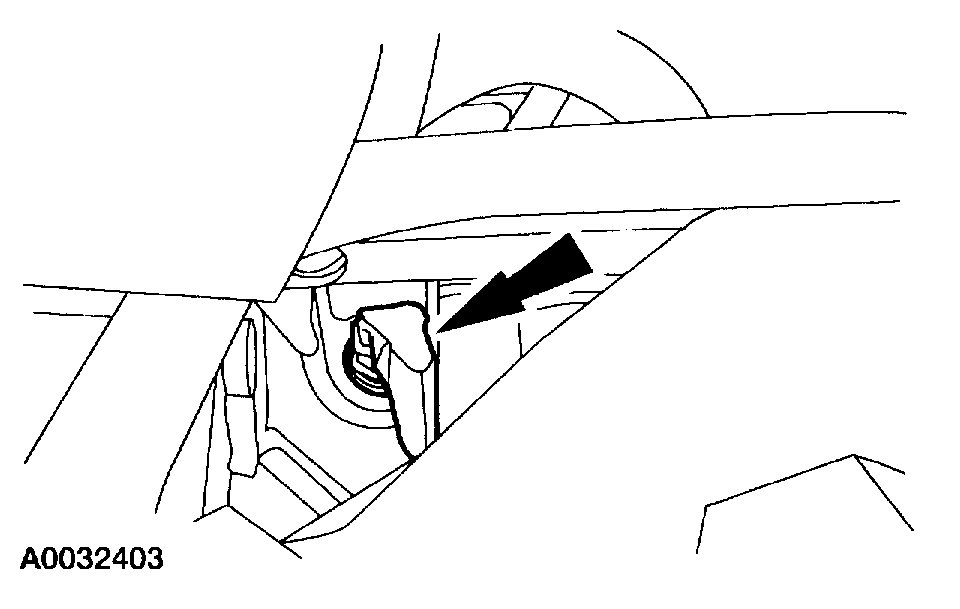

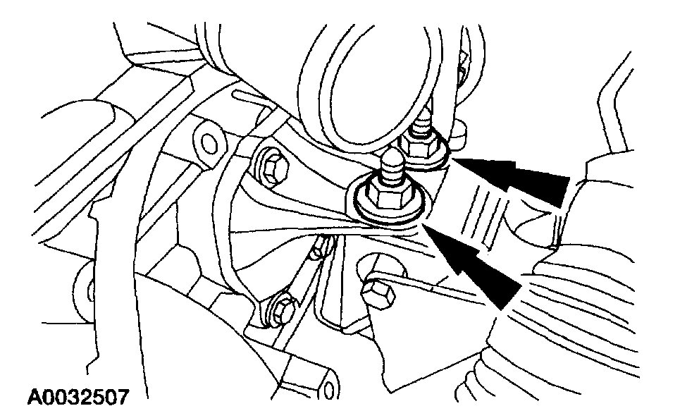

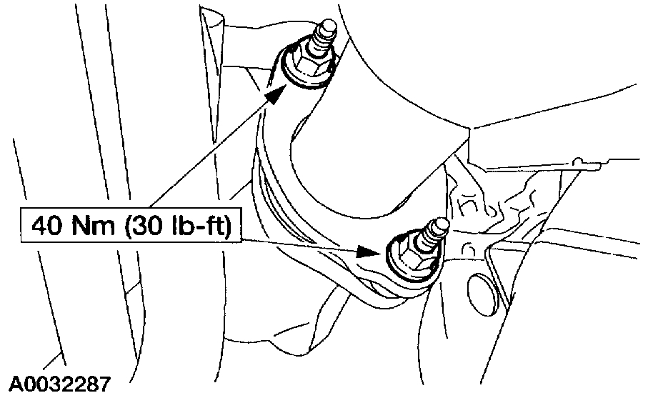

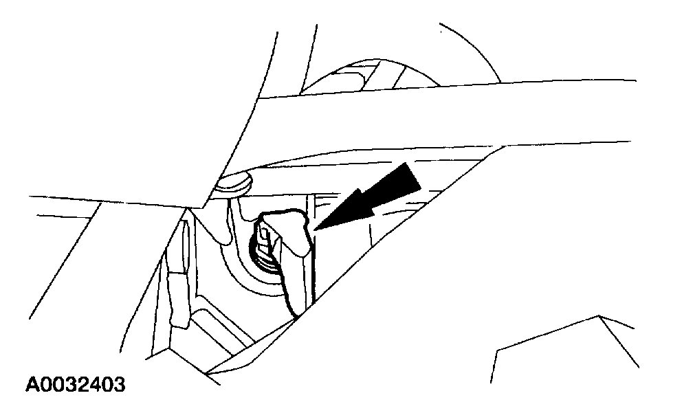

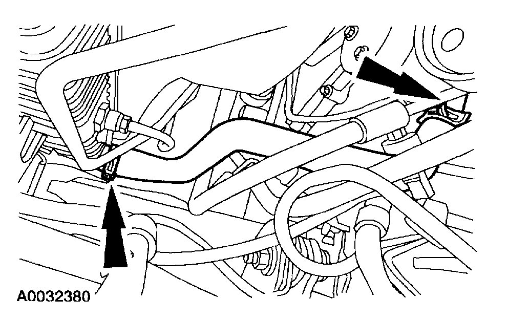

11. Remove the fan and shroud.

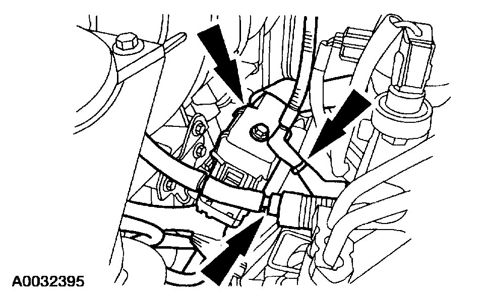

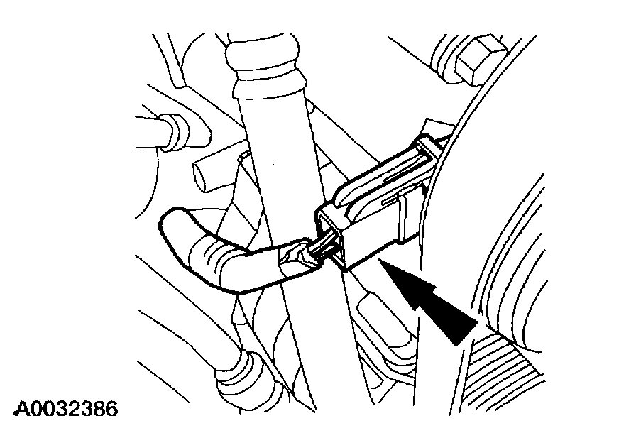

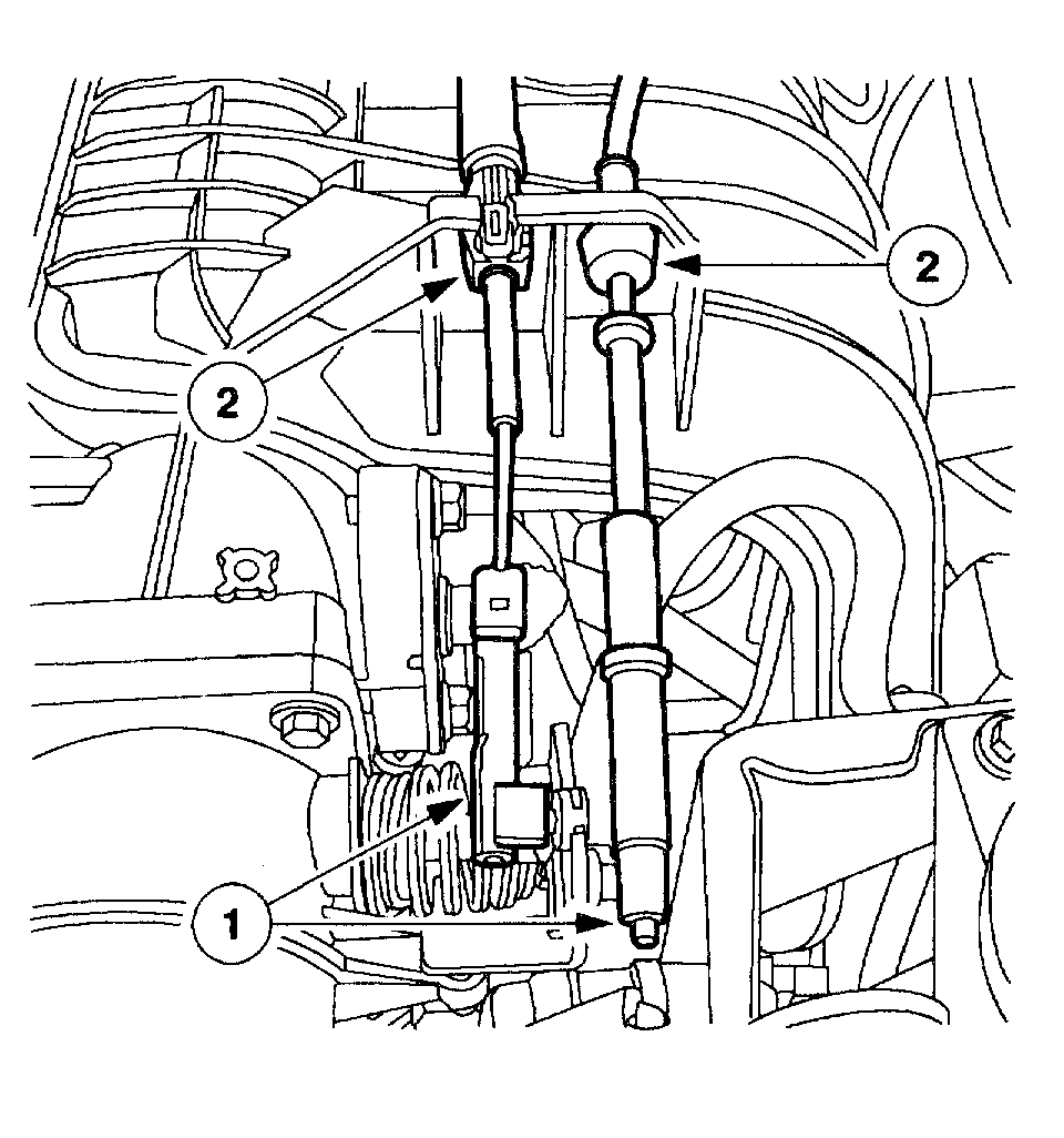

pic 5

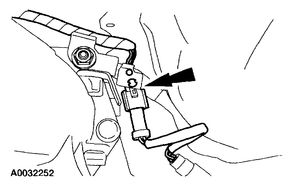

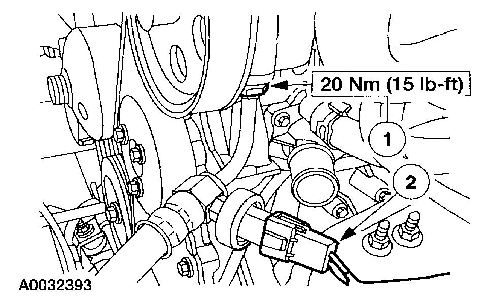

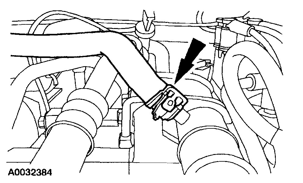

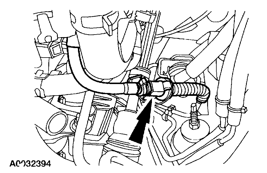

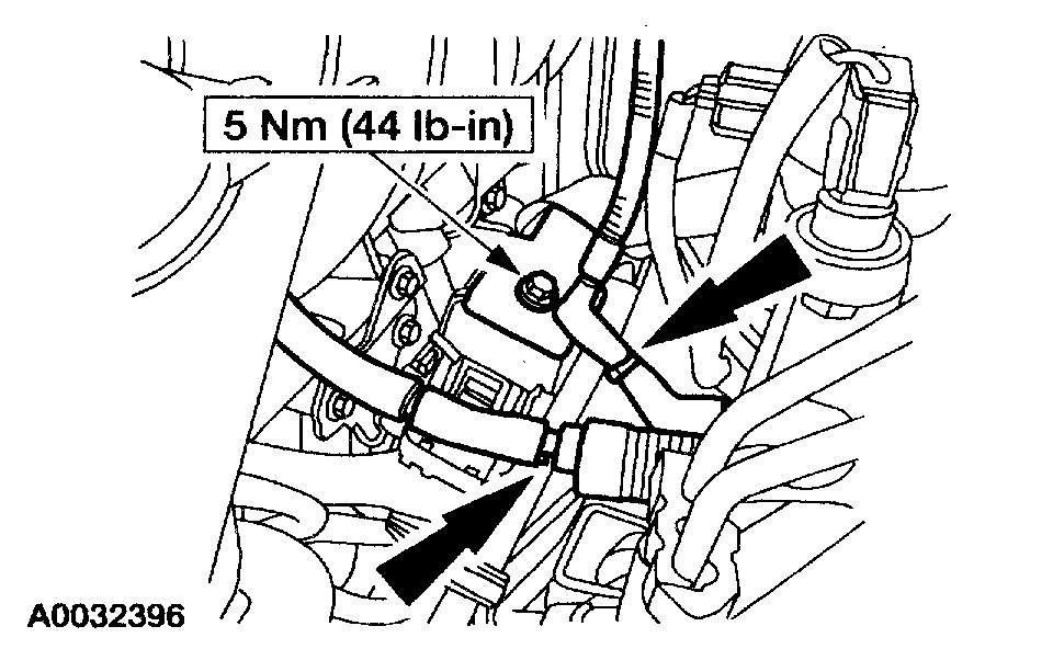

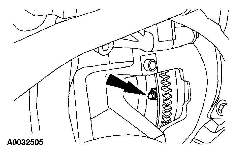

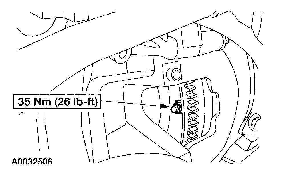

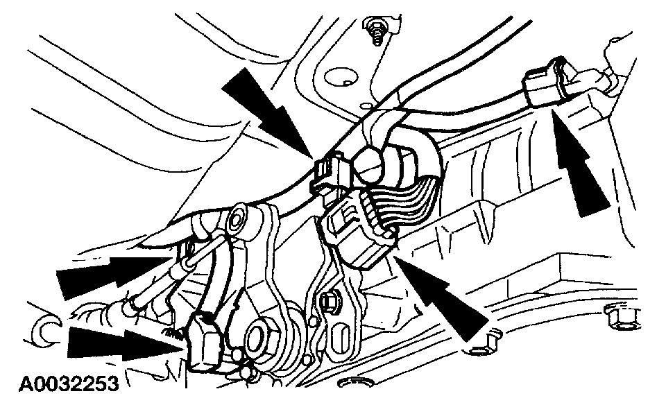

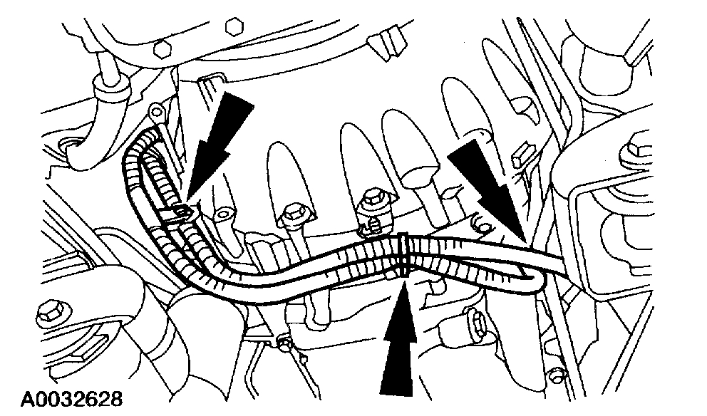

12. Disconnect the Powertrain Control Module (PCM) electrical connector. Remove the retaining nut on the harness clamp. Position the harness on the engine.

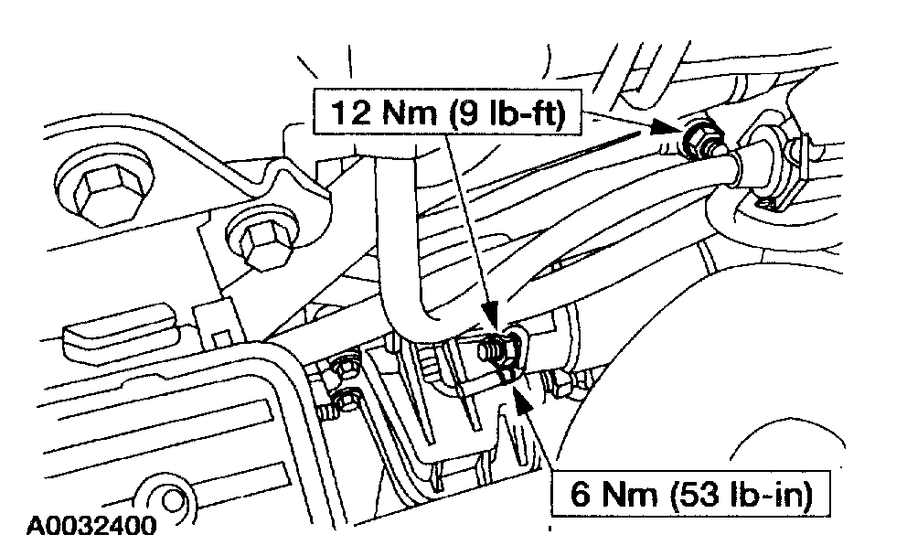

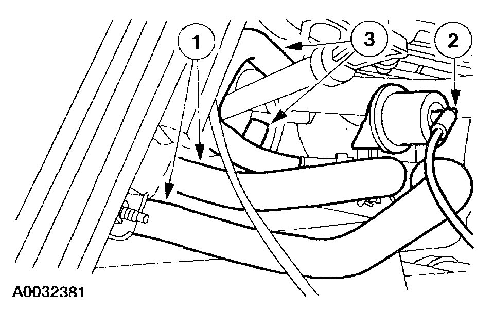

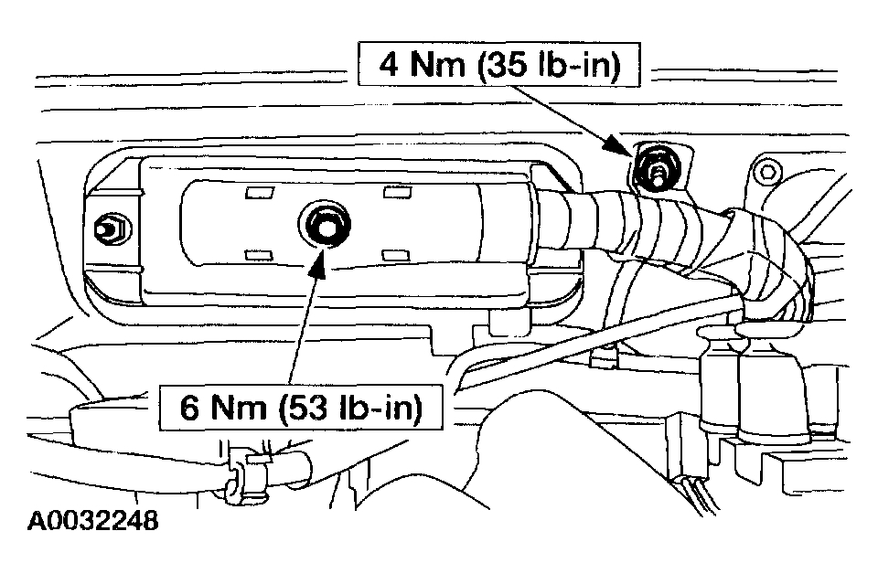

pic 6

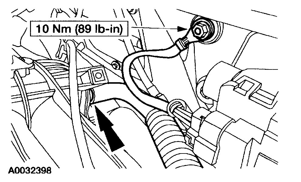

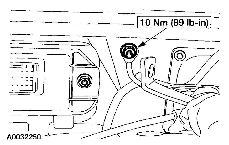

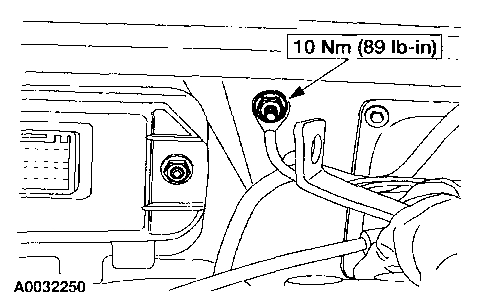

13. Remove the ground stud for the PCM.
pic 7

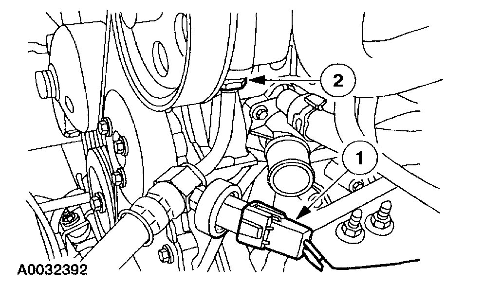

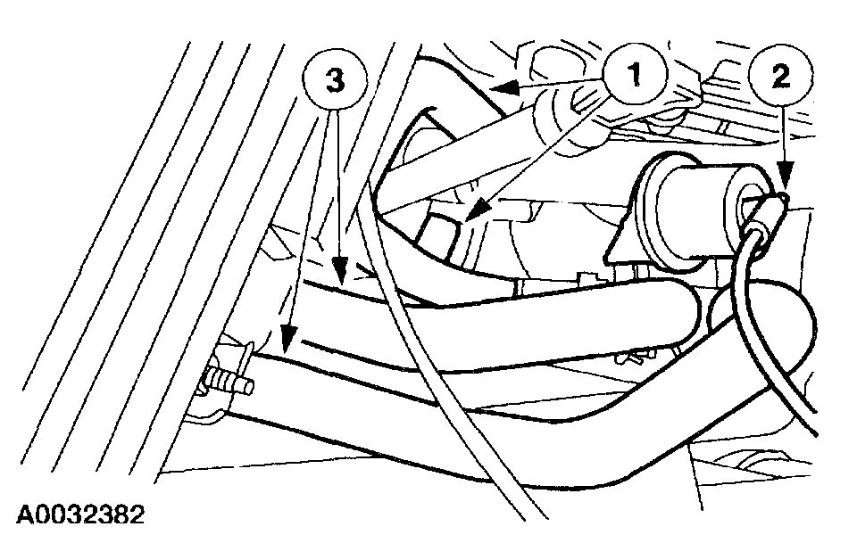

14. Remove the heater hose assembly.
1. Disconnect the heater water hoses at the bulkhead.
2. Disconnect the vacuum hose.
3. Disconnect the heater water hoses at the engine and remove the assembly.
pic 8

16. Disconnect the engine-to-coolant reservoir bypass hose.
pic 10
17. Disconnect the coolant reservoir-to-engine supply hose.
pic 11

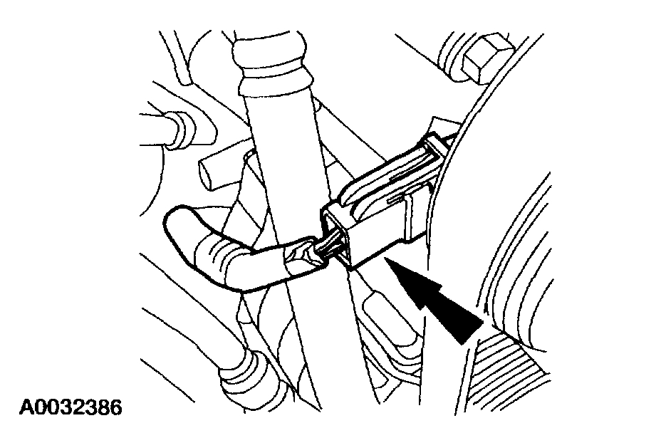

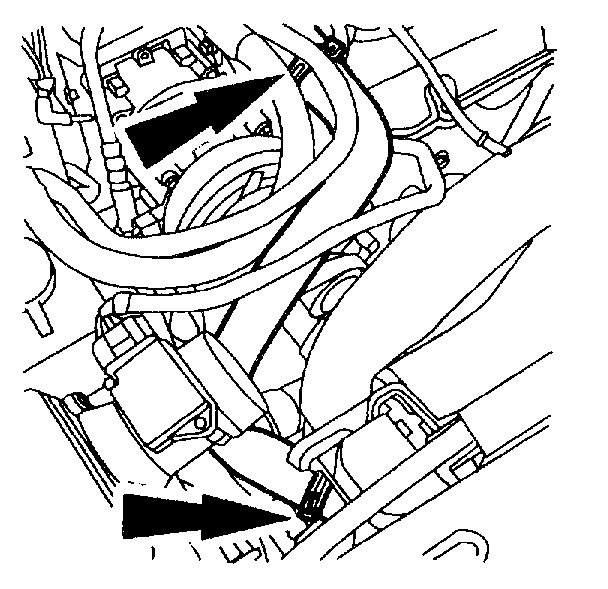

18. Disconnect the A/C compressor clutch.

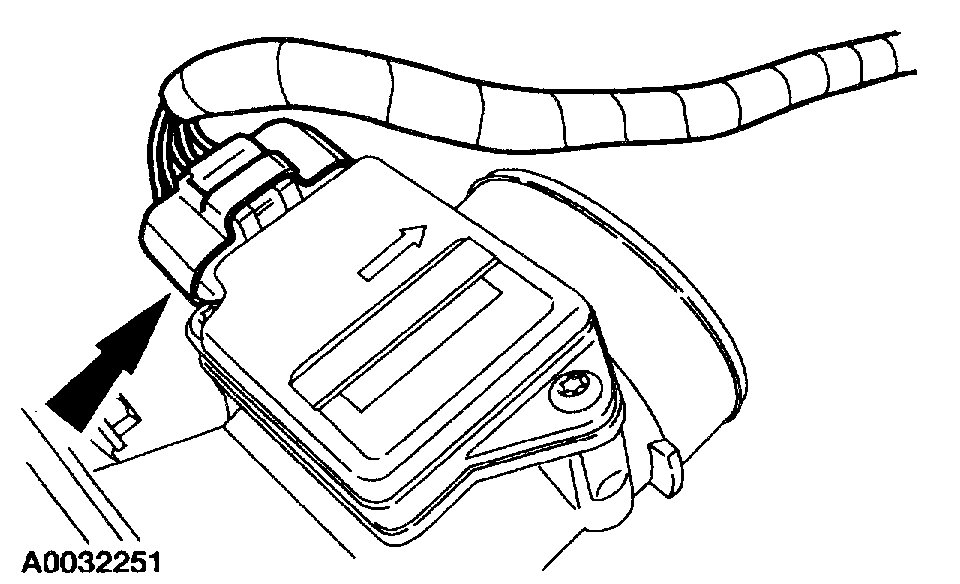

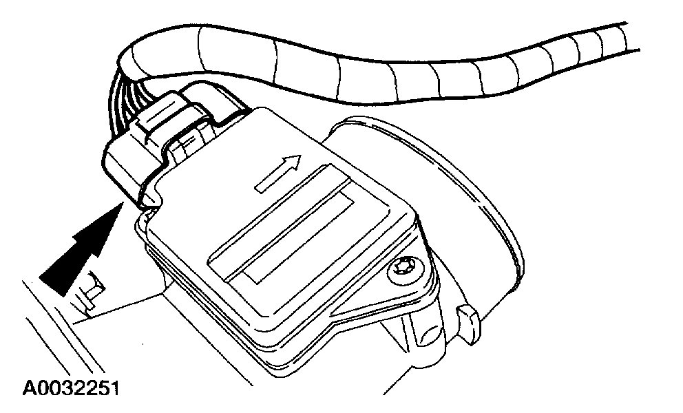

19. Disconnect the Mass Airflow Sensor (MAF) electrical connector.
pic 13

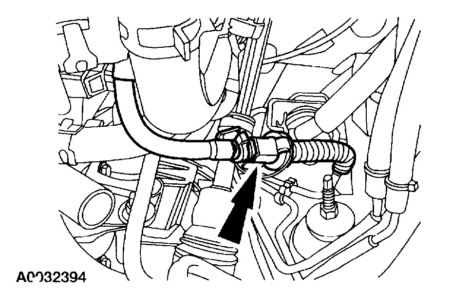

20. Disconnect the A/C compressor manifold, plug the lines and the compressor ports.
pic 14

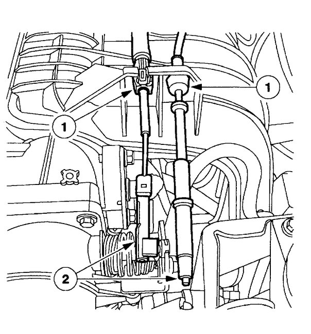

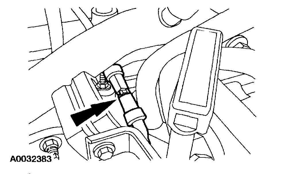

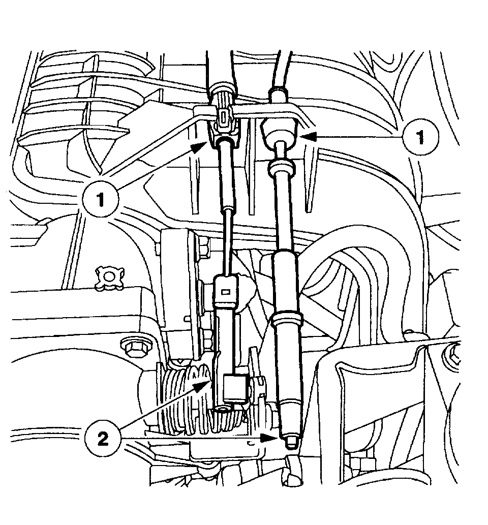

21. Position the accelerator and speed control cables aside.
1. Disconnect the accelerator cable and speed control cable (if so equipped) from the throttle linkage.
2. Disconnect the accelerator cable and speed control cable (if so equipped) from the mounting bracket and position out of the way.
pic 15

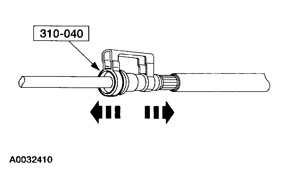

24. Remove the fuel line clip and using the special tool, disconnect the fuel supply hose.

25. Disconnect the following:
^ 42-pin electrical connector.
^ VMV vacuum regulator solenoid supply hose.
^ Evaporative purge hose.
pic 19

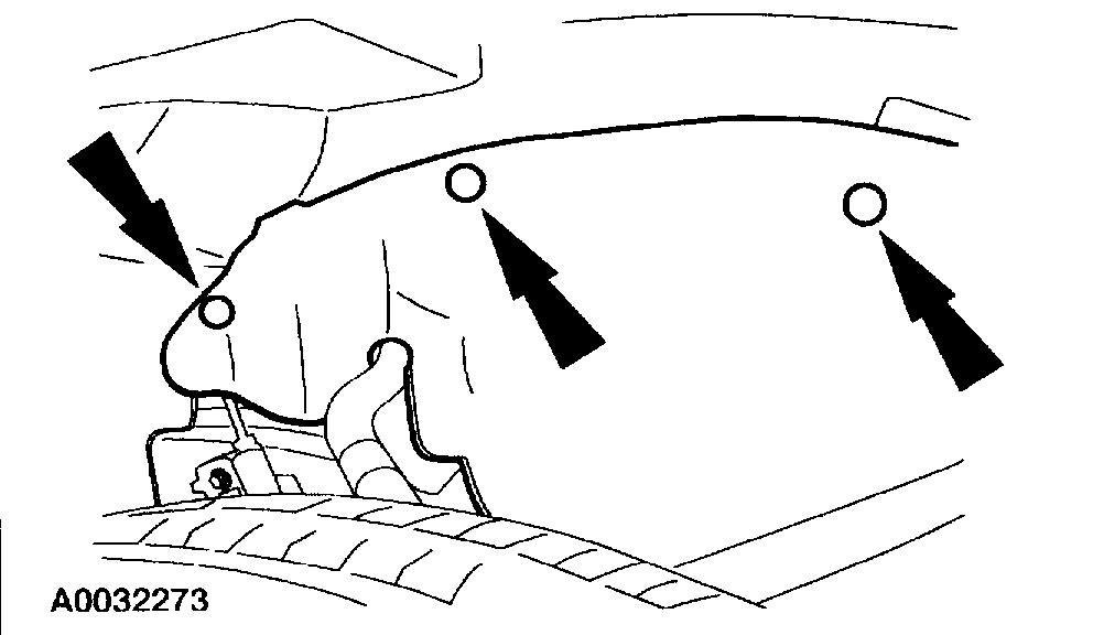

30. Position the RH splash shield out of the way.

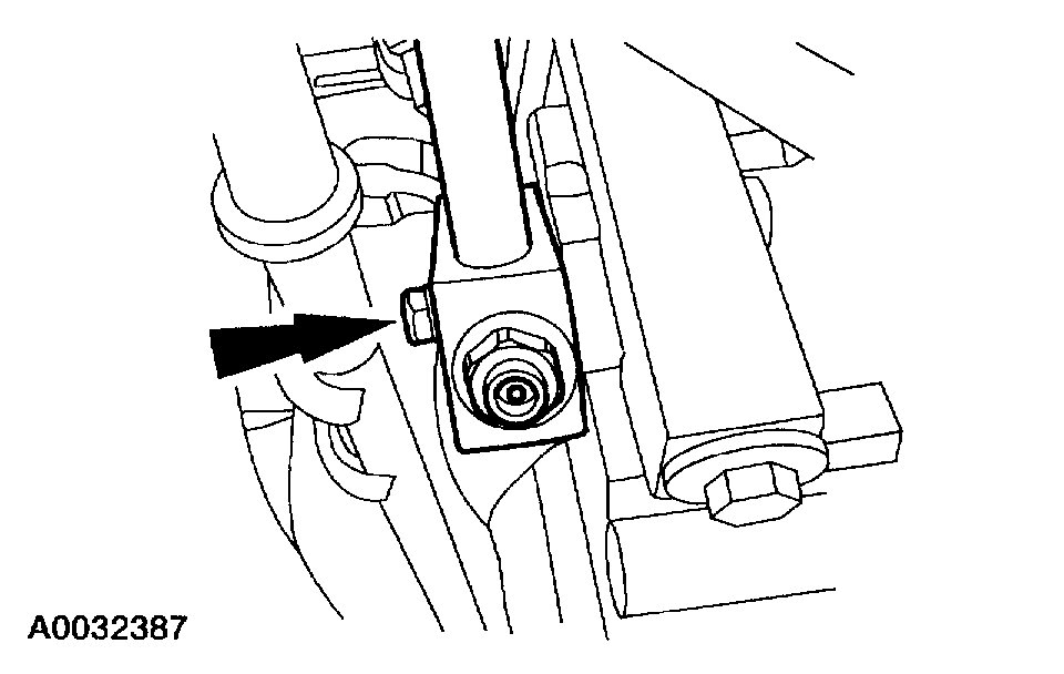

32. Disconnect the block heater electrical connector.

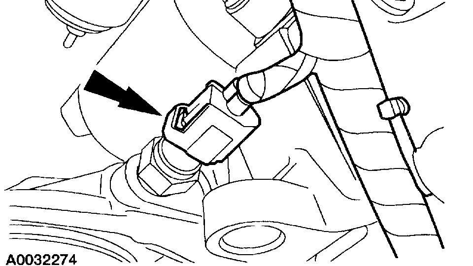

34. Disconnect the oil pressure sensor electrical connector

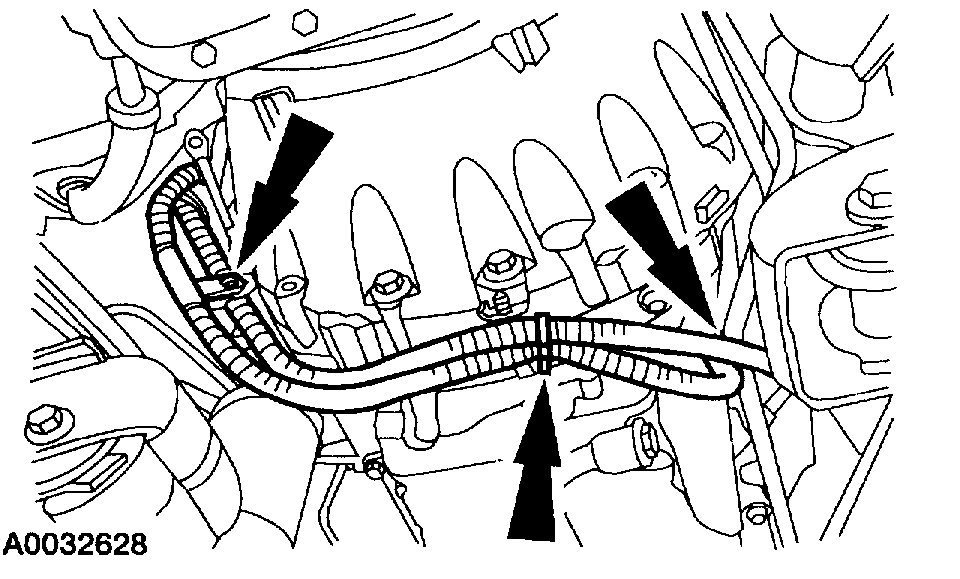

35. Disconnect the engine wiring pushpins and position the engine wiring harnesses out of the way.
pic 28

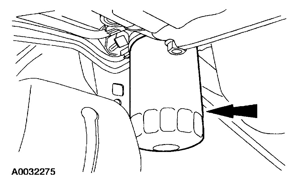

36. Remove the engine oil filter.
pic 29
37. If the vehicle is equipped with an automatic transmission, remove the bolt retaining the transmission cooling tubes to the engine. Remove the bracket.
pic 30

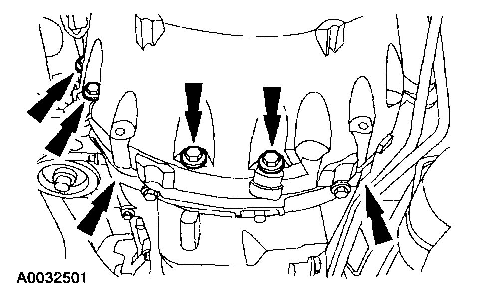

44. NOTE: Leave two side bolts in until the engine is ready to be removed.
pic 35
Remove nine of the transmission-to-engine bolts.

49. Support the transmission with a floor jack.
50. Support the engine with the Floor Crane using the Spreader Bar.

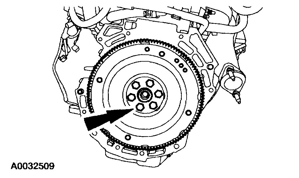

pic 40
55. Remove the flywheel.
56. Mount the engine on a suitable work stand.

Special Tool(s)
1. Using the Spreader Bar and the Floor Crane, remove the engine from the stand.

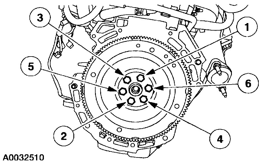

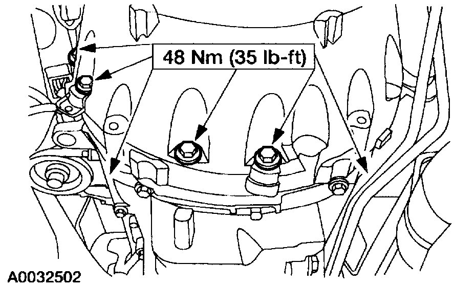

2. Install the flywheel and the bolts. Tighten the bolts in the sequence shown in three stages.
^ Stage 1: Tighten the bolts to 50 Nm (37 ft. lbs.).
^ Stage 2: Tighten the bolts to 80 Nm (59 ft. lbs.).
^ Stage 3: Tighten the bolts to 112 Nm (83 ft. lbs.).

33. Connect the fuel supply hose and install the clip.

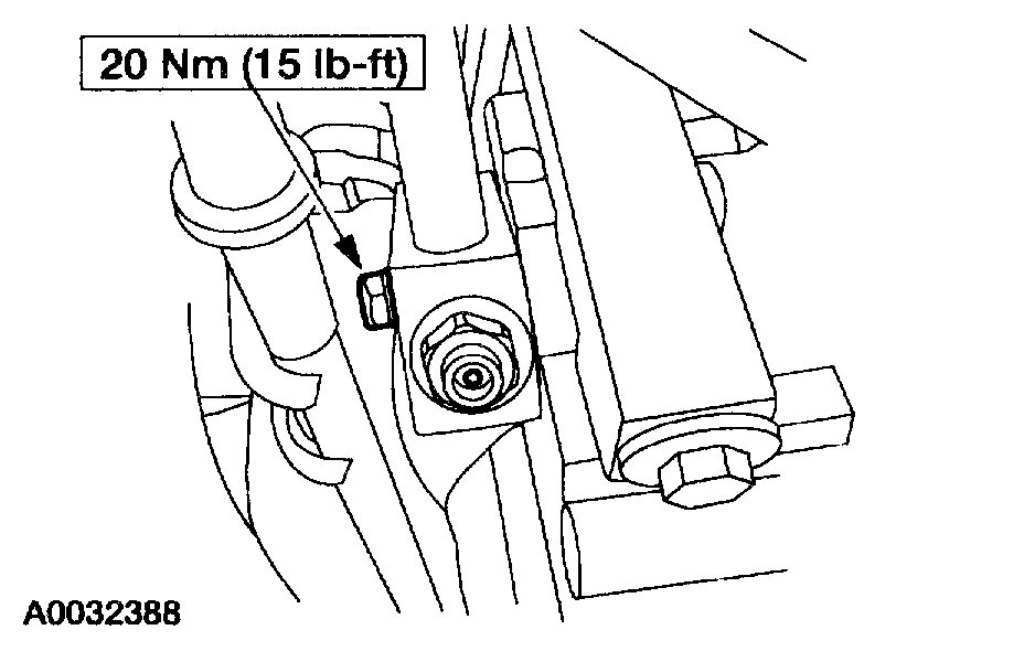

34. NOTE: Install a new nylon O-ring.
pic 66
Connect the power steering high pressure hose and the power steering pressure switch electrical connector.

37. Remove the plugs and connect the A/C compressor manifold.
pic 70
38. Connect the MAF sensor electrical connector.
pic 71

45. Position the PCM harness. Install the retaining nut on the harness clamp. Connect the PCM connector.
46. Install the fan and shroud.

48. Install the upper radiator hose.
49. Install the air cleaner tube.

50. Install the accelerator control snow shield.
