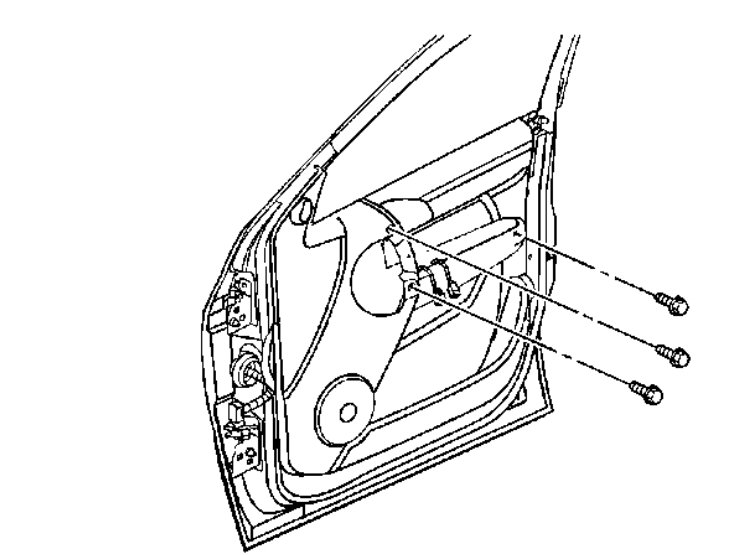

I will try to remove the door panel for removing the control window module, but I Do not have the instructions or procedure for remove the door panel.
Can somebody help me?

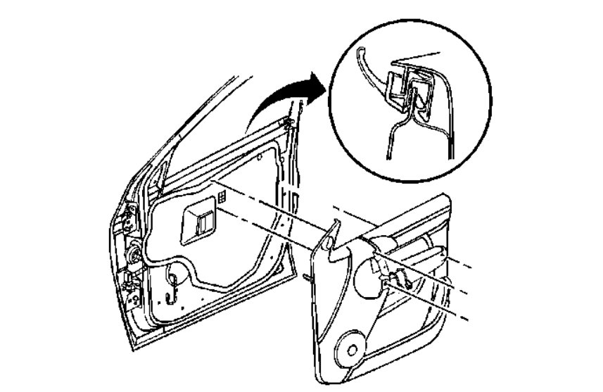

I attached a couple of pictures for you as well as the procedure.
When you release all the screws, the panel lifts up first then remove.
1. Open the door.
2. Remove the power window switch assembly. Refer to Power Window Switch Replacement.See: Power Window Switch > Removal and Replacement
3. Remove the screws from the front door trim panel
imageZoom/Print
4. Remove the front door trim panel using the J 38778 .
5. Remove the power mirror switch. Refer to Power Mirror Switch Replacement.
6. Reposition the electrical harness connectors.
7. Remove the front door trim panel from the vehicle.
