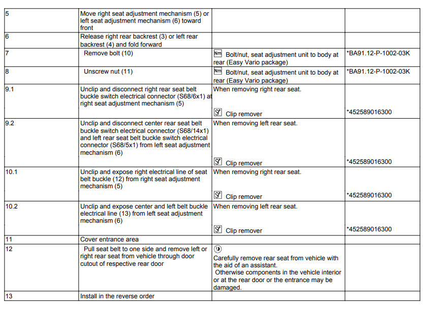

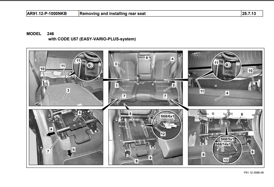

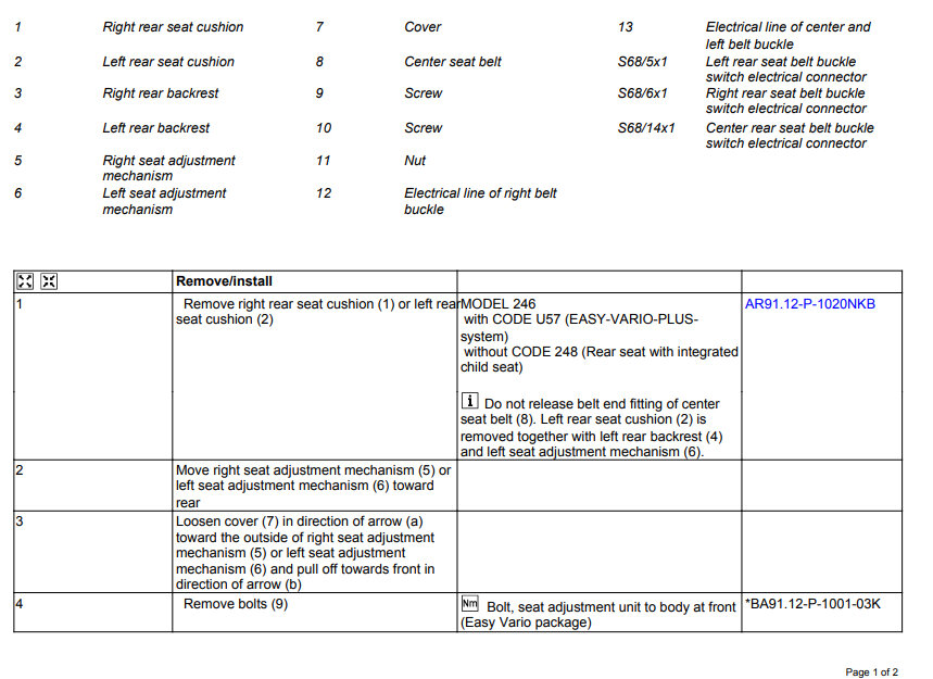

My child dropped something down the gap of the seatbelt holder, and it has disappeared under the seat. How can I remove the rear seat base to retrieve it?
Aug 15, 2023 at 10:47 PM
  • 55,402 POSTS

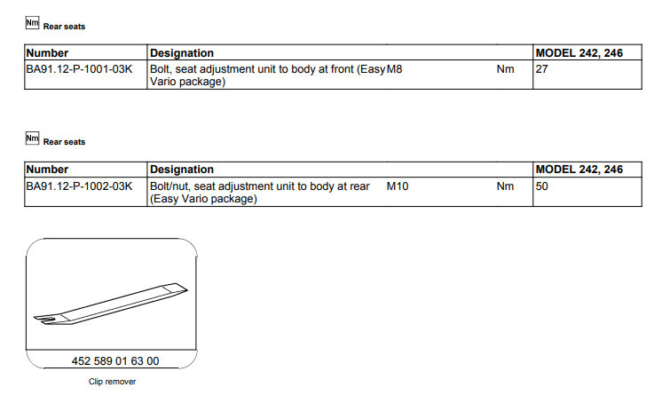

Yep, it happens, here are the instructions on howe to remove the rear seats. Check out the images (below). Please let us know if you need anything else to get the problem fixed.
Aug 16, 2023 at 6:03 AM
