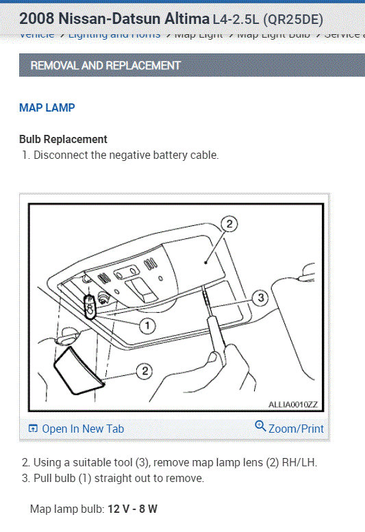

Are you only replacing the bulb? I ask because you can remove the lens cover to access the bulb.

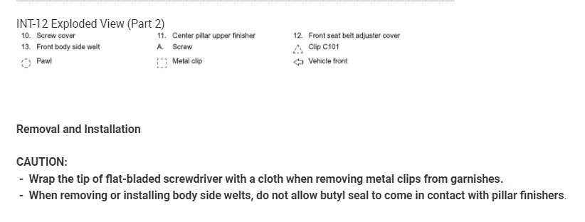

First, I attached the directions in the pic below. The lens is held in by plastic clips, so it's important to be careful when removing it. You will simply need to gently pry down on one side of the lens at a time. (See pic below)
See pic below.

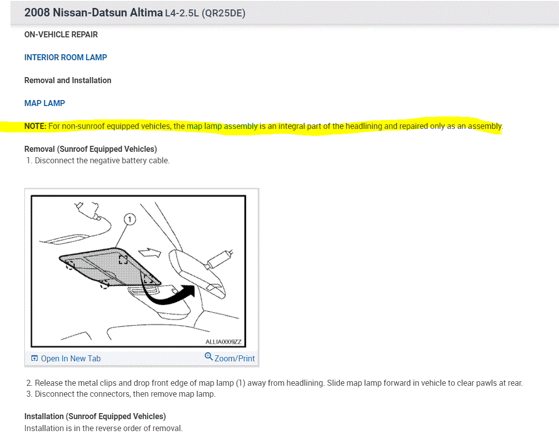

Thank you, Joe, for getting back to me so quickly. Much appreciated. No, I’m not changing lightbulbs. I’m getting ready to connect a Gntx homelink mirror to the 12-volt constant, 12-volt ignition, and ground that supplies the power to the overhead map lights. I looked at the videos on YouTube, and some of the guys were upset because they broke the support brackets when removing the assembly. I don’t want to make the same mistake.
Nov 30, 2021 at 5:17 AM
  • 110,194 POSTS
Okay, you need to remove the assembly to access the power supply. I attached those directions below. Here is the issue: If the vehicle has a sunroof, you can remove the assembly. However, if there is no sunroof, the assembly is an integral part of the headliner and can only be removed as an assembly.
Take a look at the directions and let me know if that helps.
See pic below.

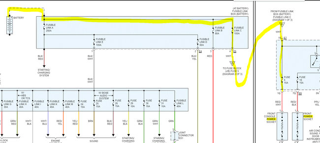

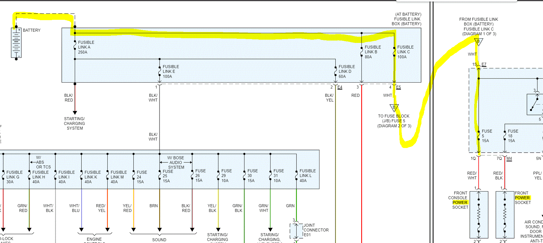

Hi Joe. Well, I was successful taking down the assembly but when I connected my multimeter to the three wires connected to the map light assembly two wires were continuous voltage and one was ground. Couldn’t find any ignition 12 volt anywhere up there so I will have to run it to the fuse box. Plan on running it to the cigarette lighter which I believe is 20 amps. I will combine the continuous wire and the ignition wire from the HomeLink together, but I don’t know what size amp I need to add to the fuse tap. I was thinking 15 amps, but I wanted to check with you first. Thanks, Jim.
Dec 5, 2021 at 10:22 AM
  • 110,194 POSTS
If you are referring to the power outlet port, it appears to have power at all times as well. See pic below.
As far as the recommended amperage needed, is there anything indicated in the manual? I'm not sure how much power one draws.
Dec 5, 2021 at 3:52 PM

The car has no manual nor does the mirror but I I’ve seen a couple of videos that show a 10-amp fuse for a power mirror. I’ll keep looking.
Dec 5, 2021 at 8:44 PM
FORT BIGELOW
  • 11 POSTS
Joe thanks for your help. Just for future reference the guy who sold be the wire harness said the mirror draws one amp when the buttons are pressed. He said a two-amp fuse would be fine.
Dec 6, 2021 at 11:03 AM
  • 110,194 POSTS
Thanks for the update. Certainly, a 2 amp sounds like the ticket. If possible, let me know when you get it working.

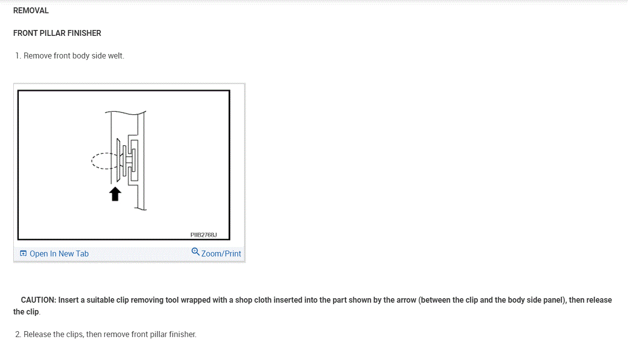

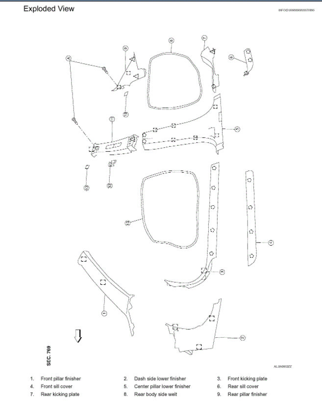

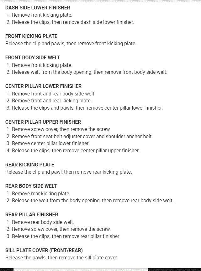

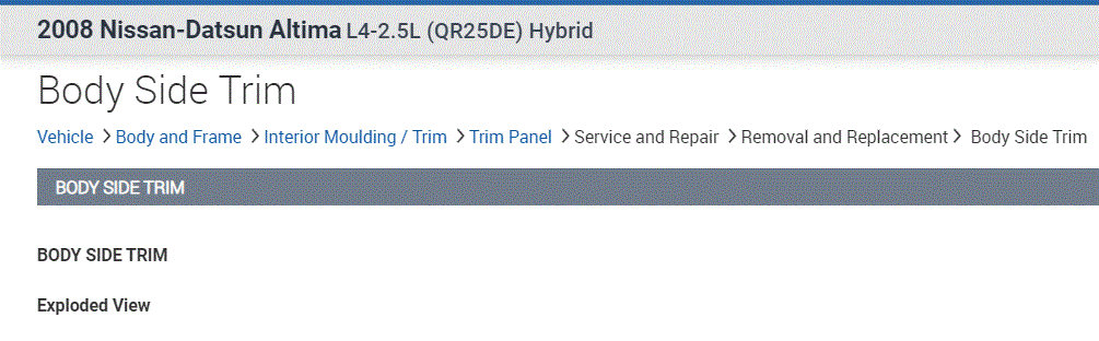

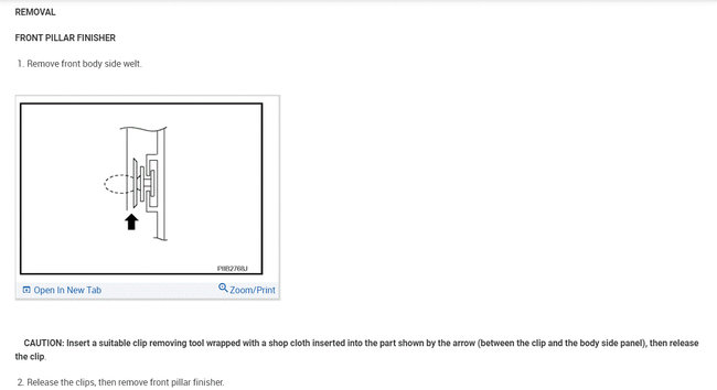

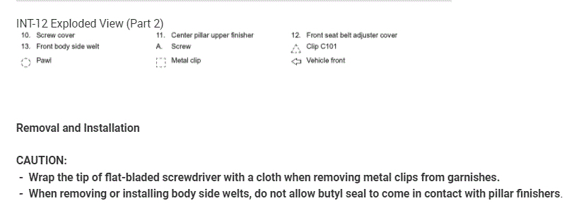

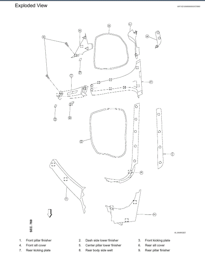

Hi Joe. When you have a moment, please send me a picture or something on removing the driver's side pillar trim on a 2008 Nissan Altima.
Thank you,
Jim
Dec 8, 2021 at 11:13 AM
  • 110,194 POSTS
I attached what I have below. They are somewhat vague, but if I recall, everything is primarily held in with plastic clips.
Let me know if this helps or if I can help.
Dec 8, 2021 at 8:20 PM
