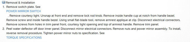

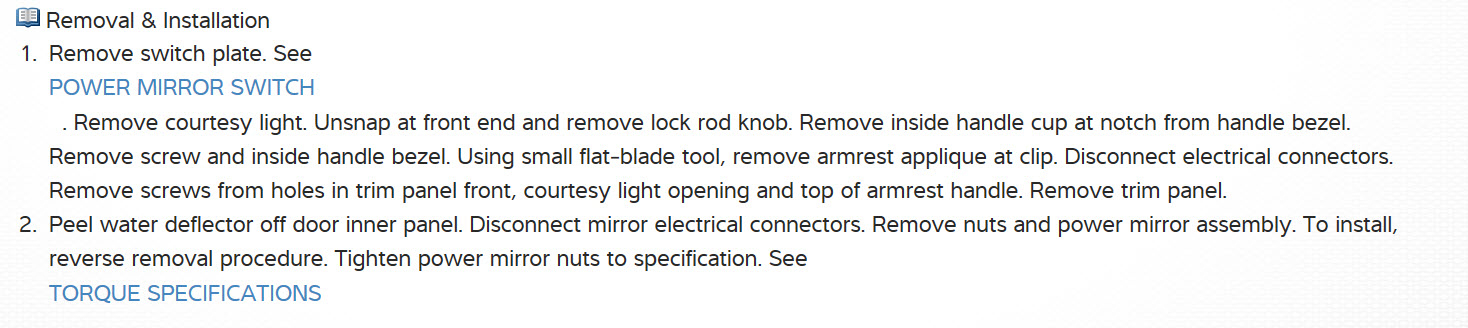

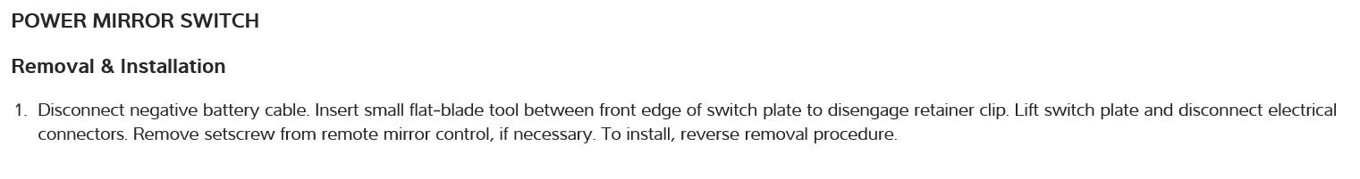

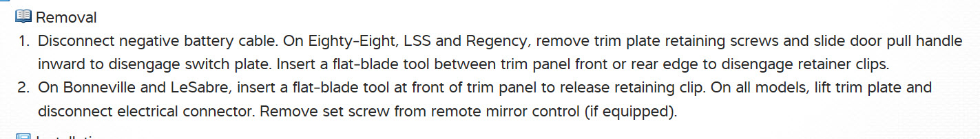

Replace outside mirror on the car listed above.
Wednesday, April 26th, 2017 AT 6:35 PM
HMAC300
MECHANIC
48,601 POSTS
See pictures for instructions. There are no pictures for this.
