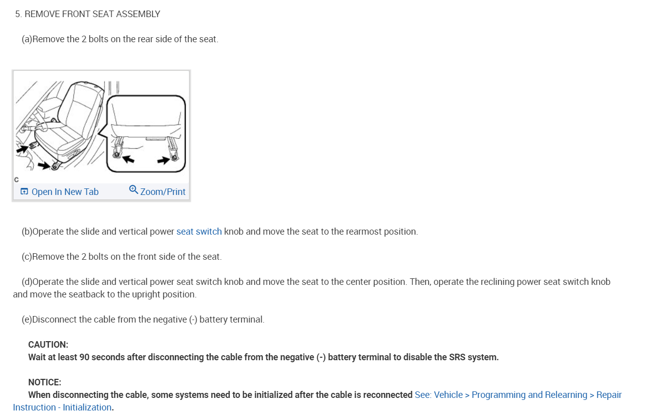

how do you remove the front power seat from a Camry SE? Having trouble locating the 4 bolts and I don't want to tear up the decorative plastic hiding the bolts. Then I would like to remove the hog rings that you sit on and put the seat back in. these horizontal rings hurt after a few minutes in the car. so I want to remove the horizontal wires and add a 1/2" thick cushion under the fabric.

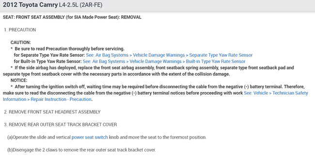

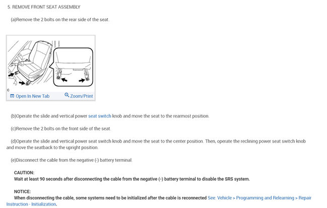

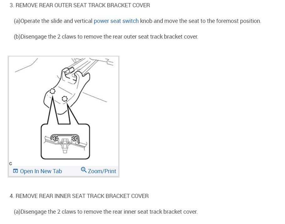

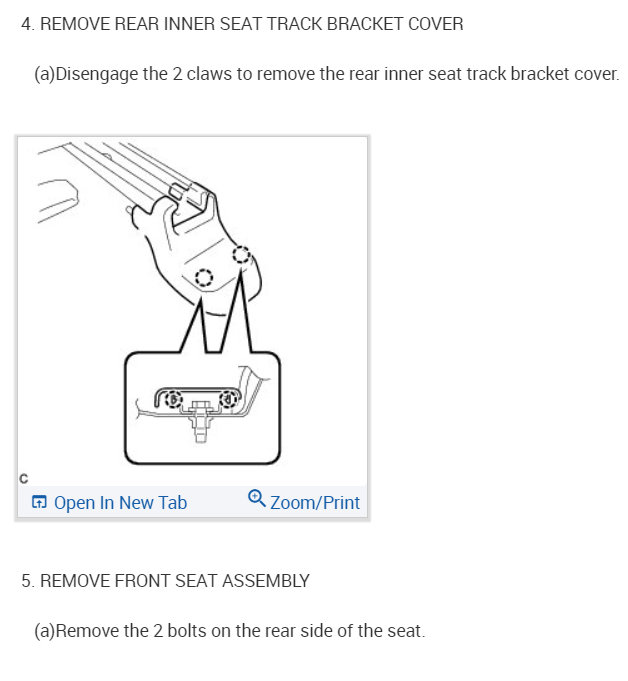

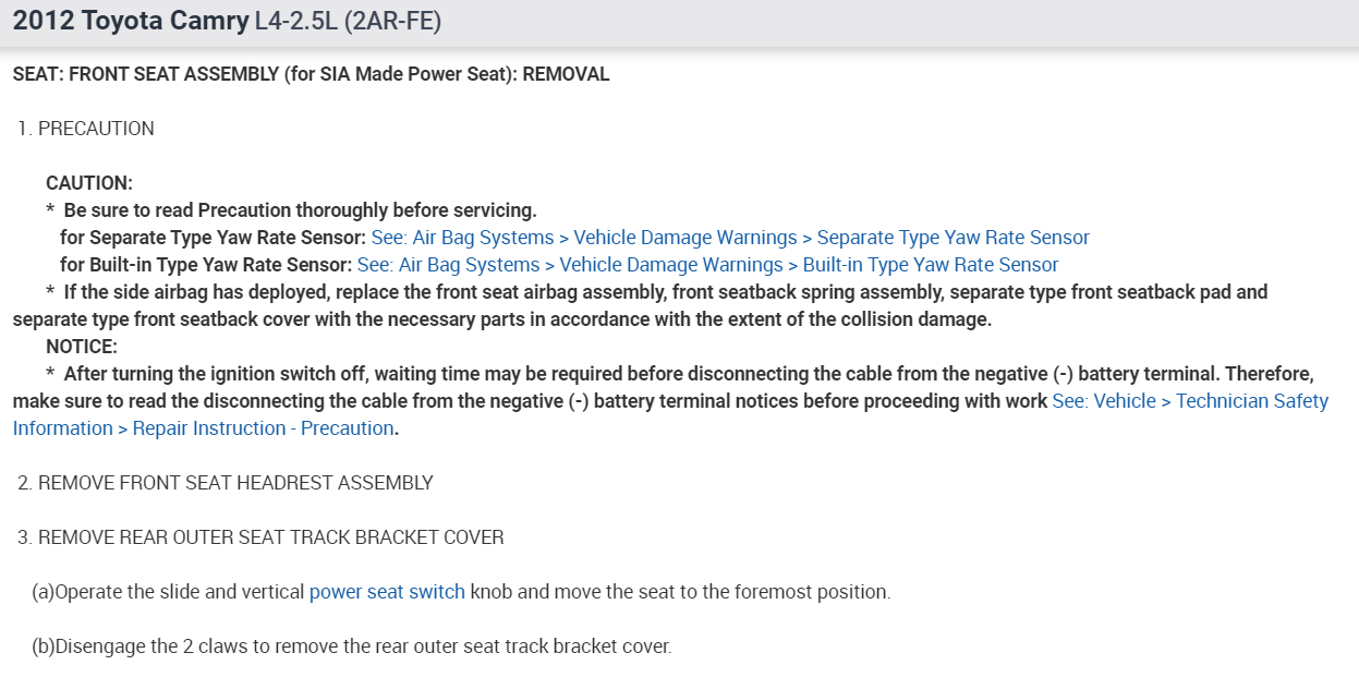

There are 8 bolts that hold the seat down under the plastic covers here are instructions to remove the seat in the diagrams below. Check out the diagrams (Below). Please let us know if you need anything else to get the problem fixed.

Under both side of the seats you would be able to find a lock, push the tabs and lift the seat. Pull the seat assy forward to get it off.
