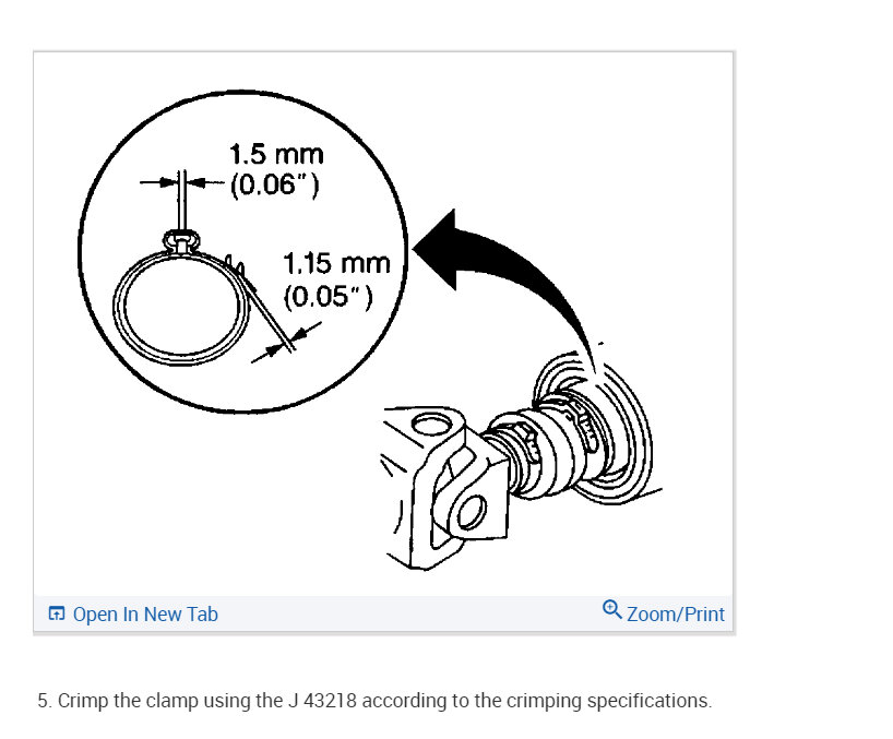

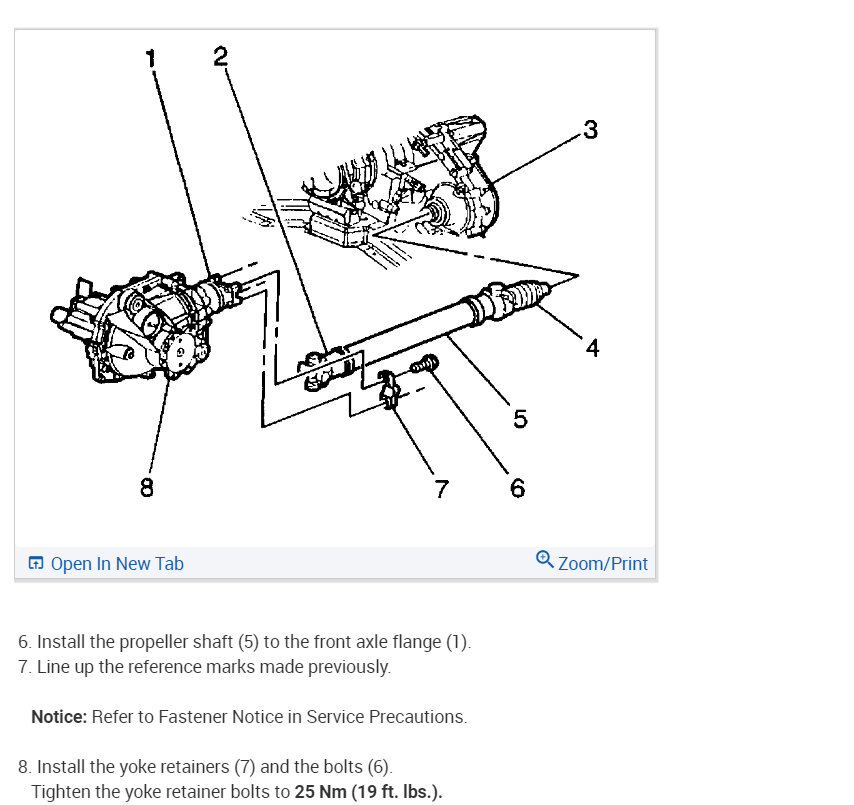

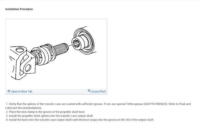

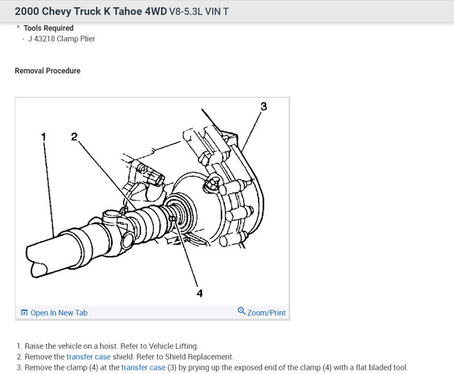

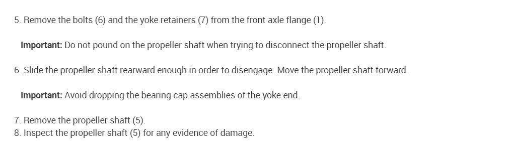

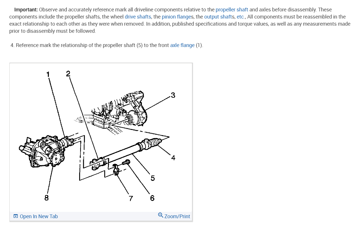

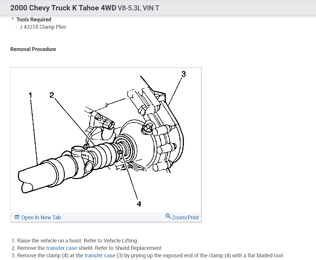

We only handle one question per thread, so I will included how to remove the front driveshaft. Please post your new question here, you must be logged in.
Check out the images (below). Please let us know if you need anything else to get the problem fixed.
