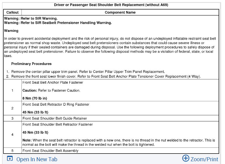

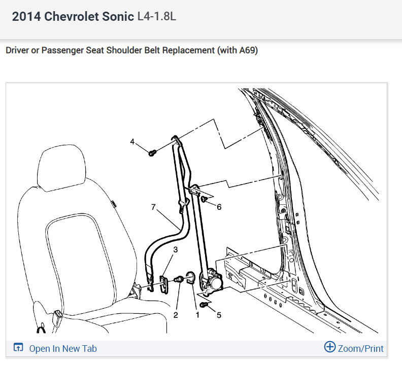

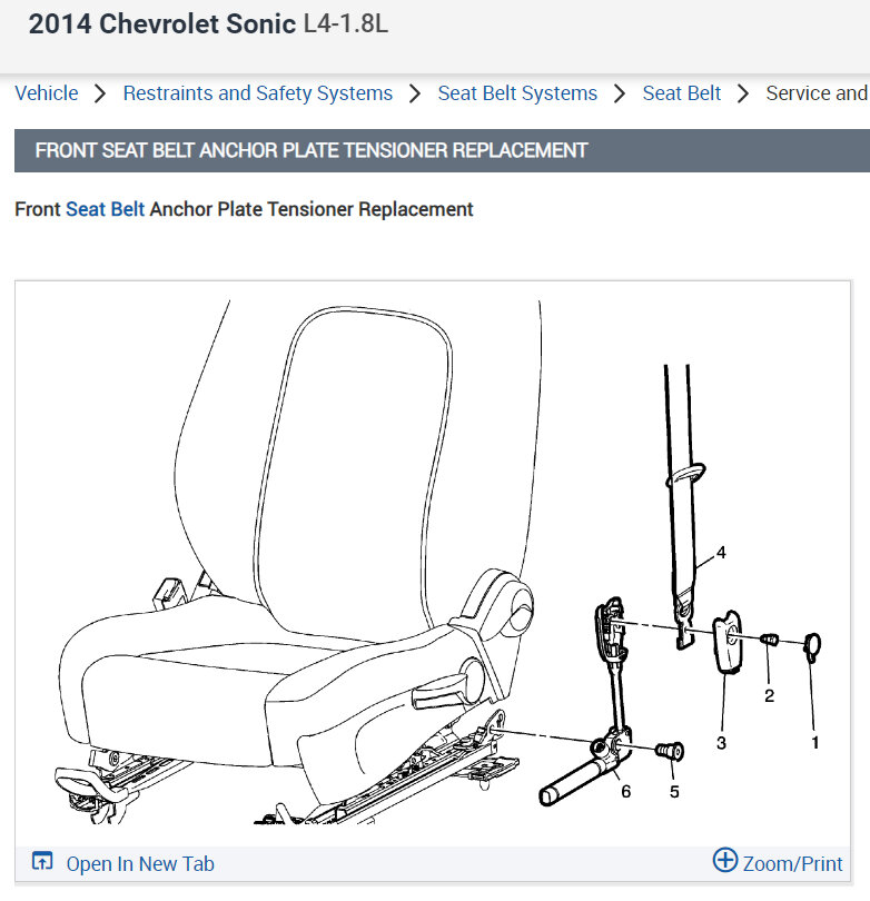

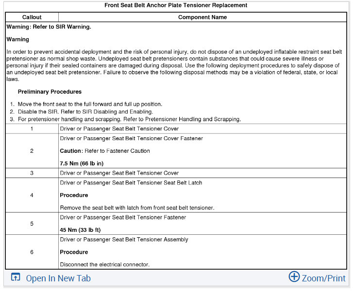

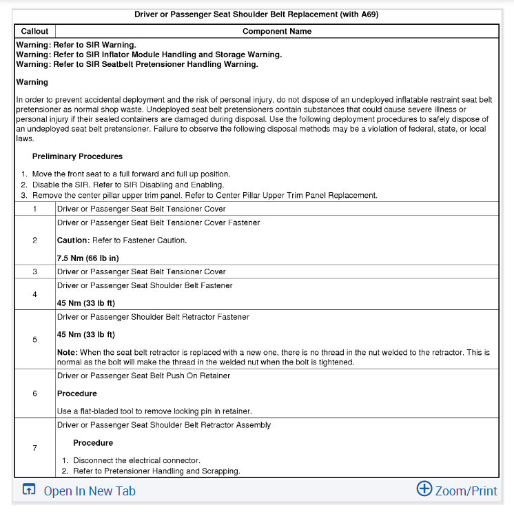

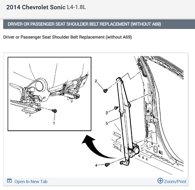

Can you send me the step-by-step instructions (with diagrams if possible) to remove the driver's side seat belt buckle for my vehicle listed above?

Sure, here is how to replace the seat belts for both options, I would disconnect the battery before beginning. Check out the images (below). Please let us know what happens.
