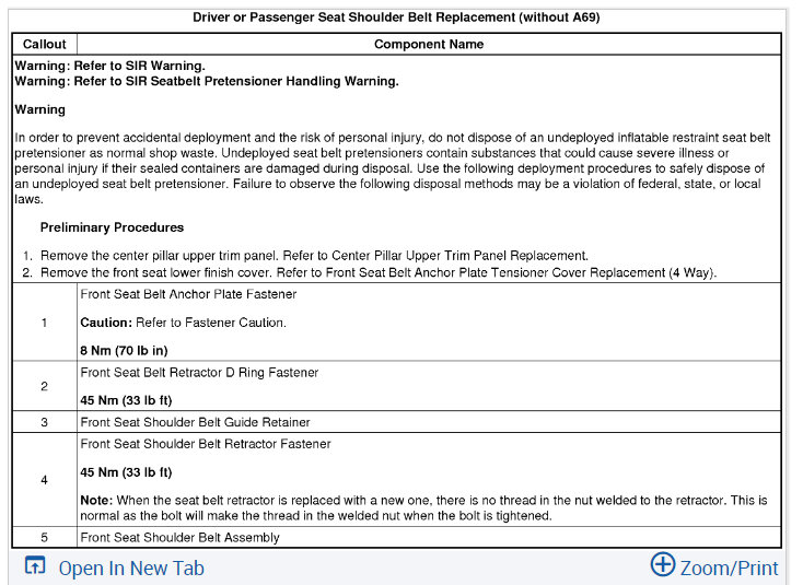

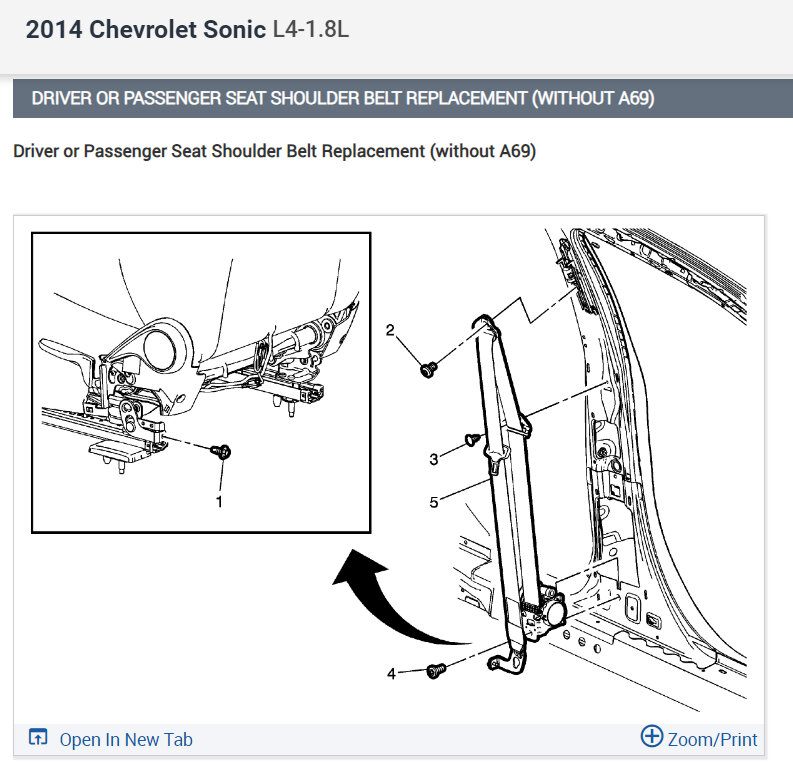

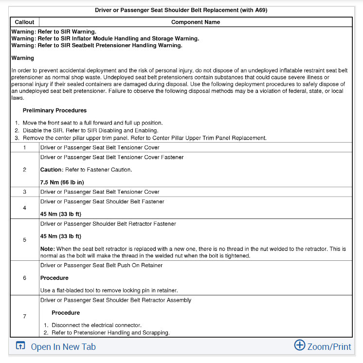

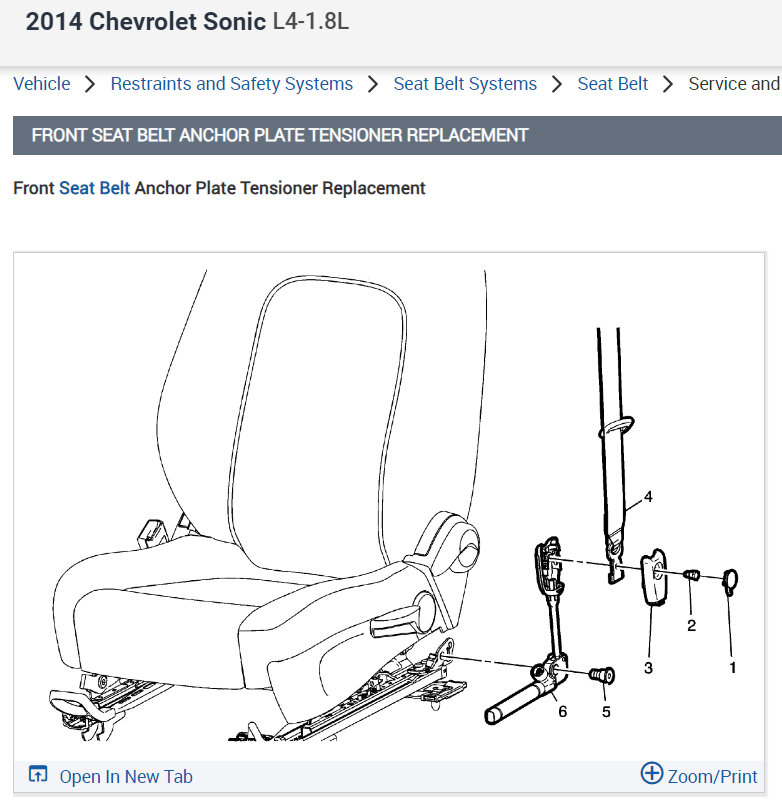

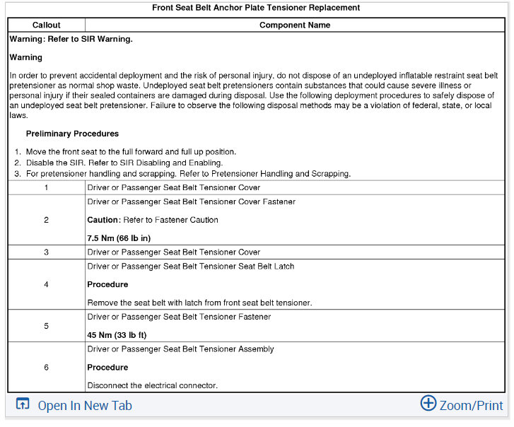

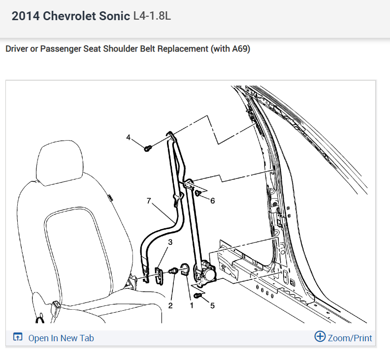

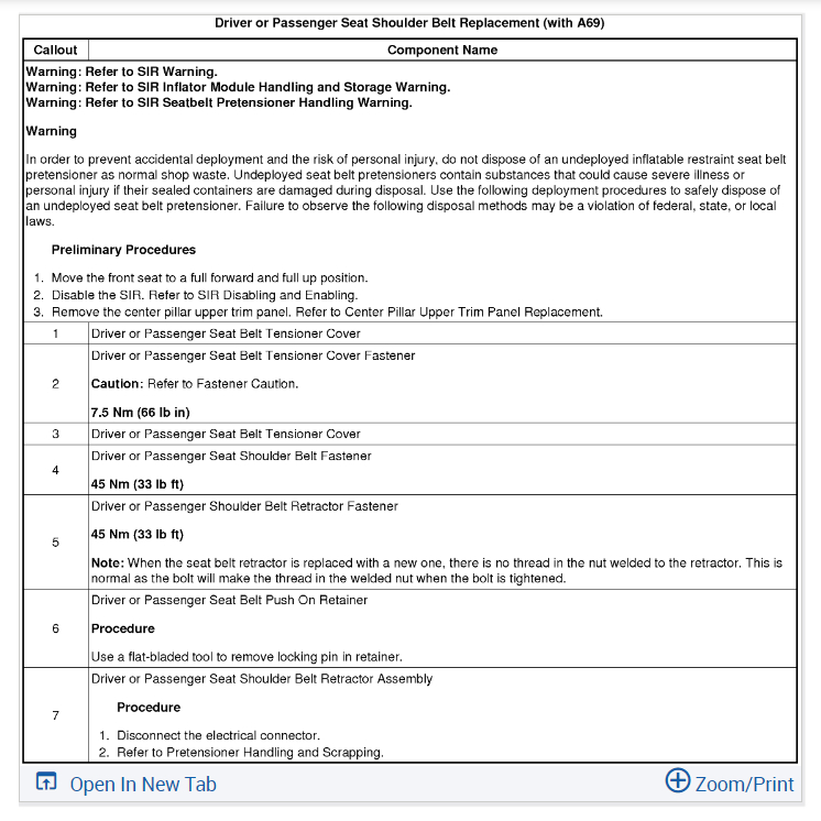

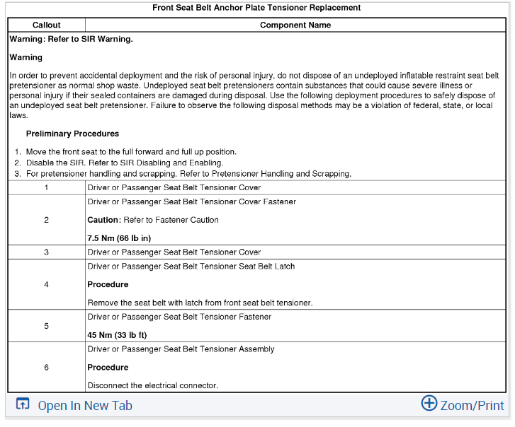

Can you send me the step-by-step instructions (with diagrams if possible) to remove the driver's side seat belt buckle for my vehicle listed above?
Many thanks,
Jon
Jul 12, 2024 at 10:44 PM
  • 55,423 POSTS
Sure, here is how to replace the seat belts for both options, I would disconnect the battery before beginning. Check out the images (below). Please let us know what happens.
