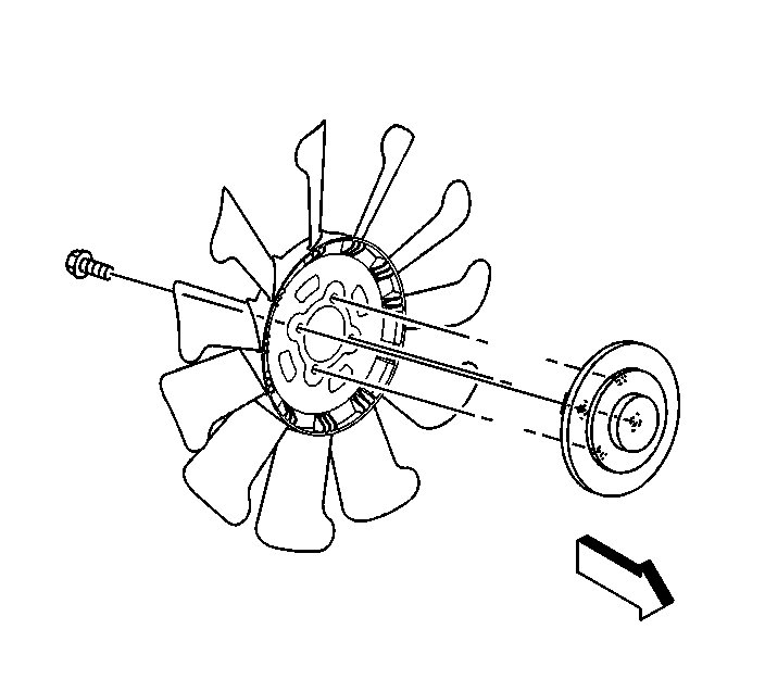

How to take off fan blade,so I can get to the crank bolt.
Jan 14, 2020 at 11:05 AM
  • 110,244 POSTS
The fan and clutch assembly bolt onto the water pump pulley assembly. Here are the directions for removing. Note that you will need a special tool to remove it. Most parts stores will lend one to you.

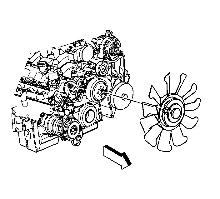

Removal Procedure
pic 1
1. Remove the upper fan shroud.

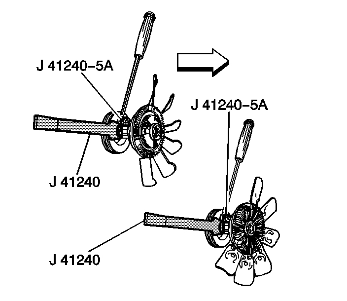

2. Install the J 46406 to the fan clutch.
pic 2
3. Remove the fan hub nut from the water pump in a counterclockwise rotation.
pic 3
4. Remove the fan clutch bolts from the rear of the fan blade.
5. Separate the fan clutch from the fan blade.

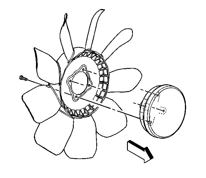

Installation Procedure
Caution: Do not use or attempt to repair a damaged cooling fan assembly. Replace damaged fans with new assemblies. An unbalanced cooling fan could fly apart causing personal injury and property damage.
pic 4
1. Install the fan clutch onto the fan blade.
2. Notice: Refer to Fastener Notice in Service Precautions.
Install the fan clutch bolts
Tighten the bolts to 23 Nm (17 ft. lbs.).

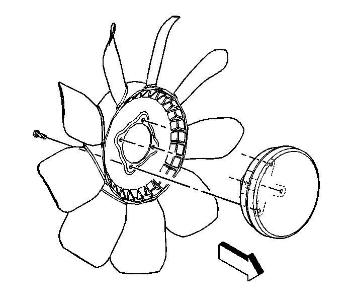

pic 5
3. Install the fan assembly.
pic 6
4. Install the J 46406 to the fan clutch.
Tighten the nut clockwise to 56 Nm (41 ft. lbs.).
