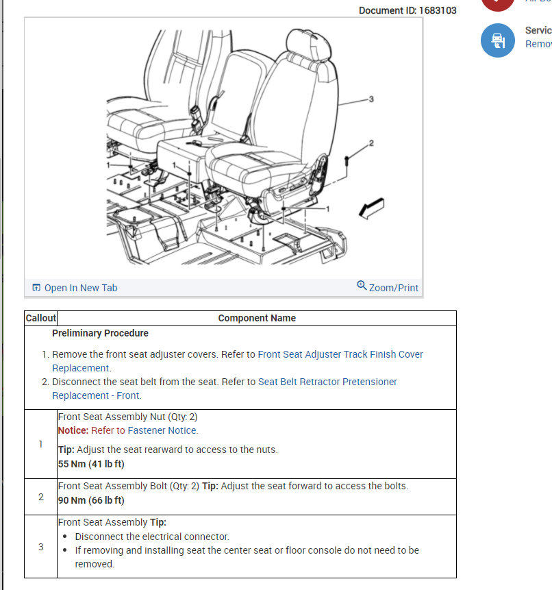

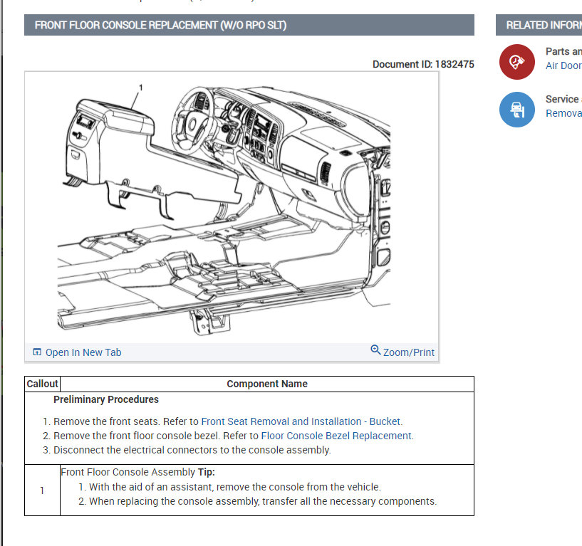

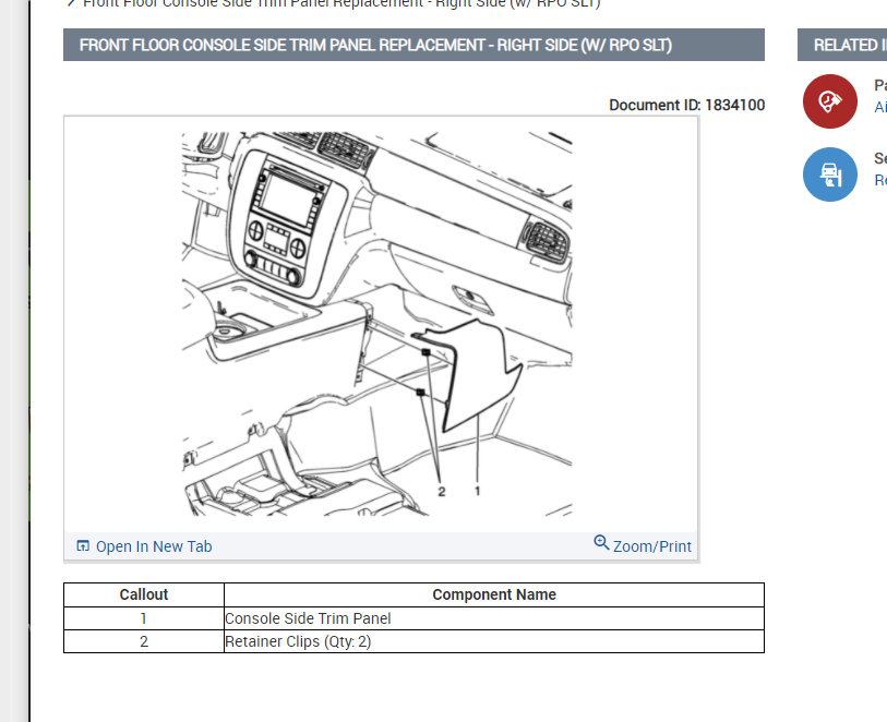

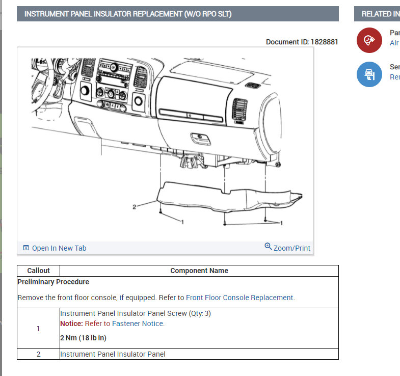

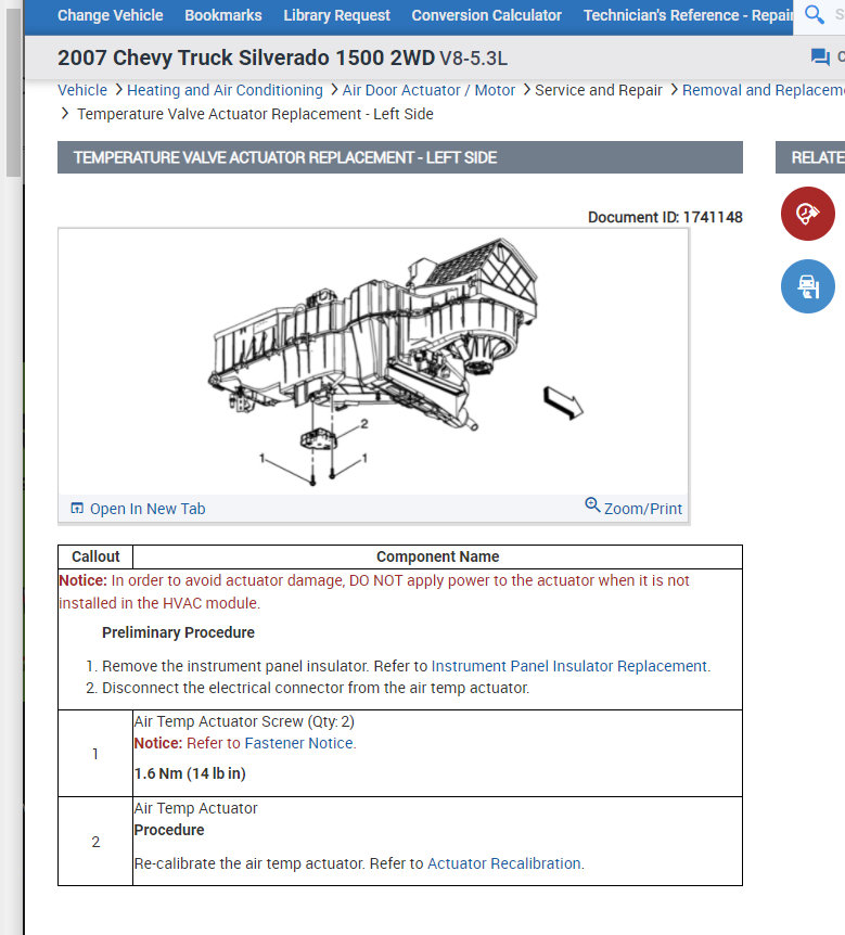

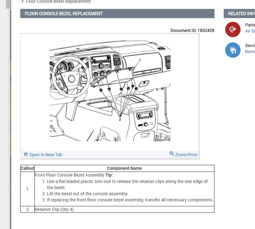

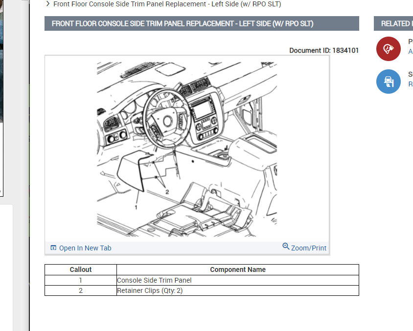

I need to remove my center console for access to the A/C actuator screws behind it.

Are you trying to replace the blend door actuator?
If so we have a good video that shows the procedure for those trucks from 2007-2014.

Video doesn't show the removal of the actuator when the Silverado has a Center Console, which most do. thanks anyway.
Sep 2, 2021 at 7:51 PM
Experienced Mechanic
18,907 POSTS

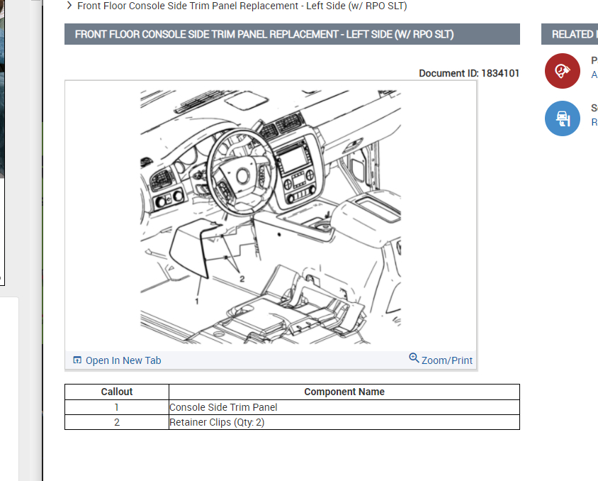

You are correct. Sorry about that. Unfortunately we can only work on the vehicles we have access to.
I am attaching the process from the manual that will help with this. It is not a video but it should help.
Please let us know if you need other info and we can see what we can do.
Thanks
