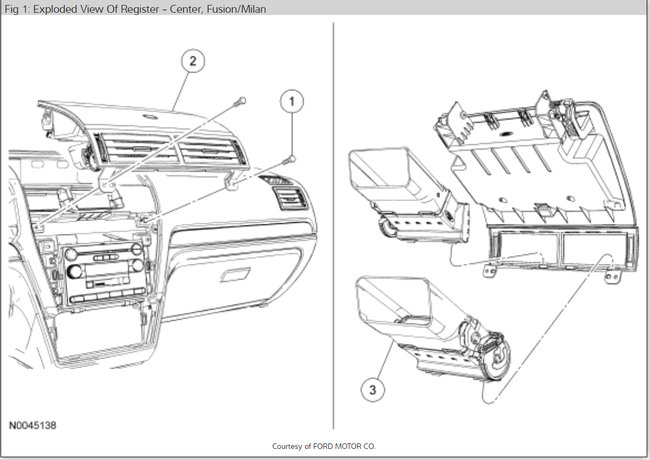

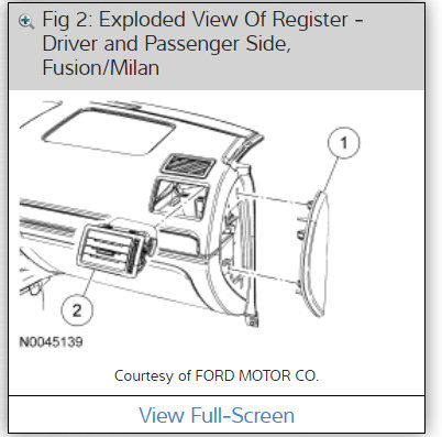

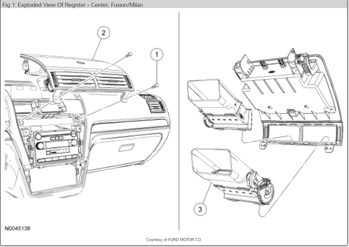

How do I remove the center vents in Dash to replace the a/c vents?
Apr 20, 2013 at 12:08 PM
if you mean the air deflectors, you should have the new ones and see that they press in as a unit. be careful removing and installing as you can break them easily. Here is a diagram that should help below.
