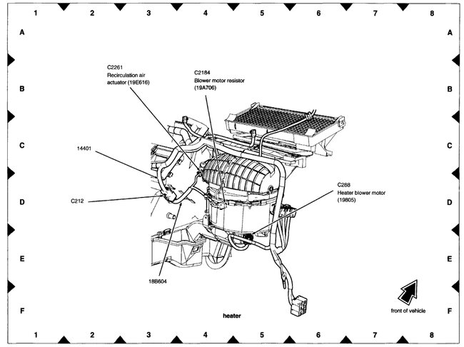

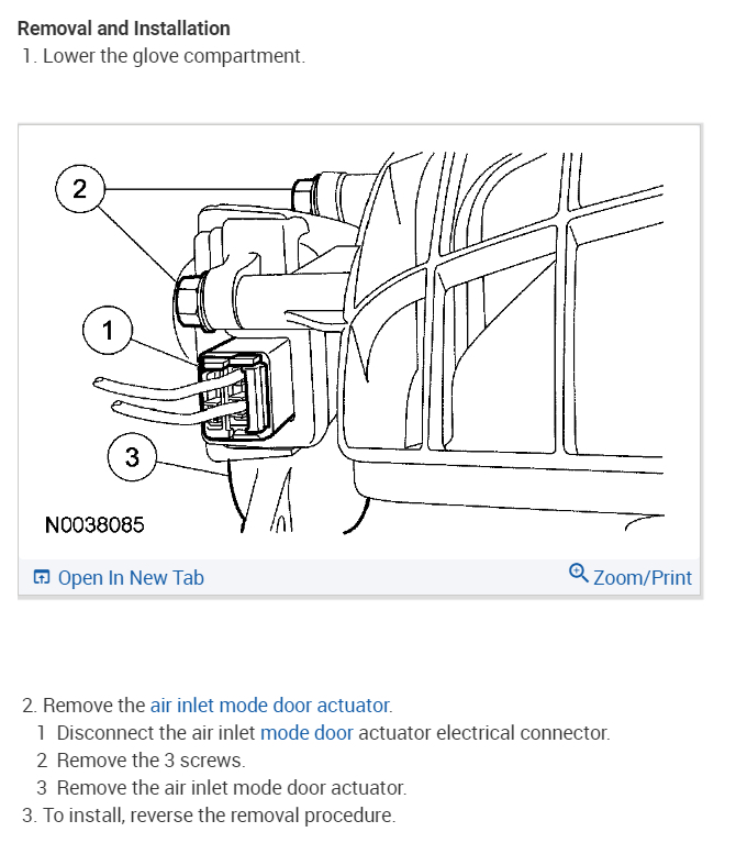

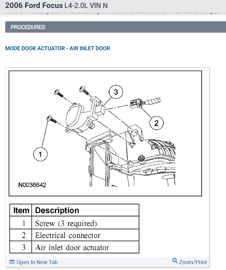

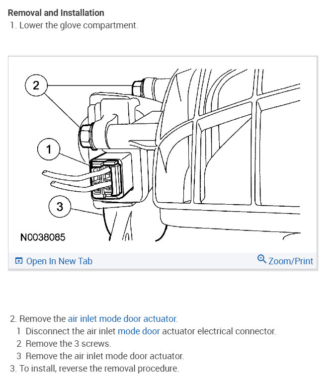

How do I remove and replace a HVAC blend door actuator?
Aug 23, 2023 at 4:45 AM
Experienced Mechanic
55,604 POSTS
There is only one blend door actuator, (inlet) the others are a manual door control please check out this video and the images below.
https://youtu.be/Kawt1EodtFI?si=dB8RjaFlDS3xGaOr
Images (Click to enlarge)
