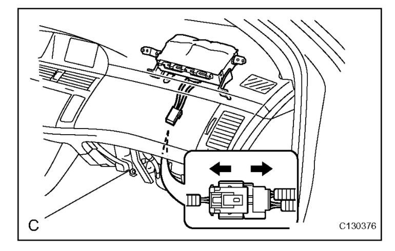

Need to know how to remove airbag dash covering.
Jan 27, 2021 at 4:26 PM
Good evening,
The dash pad on the air bad is part of the airbag itself. It does not come off.
You need to replace the airbag module for it look original.

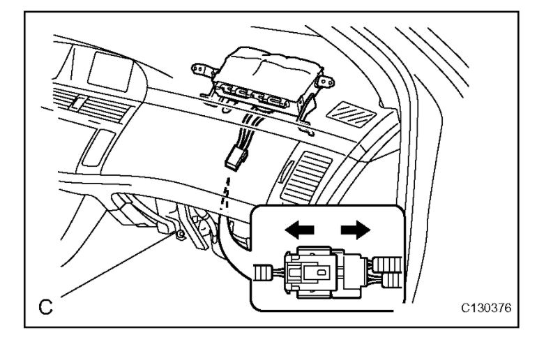

8. DISCONNECT FRONT PASSENGER AIRBAG ASSEMBLY CONNECTOR
a. Disconnect the connector.
NOTE: When handling the airbag connector, take care not to damage the airbag wire harness.

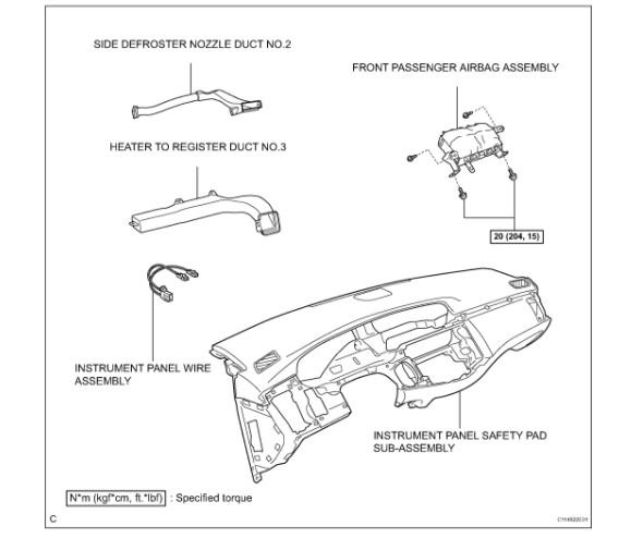

9. REMOVE INSTRUMENT PANEL SAFETY PAD SUB-ASSEMBLY
HINT: Refer to the procedures up to "REMOVE INSTRUMENT PANEL SAFETY PAD SUB-ASSEMBLY".
10. REMOVE SIDE DEFROSTER NOZZLE DUCT NO.2
11. REMOVE HEATER TO REGISTER DUCT NO.3

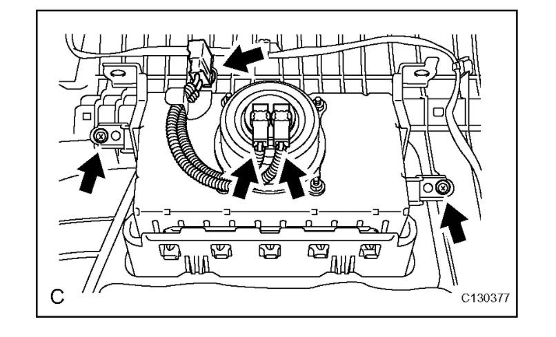

12. REMOVE INSTRUMENT PANEL ASSEMBLY
a. Remove the clip.
b. Disconnect the 2 connectors from the front passenger airbag assembly.

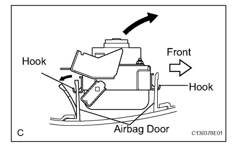

13. REMOVE FRONT PASSENGER AIRBAG ASSEMBLY
a. Remove the 2 screws.
b. Release the rear side airbag door from the hook by slightly deflecting it and roll the front passenger airbag assembly forward.
c. Release the front side airbag door from the other hook and remove the front passenger airbag assembly.

1. INSTALL FRONT PASSENGER AIRBAG ASSEMBLY
2. INSTALL INSTRUMENT PANEL WIRE ASSEMBLY
a. Connect the 2 connectors to the front passenger airbag assembly.
b. Install the clip.
3. INSTALL HEATER TO REGISTER DUCT NO.3
4. INSTALL SIDE DEFROSTER NOZZLE DUCT NO.2
5. INSTALL INSTRUMENT PANEL SAFETY PAD SUB-ASSEMBLY
HINT: Refer to procedures from "INSTALL INSTRUMENT PANEL SAFETY PAD SUB-ASSEMBLY".

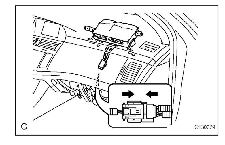

6. CONNECT FRONT PASSENGER AIRBAG ASSEMBLY CONNECTOR
a. Connect the connector.
