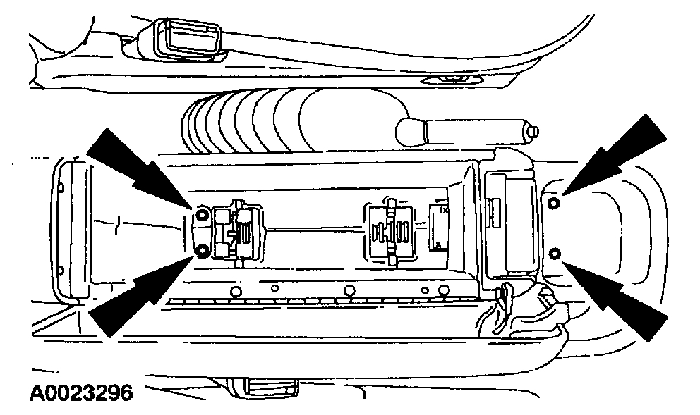

My van came with a full multimedia system including a Video Cassette Player. Although originally designed to be removable, it is actually locked in place to prevent theft.
How is it locked and how do I remove it. I want to replace it with a DVD or Blu-ray played.

To the best of my knowledge, there are no locks. Is it something that was added? Here are the directions I have for removal, but I feel you already did this. See if they help and let me know.
2001 Ford Truck Windstar V6-3.8L VIN 4
Floor Console - Video System
Vehicle Body and Frame Interior Moulding / Trim Console Service and Repair Procedures Floor Console - Video System
FLOOR CONSOLE - VIDEO SYSTEM
REMOVAL

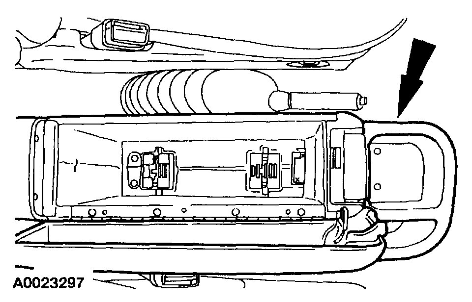

pic 1
1. Release and remove the Video Cassette Player (VCP).

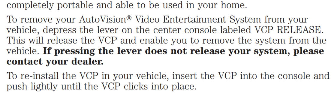

NOTE: To release the video cassette player (VCP) the release push latch must be depressed.
pic 2

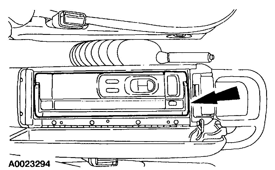

2. Remove the storage bin pad.
pic 3

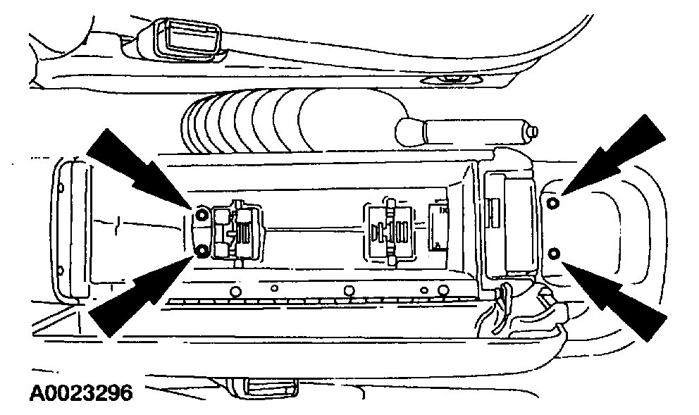

3. Remove the video system console screws.
pic 4
4. Remove the video system console.
^ Disconnect the electrical connectors.
INSTALLATION
1. To install, reverse the removal procedure.

The lock appears to be OEM I'm guessing, as there is a Ford anti-theft sticker attached to face of the Daewoo VCP. Saying that 'This device is not removable'
Like you, i haven't been able to find any information on it, so not sure how to continue.
Will check under vehicle for a bolt or remove center console cowling, more likely there's

If I recall, there were anti theft screws that are to be removed by the dealer when it was new. Interestingly, if you look at pic 1, it says it need taken to a dealer if it won't release. Ugh!
Let me know if you find the solution.
