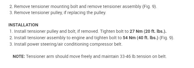

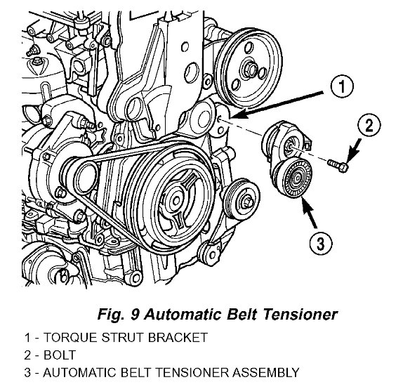

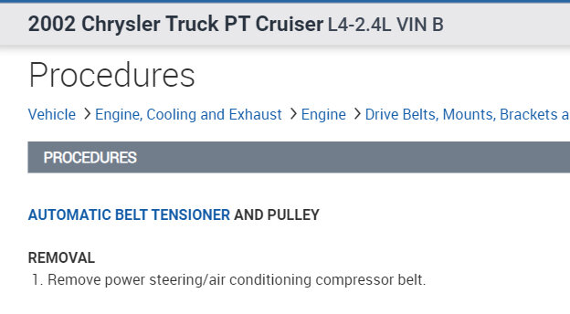

The tensioner is held on with one bolt. If you look below, I attached the directions for replacing the tensioner.
When you do this, it may be easier if you remove the right front tire and inner fender to gain easier access to the part.
The manufacturer's directions are below, but here is a link you may find helpful:
https://www.2carpros.com/articles/serpentine-belt-tensioner-replacement
Sep 7, 2023 at 7:29 AM
HIGHWAY66
  • 11 POSTS

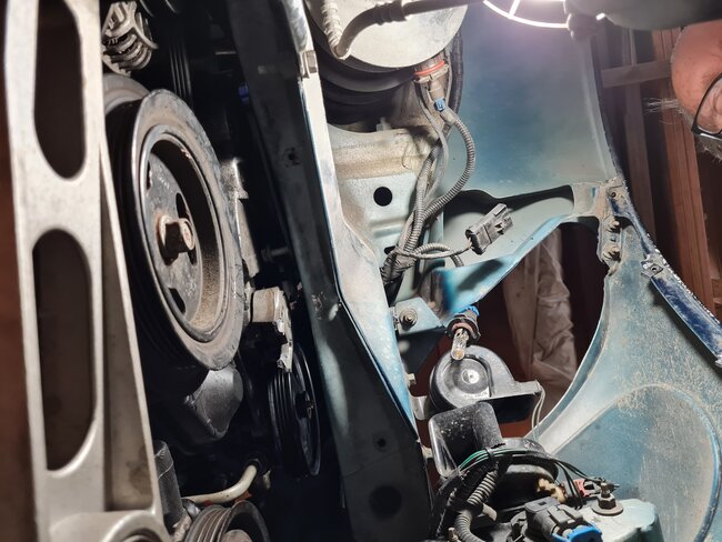

Sorry but that is for the 2.4 motor not the 2.0ltr which is different.
I have taken a photo but not sure how to send.
cheers
Sep 7, 2023 at 2:54 PM

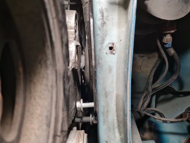

HIGHWAY66
  • 11 POSTS
As pic shows no bolt to detach pulley from casing.
Sep 7, 2023 at 5:27 PM
CANNON1349
  • 861 POSTS
Thank you for the picture. If there is no bolt on either side of the case, then the entire cover there will need to be replaced as a unit.
William
Sep 7, 2023 at 8:54 PM
HIGHWAY66
  • 11 POSTS
Yes, I realize that but to remove does the motor have to come out as the lugs on the inside has insufficient room to move?

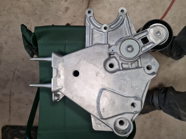

HIGHWAY66
  • 11 POSTS
Hi Joe, here's the replacement one.
Sep 8, 2023 at 12:11 PM
  • 110,244 POSTS
Wow! That looks like half the engine. Is there room to access the bolts on the engine? If you remove the right front wheel and inner fender, do you have access?

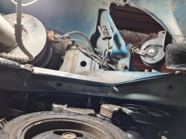

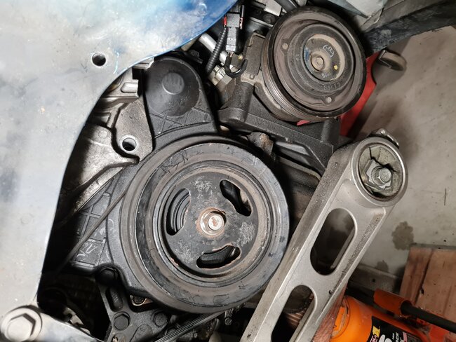

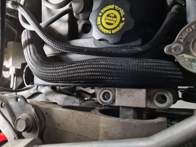

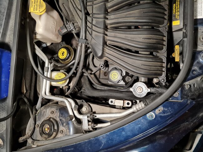

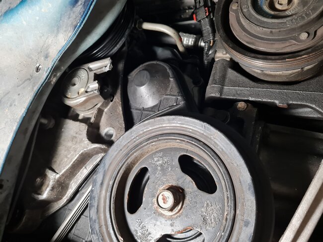

HIGHWAY66
  • 11 POSTS
Hi Joe,
I've taken a few pic's so hopefully they come out okay.
The cruiser is an RHD.
Also, you can see the broken tensioner.
Cheers,
Wally
Sep 11, 2023 at 10:54 AM
  • 110,244 POSTS
Wally,
Wow! Wouldn't you like to know whose idea that was? It looks like it would be easier to lower the engine. If you disconnect the motor mounts and support the engine with a floor jack from underneath, are you able to pry it far enough to remove the bolts?
Sep 11, 2023 at 1:42 PM
