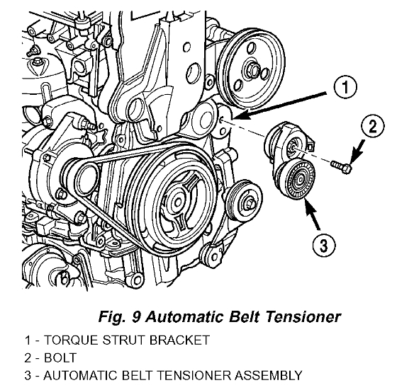

What's the procedure to remove the automatic pulley which is part of the casing? On the 2.4 engine it's just a bolt but on the 2ltr models it's not.
Please help, would be much appreciated.

I can't find any information on a 2.0L engine for that model. However, if you are just replacing the pulley, more often than not I have seen that the pulley bolt is left hand threaded. This means that turning right will loosen the bolt and turning left will tighten it. In other configurations, the tensioner assembly would be held on with 10mm bolts around the case. If possible, send us a picture if you can get a good look at it.

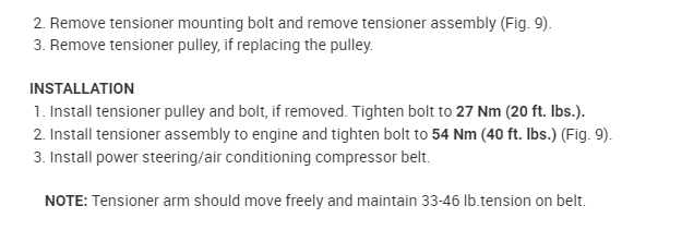

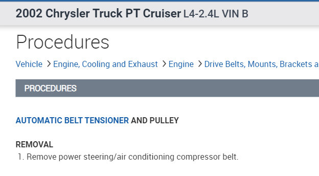

  • 110,194 POSTS

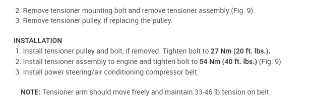

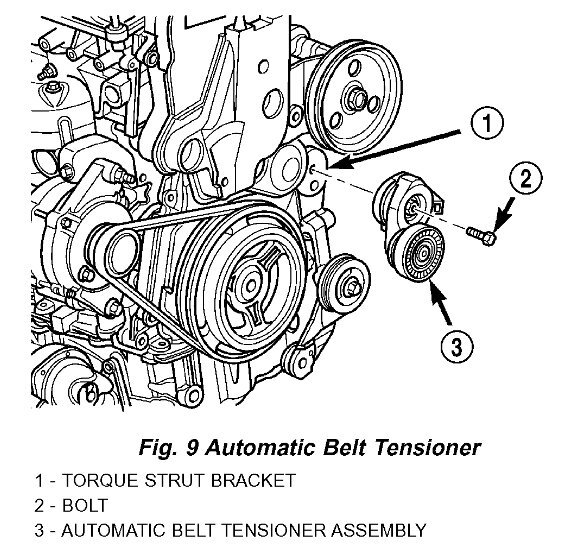

The tensioner is held on with one bolt. If you look below, I attached the directions for replacing the tensioner.
When you do this, it may be easier if you remove the right front tire and inner fender to gain easier access to the part.
The manufacturer's directions are below, but here is a link you may find helpful:
https://www.2carpros.com/articles/serpentine-belt-tensioner-replacement

HIGHWAY66
  • 11 POSTS
Sorry but that is for the 2.4 motor not the 2.0ltr which is different.

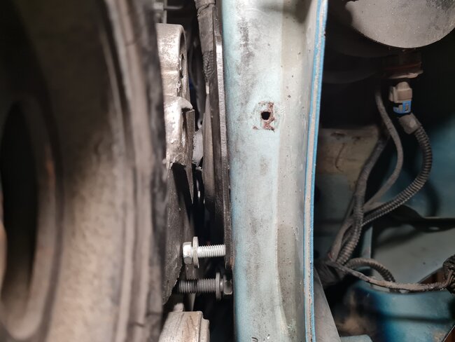

HIGHWAY66
  • 11 POSTS

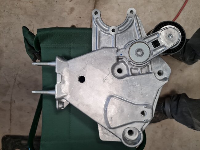

As pic shows no bolt to detach pulley from casing.
Sep 8, 2023 at 12:27 AM
CANNON1349
  • 861 POSTS
Thank you for the picture. If there is no bolt on either side of the case, then the entire cover there will need to be replaced as a unit.
William
Sep 8, 2023 at 3:54 AM
HIGHWAY66
  • 11 POSTS
Yes, I realize that but to remove does the motor have to come out as the lugs on the inside has insufficient room to move?
Sep 8, 2023 at 4:01 AM

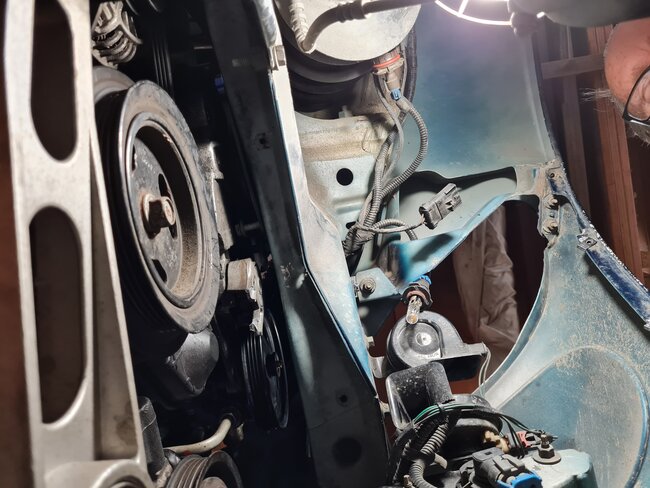

HIGHWAY66
  • 11 POSTS
Hi Joe, here's the replacement one.
Sep 8, 2023 at 7:11 PM
  • 110,194 POSTS
Wow! That looks like half the engine. Is there room to access the bolts on the engine? If you remove the right front wheel and inner fender, do you have access?
Sep 9, 2023 at 8:10 PM
HIGHWAY66
  • 11 POSTS
The bolts you can undo but not remove, but also those lugs on the inside of that casing , there's not enough clearance for it to be removed.
Sep 9, 2023 at 9:12 PM

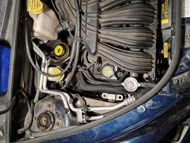

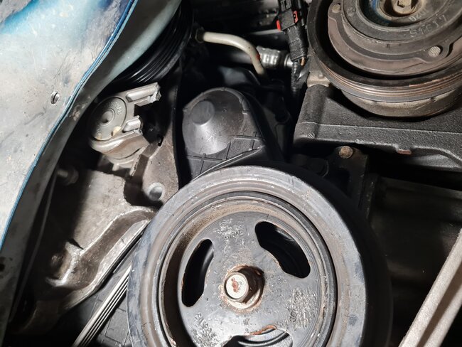

HIGHWAY66
  • 11 POSTS

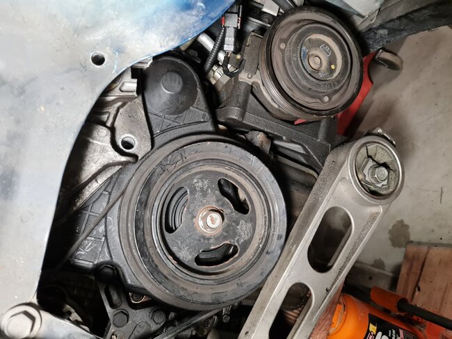

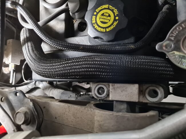

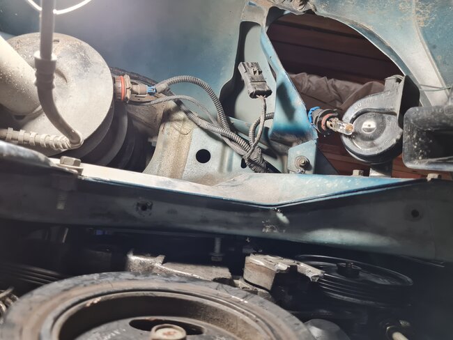

Hi Joe,
I've taken a few pic's so hopefully they come out okay.
The cruiser is an RHD.
Also, you can see the broken tensioner.
Cheers,
Wally
Sep 11, 2023 at 5:54 PM
  • 110,194 POSTS
Wally,
Wow! Wouldn't you like to know whose idea that was? It looks like it would be easier to lower the engine. If you disconnect the motor mounts and support the engine with a floor jack from underneath, are you able to pry it far enough to remove the bolts?
Sep 11, 2023 at 8:42 PM
