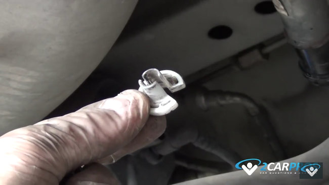

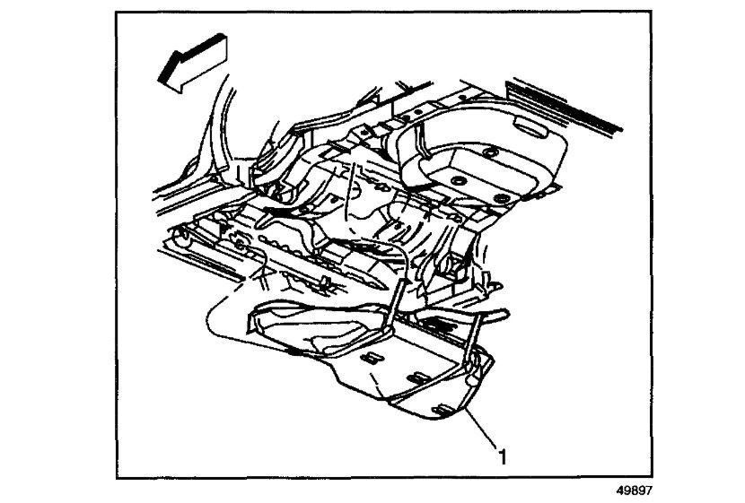

Have disconnected all wiring, filter, filler tube and removed the two rear strap bolts. Suddenly realized heat shield may be an issue. So question is, do I have to remove heat shield to remove tank or will it drop and then slide to the right of the car to slide from over exhaust pipe? Also, watched a video and guy used a little round plastic tool to disconnect fuel delivery line. (picture included) Is this tool required or is there a way around it? If so, does this line connect to pump if I break it because pump comes with two lines already attached with snap ons?

The tank comes down with the shield attached, I attached a picture for you.
Yes, you need the special tool to release the clips. You can get the set at a parts store for about $10.00 to $15.00.
