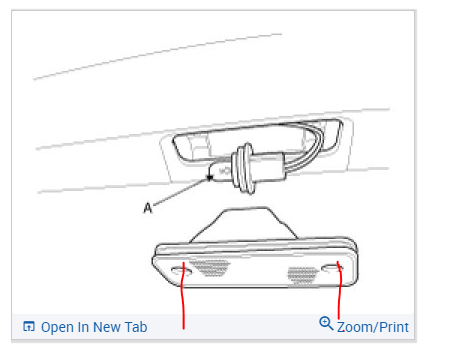

The rear License plate lamp melted on the left side; the right side is still good. Purchase OEM replacement which is 2 lamps with harness. Lamps located in rear hatch garnish panel. I already removed the inner trim and 4 nuts of garnish panel inner bolts. When i went to outside and tried to lift the garnish panel off the rear hatch door, it did not seem to come off easily. Do i have to pry the top of garnish panel to release any clips? did not want to force i and break panel.

I'm not sure what melted. Are you referring to the assembly that melted? If so, it is held in by two screws. See pic below.
If that is not correct, please take a picture of what you are dealing with and upload it for me to see.
See pic below.

The melted lamps are not the issue. I have to replace lamps with wire harness. Need to remove garnish panel on rear hatchback of 2014 Santa Fe. lamp harness feeds through garnish panel. after removing 4 nuts on inside of hatch back off garnish panel bolts. panel would not come off. I now see 2 nylon clips inside hatch back that are under garnish panel. any idea how to release these clips. Think after releasing nylon clips, the garnish panel will lift off.
