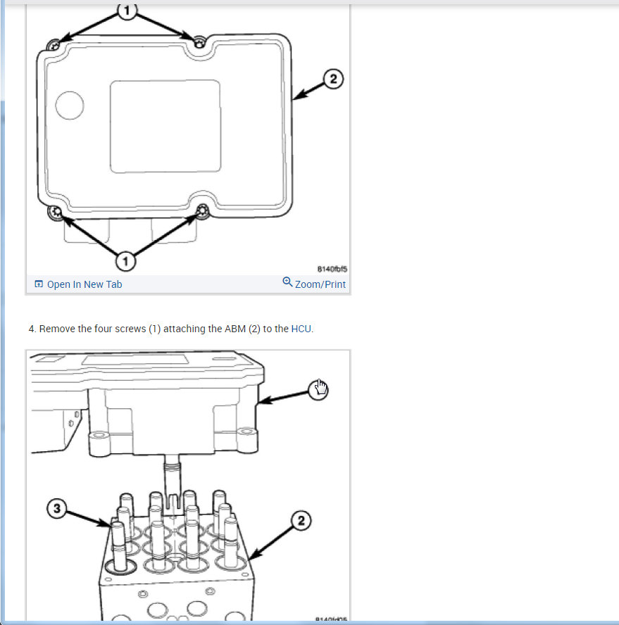

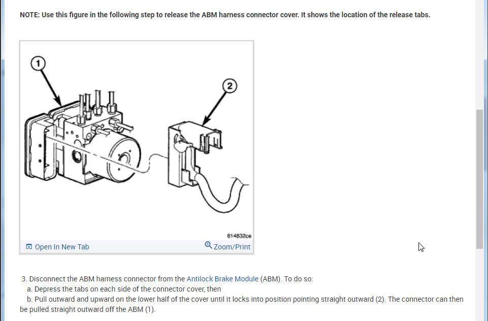

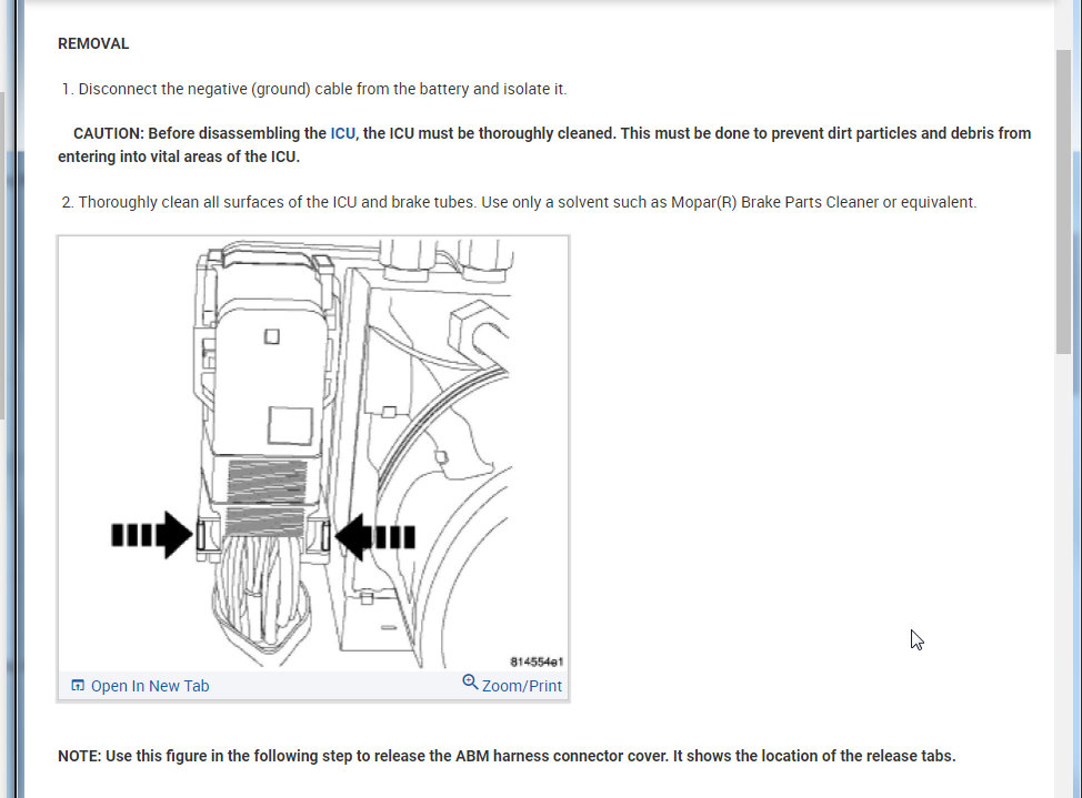

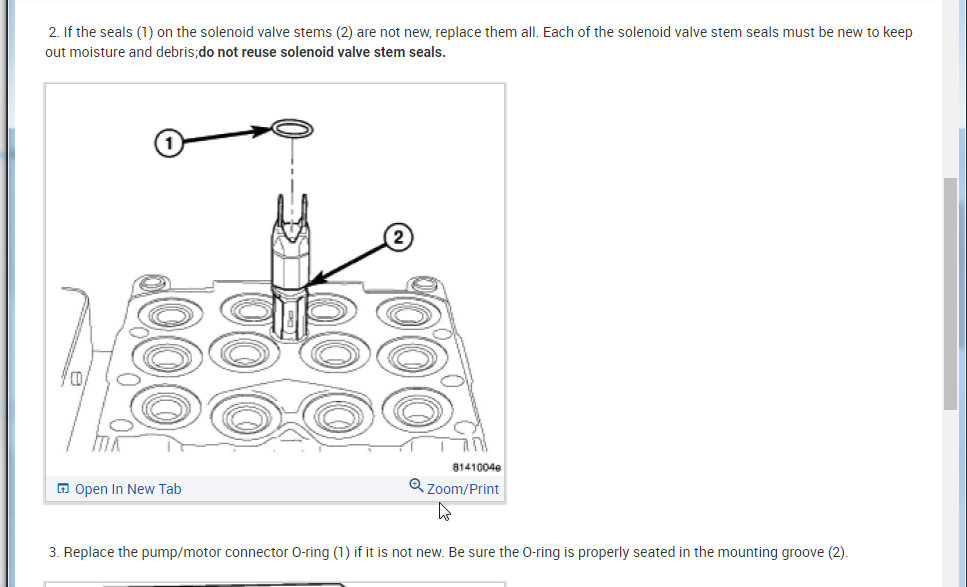

ABS unit bad; cannot access the rear of the ABS unit plug. Any suggestions on how to remove the plug from the engine compartment side?
May 4, 2017 at 10:46 PM
Experienced Mechanic
18,907 POSTS

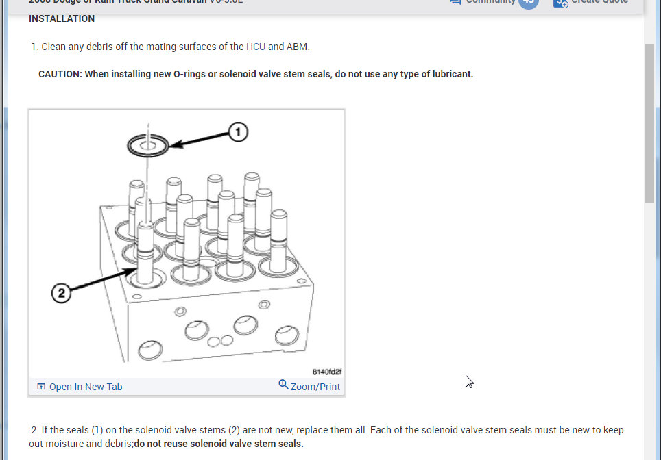

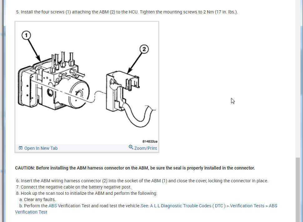

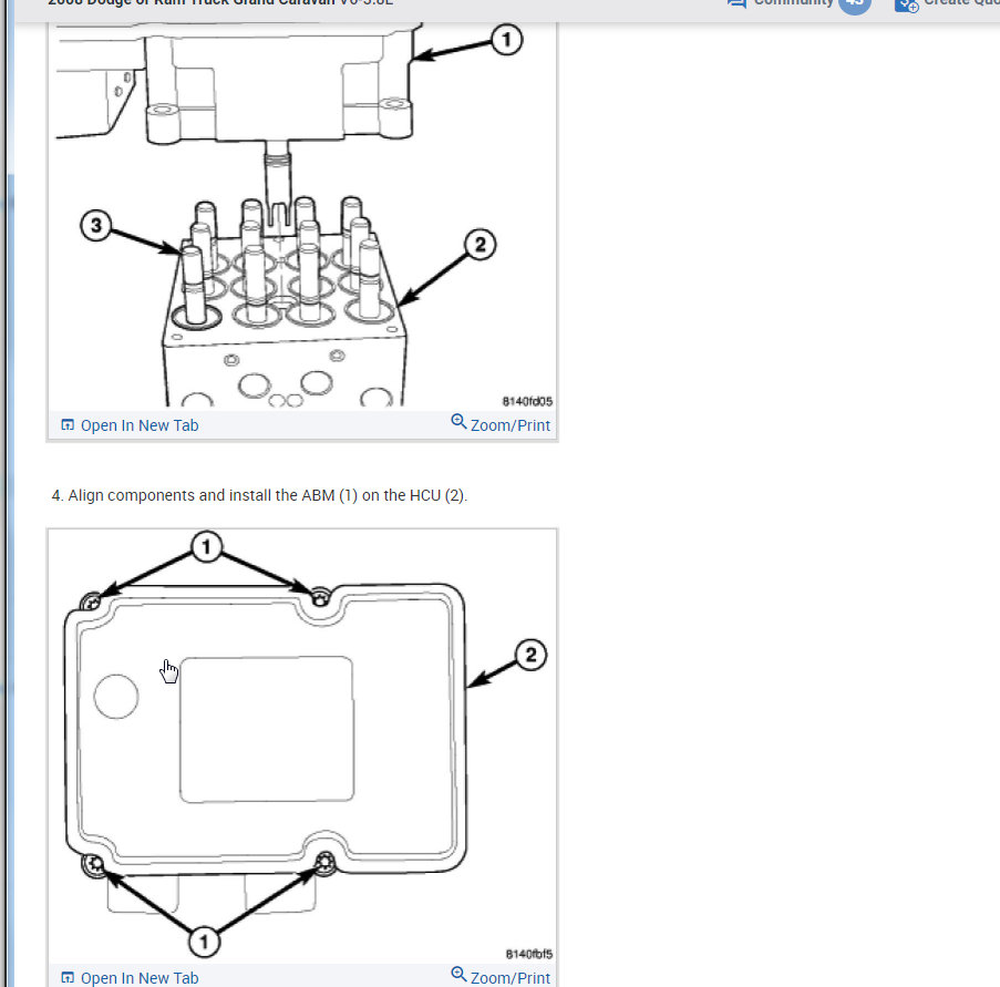

You need to remove the HCU and brake module as a unit and then you will have access to the plug so that it releases.
Here is a guide as well that will help with this:
https://www.2carpros.com/articles/how-to-replace-a-abs-controller
Here are the instructions below for more detail on this. Let me know if you have questions on this. Thanks
