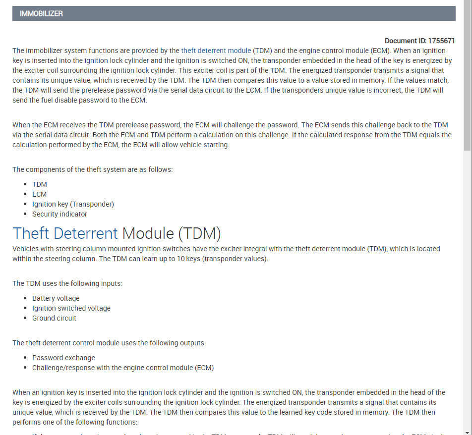

I suspect if the battery was still hooked up that the vehicle thinks it was being stolen so it went to theft mode.
I see where you said you think it irritated it so that means most likely the light is remaining on.
https://www.2carpros.com/articles/how-to-reset-a-security-system

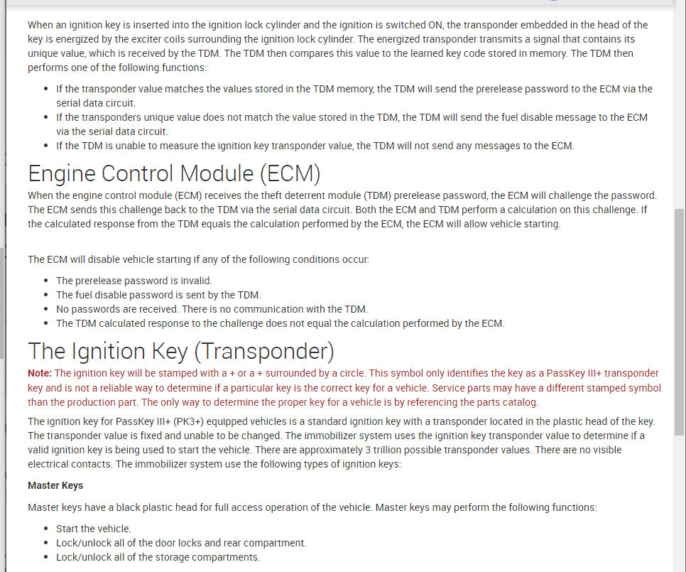

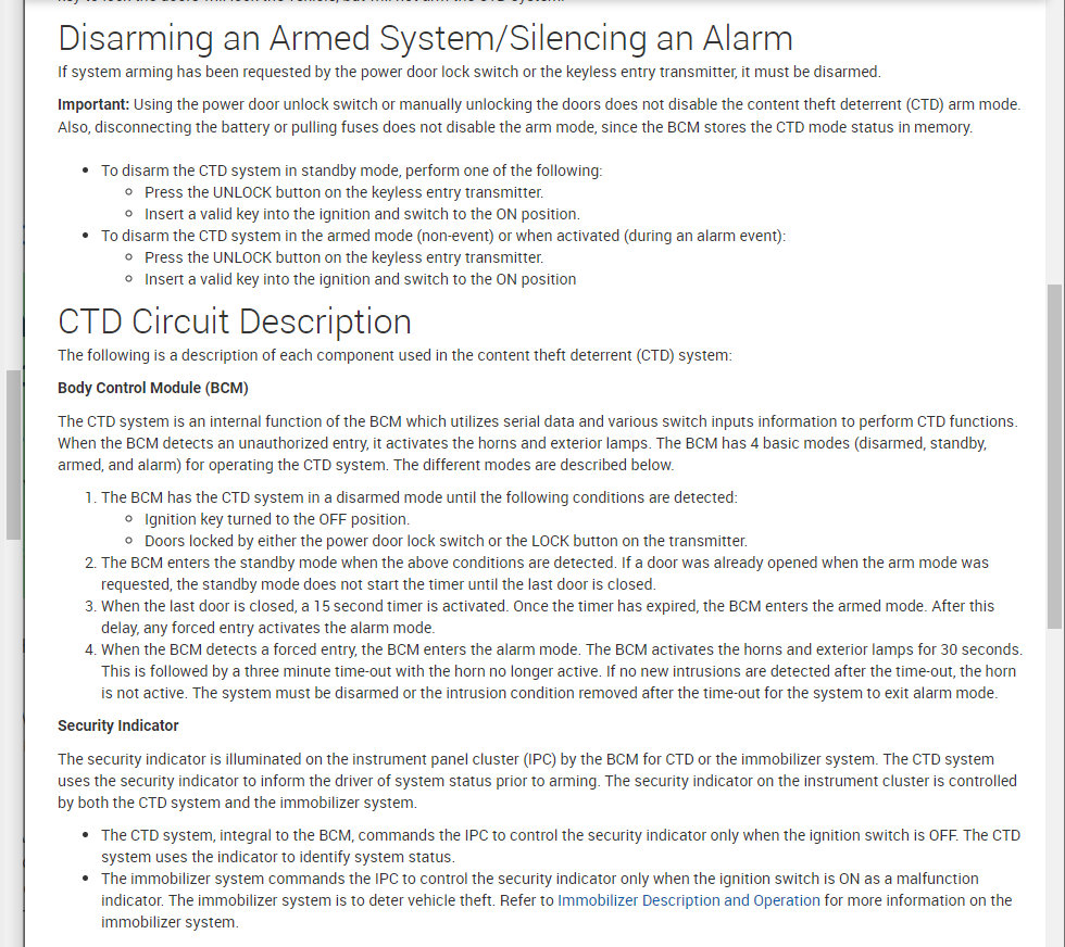

Are you able to disarm the system? If not, try putting the key in the ignition and turn it to the on position for up to 30 minutes. Clearly make sure the radio, HVAC, and other accessory items are off to limit battery drain.

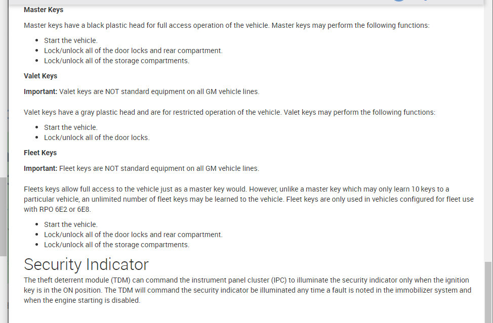

I attached the info below on this system in case you need that.
