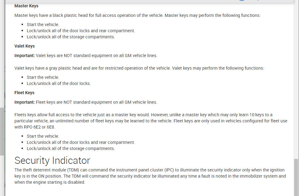

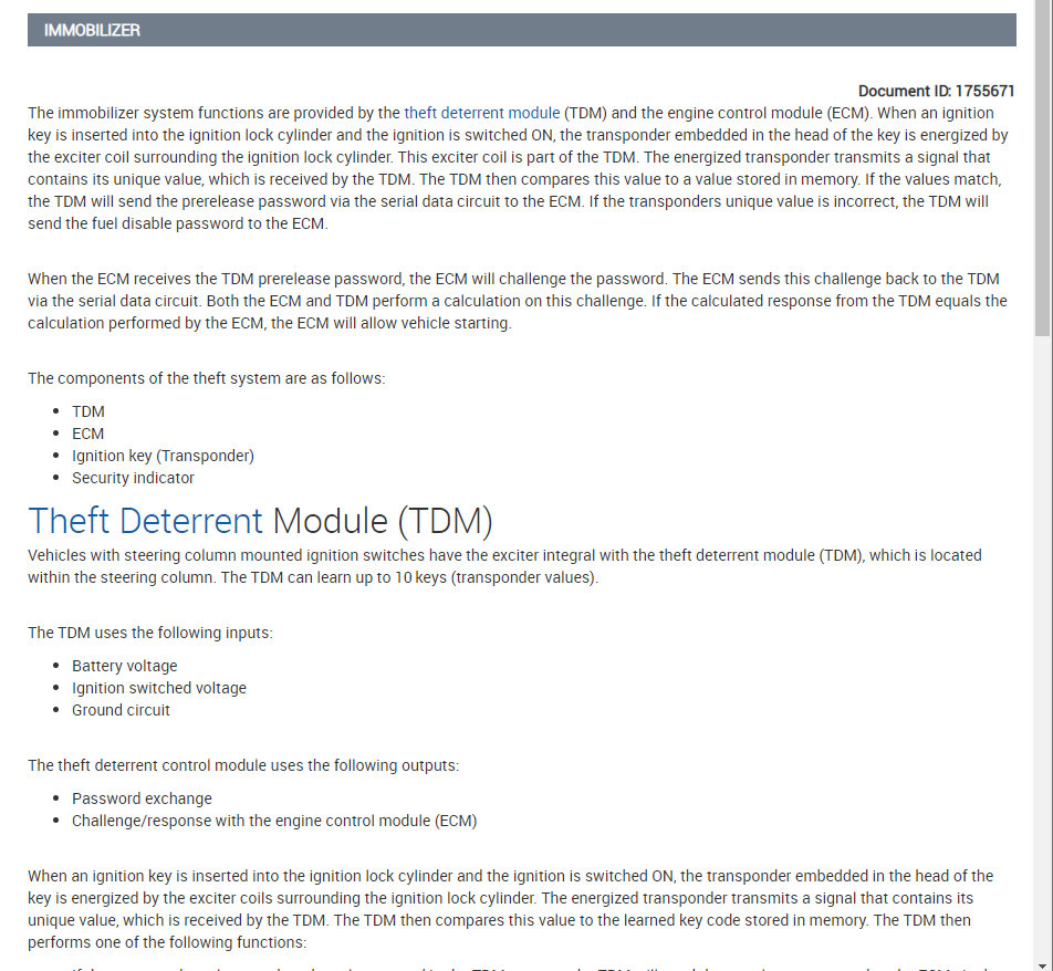

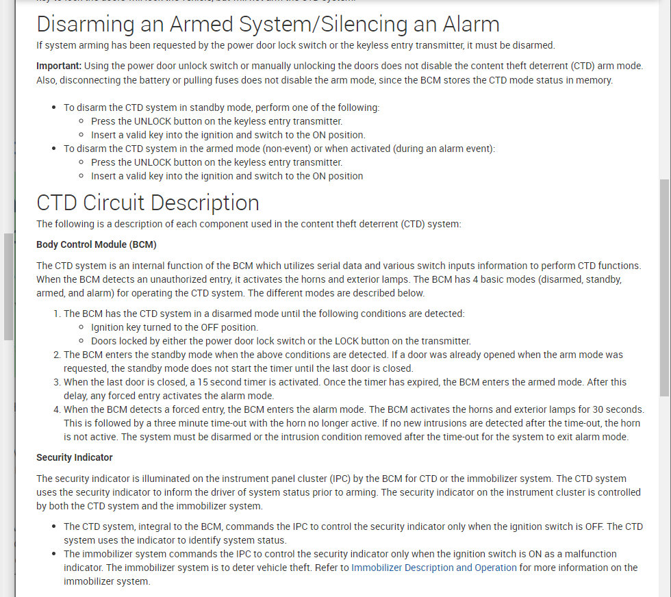

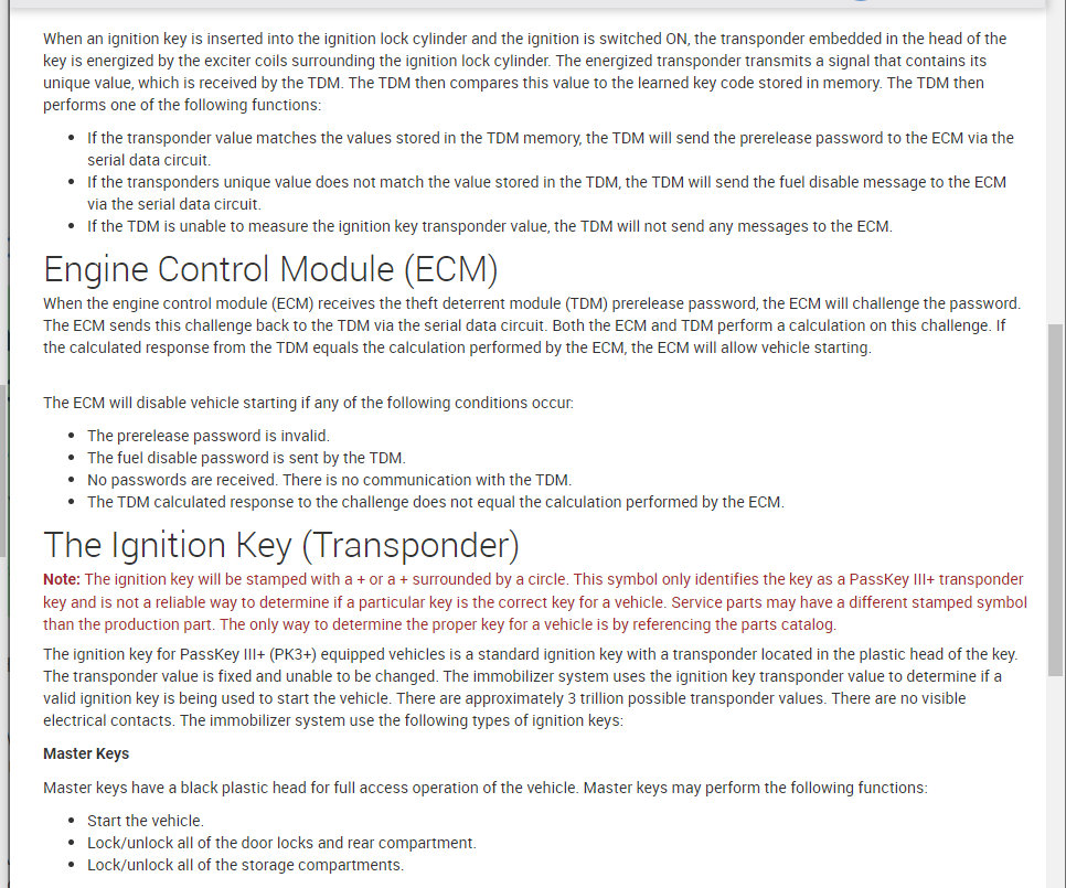

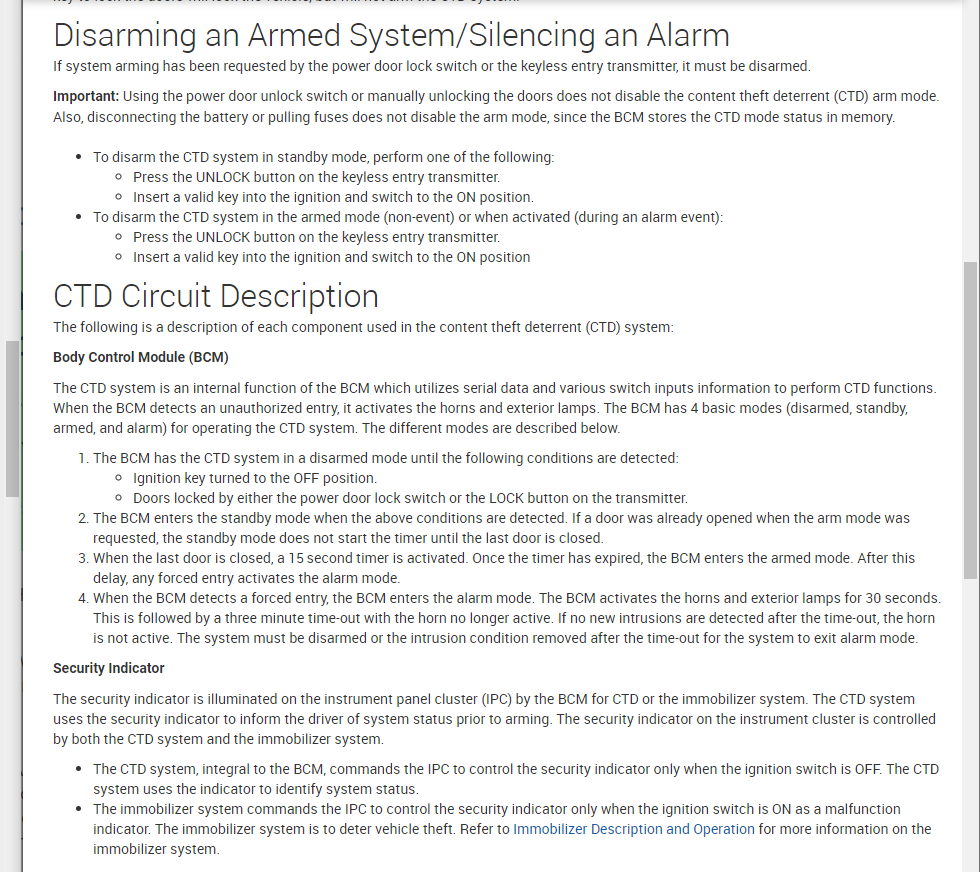

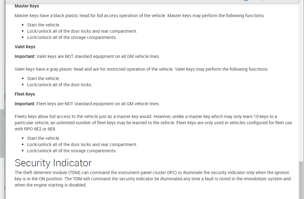

Are you able to disarm the system? If not, try putting the key in the ignition and turn it to the on position for up to 30 minutes. Clearly make sure the radio, HVAC, and other accessory items are off to limit battery drain.
I attached the info below on this system in case you need that.
