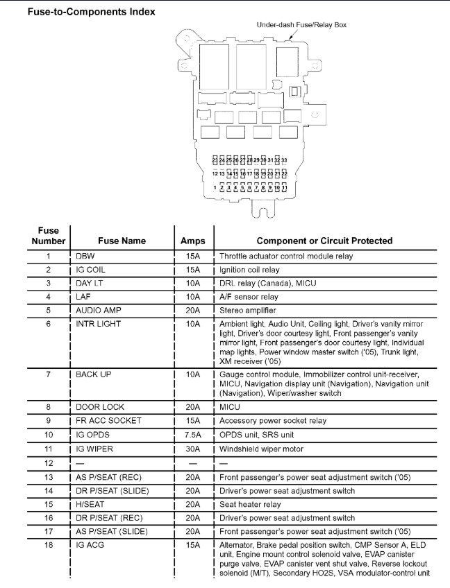

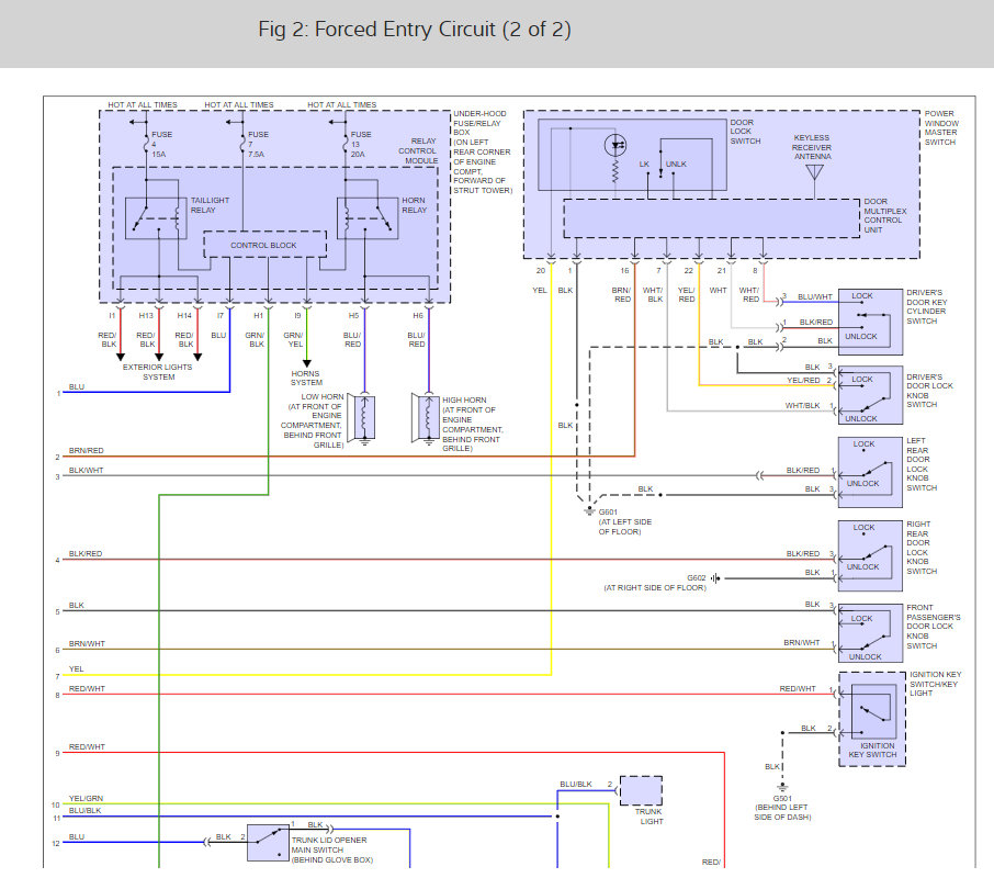

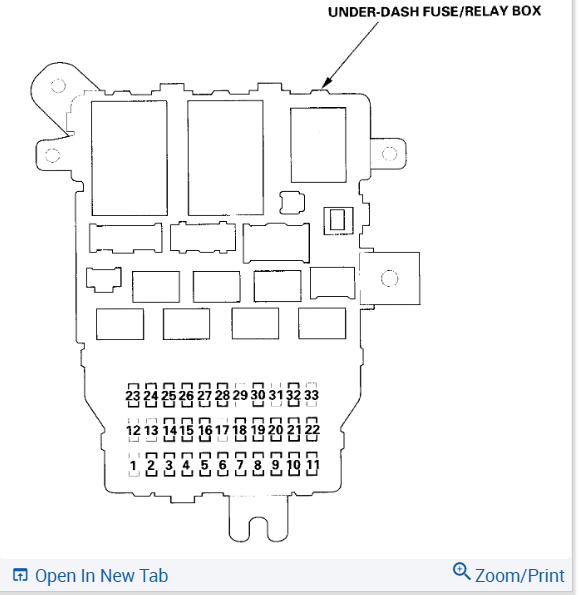

I have a power lock problem when only using the key fobs. I changed the batteries in both my key fobs and I am still not getting good reactions corresponding with the key fobs. All locks work fine while operating system from the driver door panel switches. Since both key fobs do not want to work precisely what they are supposed to do, even after I changed the batteries in both of them. Is there a brain box that works with the system which is usually the suspect of the problem? How does the key-less entry system work on this factory equipped system?
Nov 10, 2018 at 3:08 AM
  • 55,710 POSTS

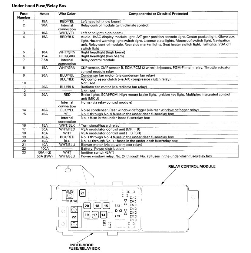

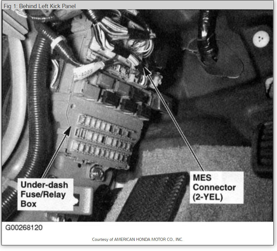

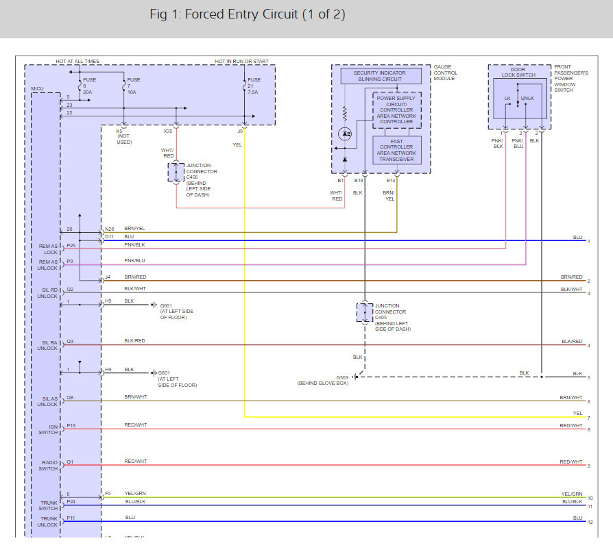

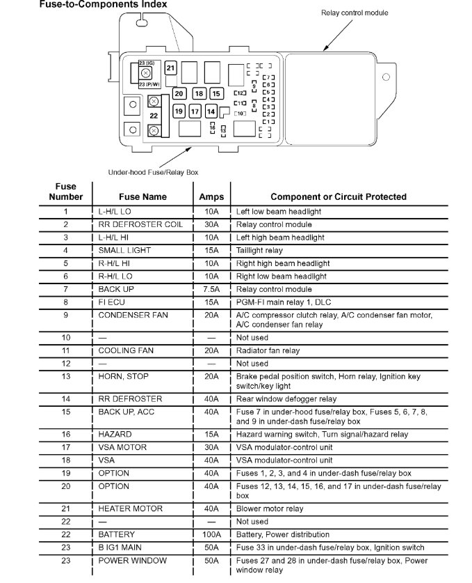

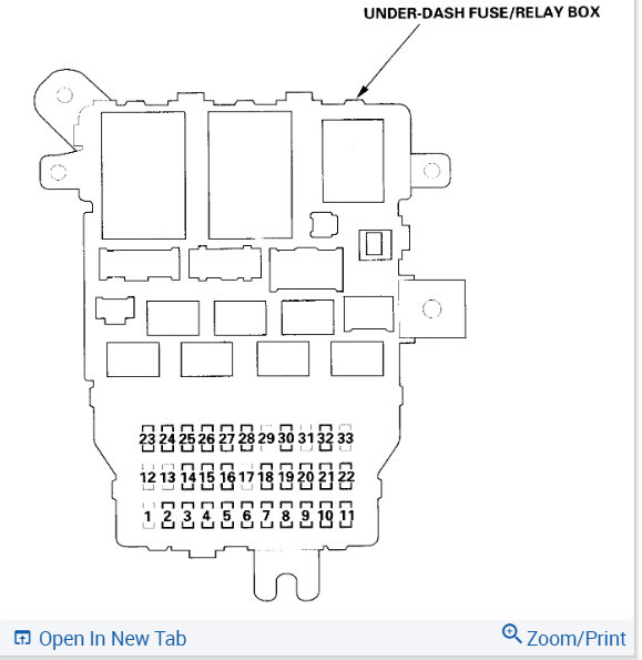

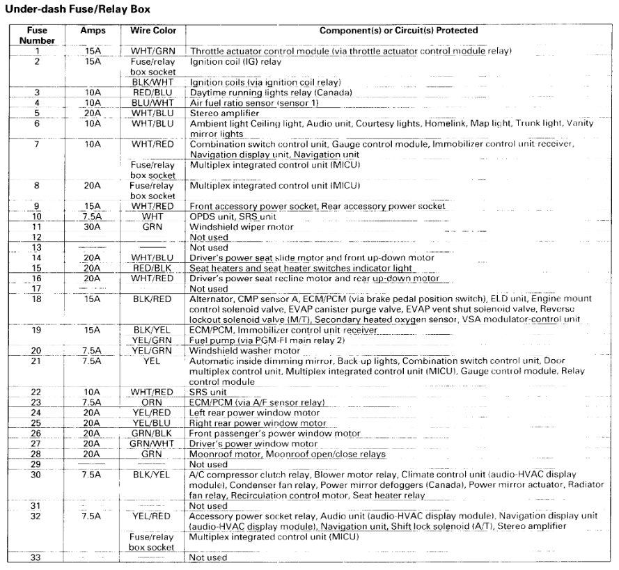

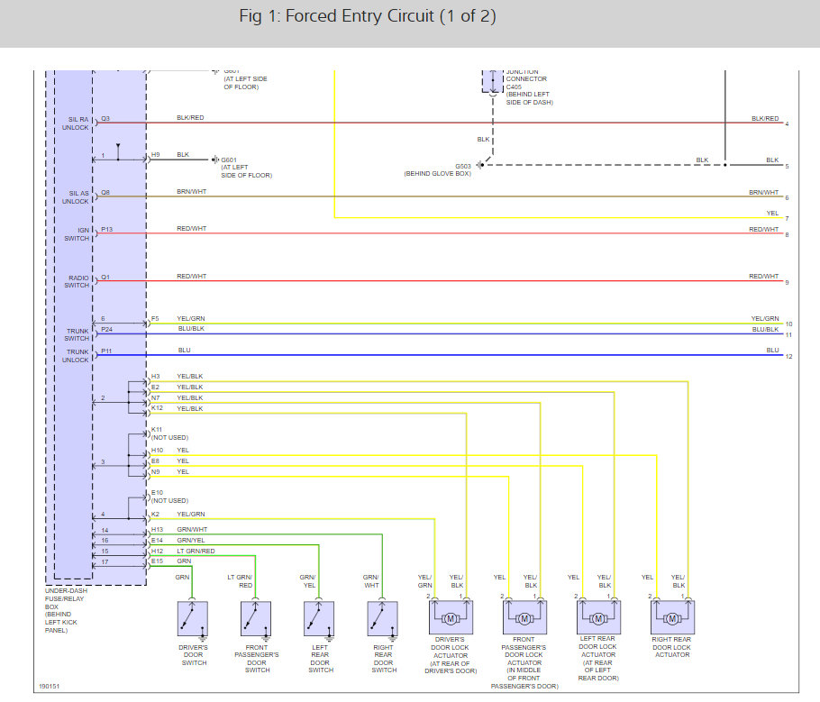

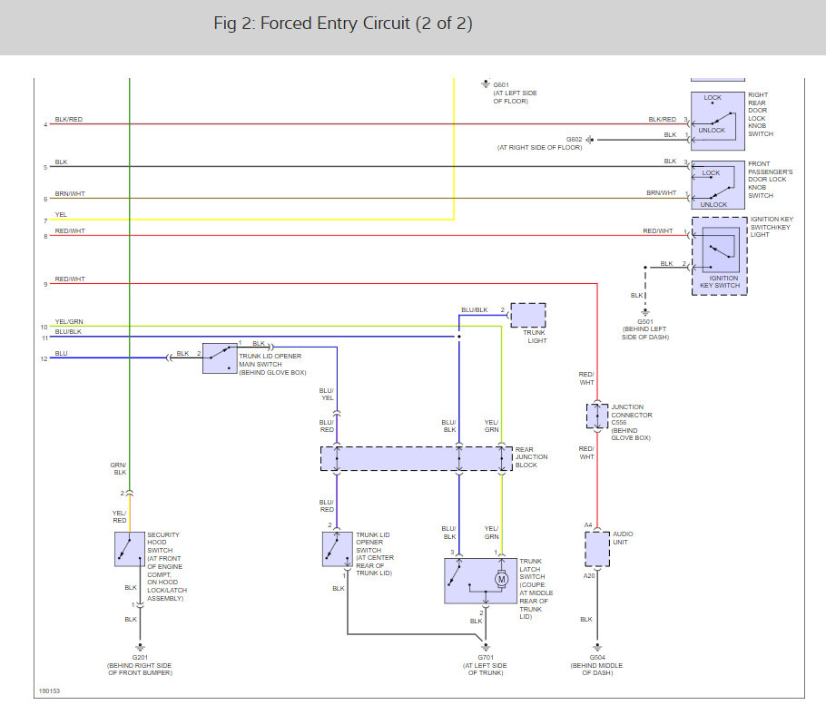

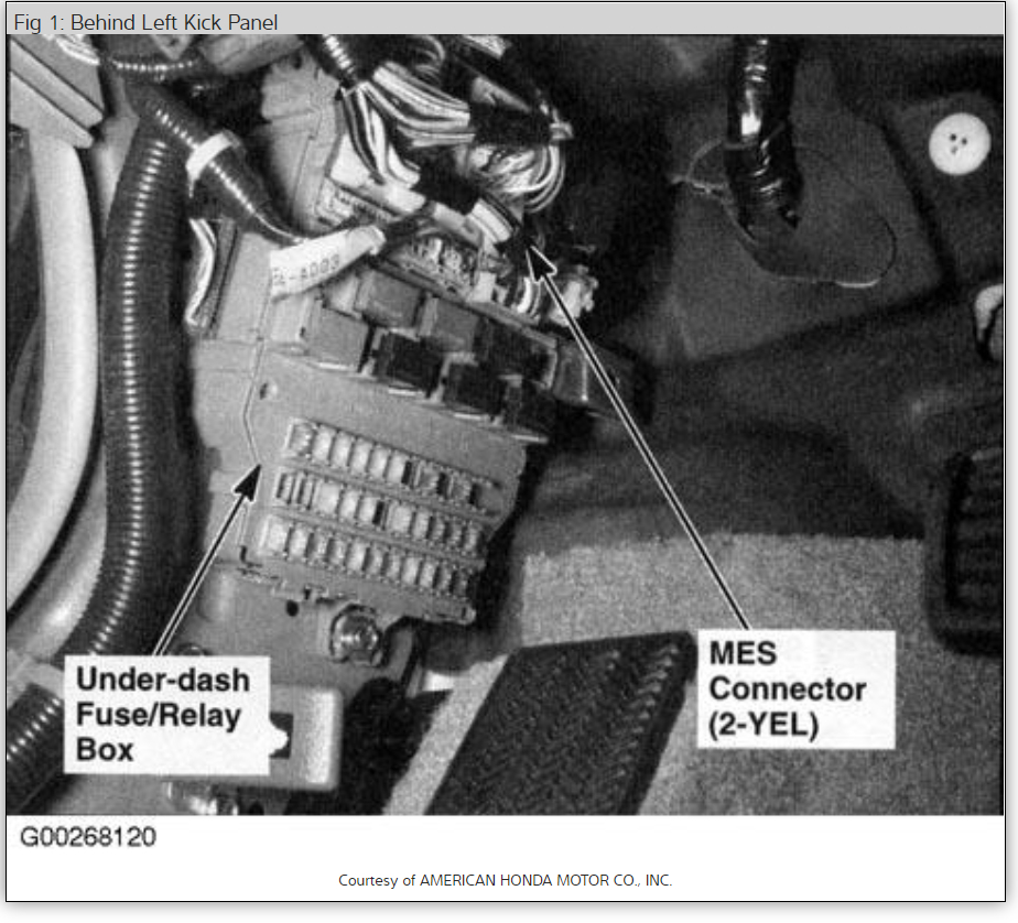

It sounds like a fuse is out. Here are the alarm wiring diagrams so you can see how the system works and a guide to help you check the fuses along with the fuse locations:
You can see the fuses that need to be checked by the wiring diagrams.

Thanks for your help, but I changed the door lock actuator.

I changed the door actuator with an OEM one because someone bypassed it with a universal one and cut the cable to the door lock. Had to buy a new cable to the button from dealer and actuator was off eBay.
