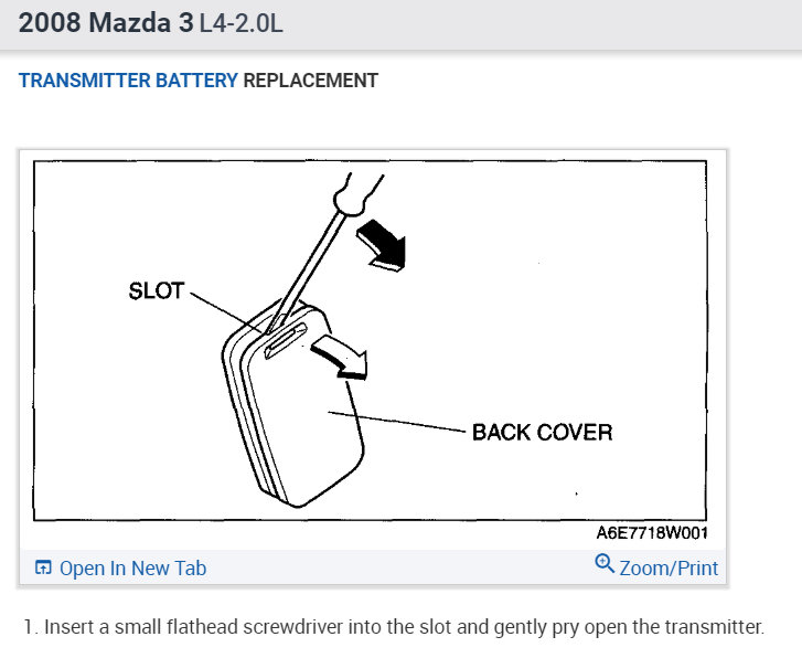

My key stopped working. Looked to see if I need to replace a battery but can't find how to open the remote. Appreciate some advice. Thanks, Linda
Feb 15, 2019 at 11:31 AM
  • 55,412 POSTS

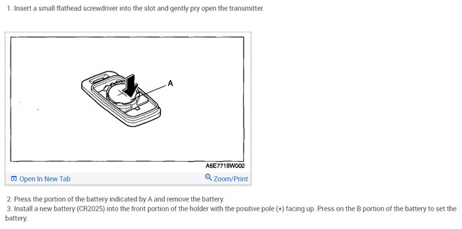

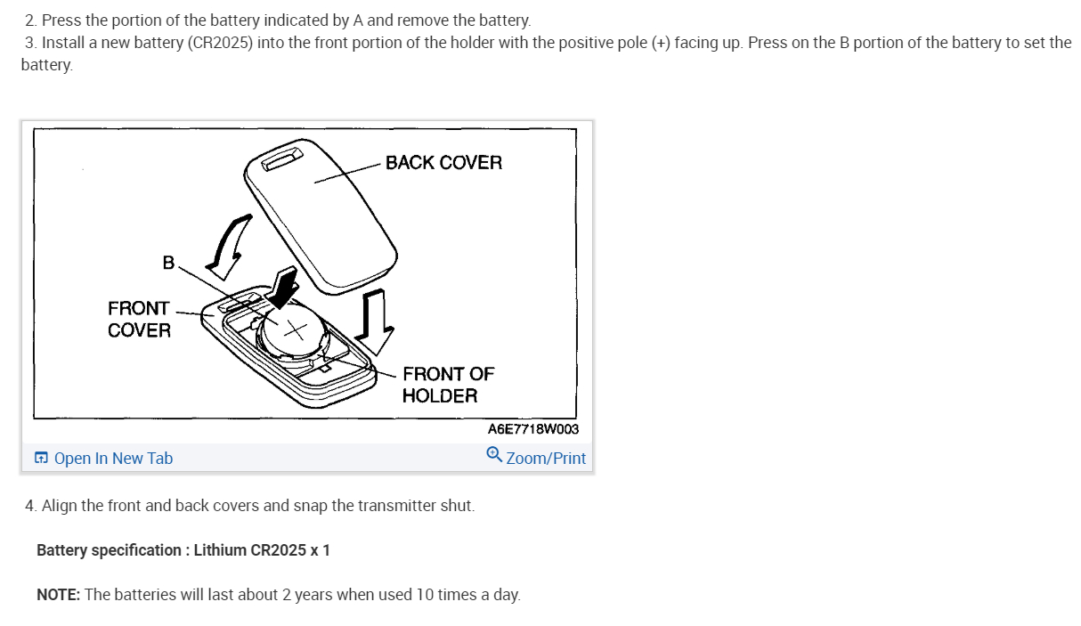

Here are instructions and diagrams to show you how to replace the battery in your remote. Check out the diagrams (below). Please let us know if you need anything else to get the problem fixed.
