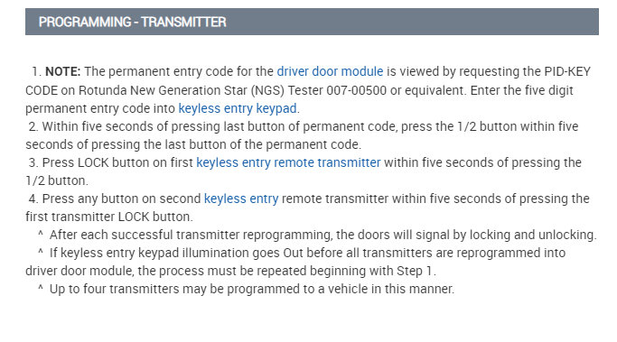

When I purchased the car listed above, they gave me two remotes but didn't work, and they were stolen from my house. so, i just got a new one and was trying to program it, but i had no luck finding the remote programming module. does anyone have an idea on where or how to program the new remote? Thanks in advance.

We do have the process for programing these from the manual.
However, here is a guide that will help with this process in general:
https://www.2carpros.com/articles/how-to-re-program-a-key-remote-fob
However, it appears this vehicle is slightly different according to the manual.

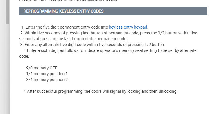

I included the process on how to program the keypad as well in case you need this. Plus, you are going to need this to program the transmitters.
Please see below and let us know what questions you have.
