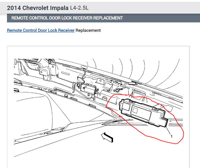

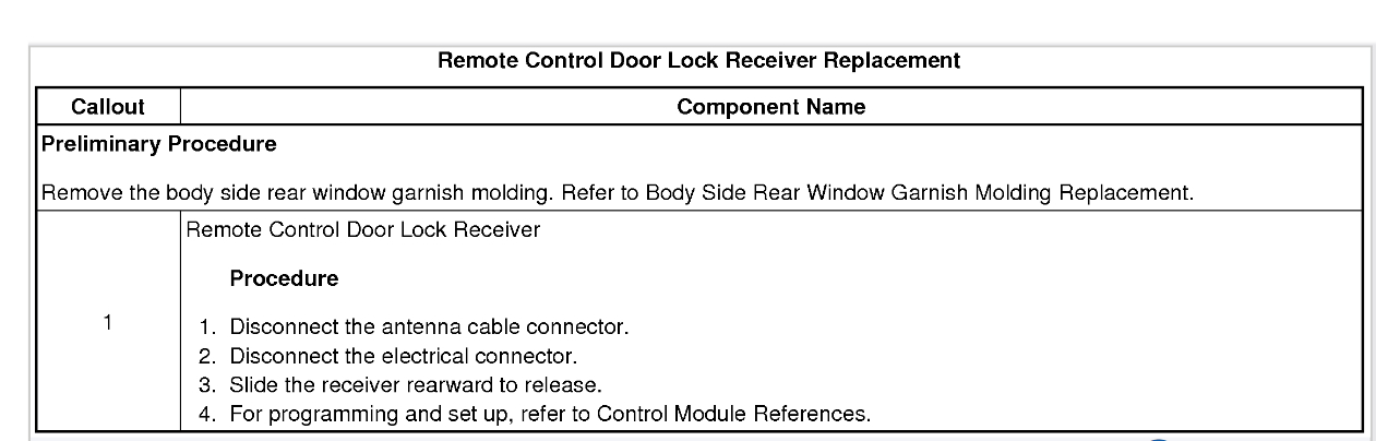

Hello, I’m having remote lock issues with my key fob only working at very close range. I already replaced the battery, and the problem persists. I read that it could be the Remote-Control Door Lock Receiver. Can any of you experts advise where is this located?
Jose
Jan 20, 2024 at 3:21 AM
  • 110,248 POSTS

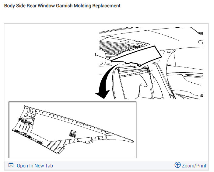

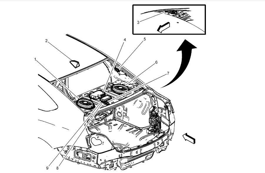

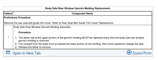

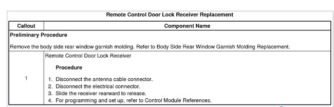

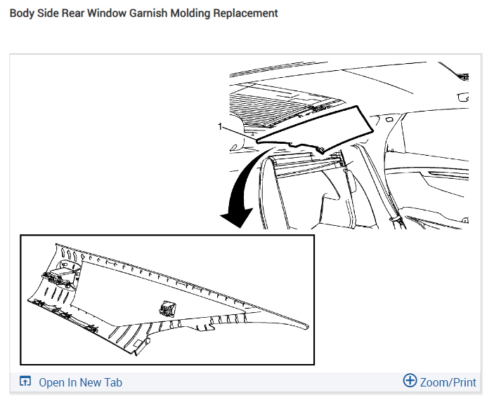

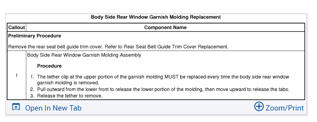

I attached a few pics below showing the location. If you want to access it, you need to remove the trim around the rear window. Note that you will need to have it programmed if it is replaced.
If you have a different FOB, check to see if it does the same thing. It's odd for the receiver to fail.
Let me know if this helps.
joe

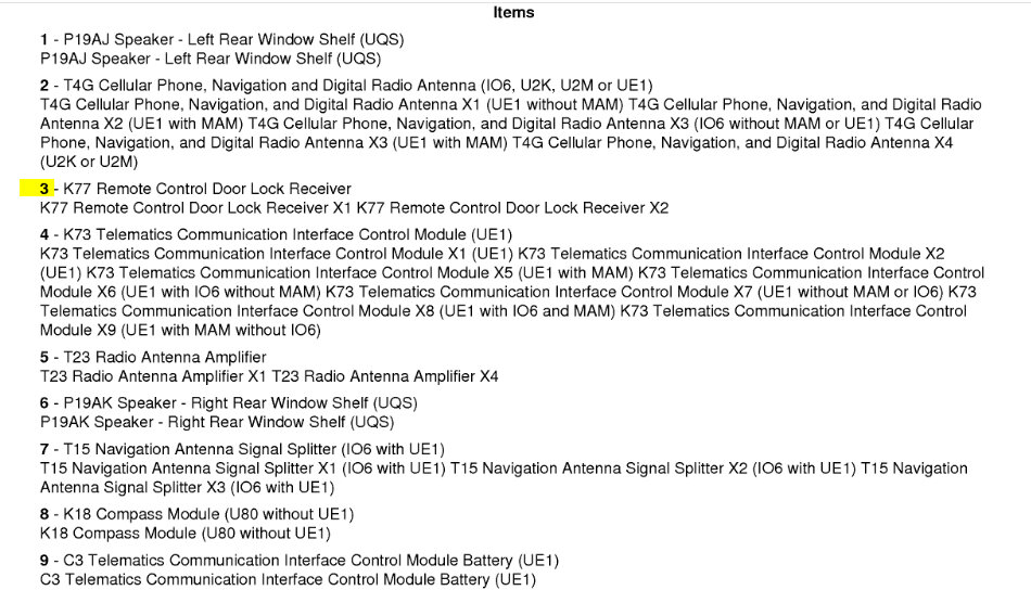

See pics below. Note: See number 3 in the first picture. The last two pics explain how to remove the rear garnish around the window.
