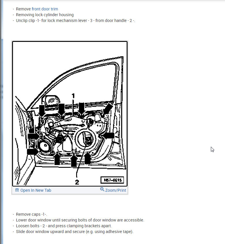

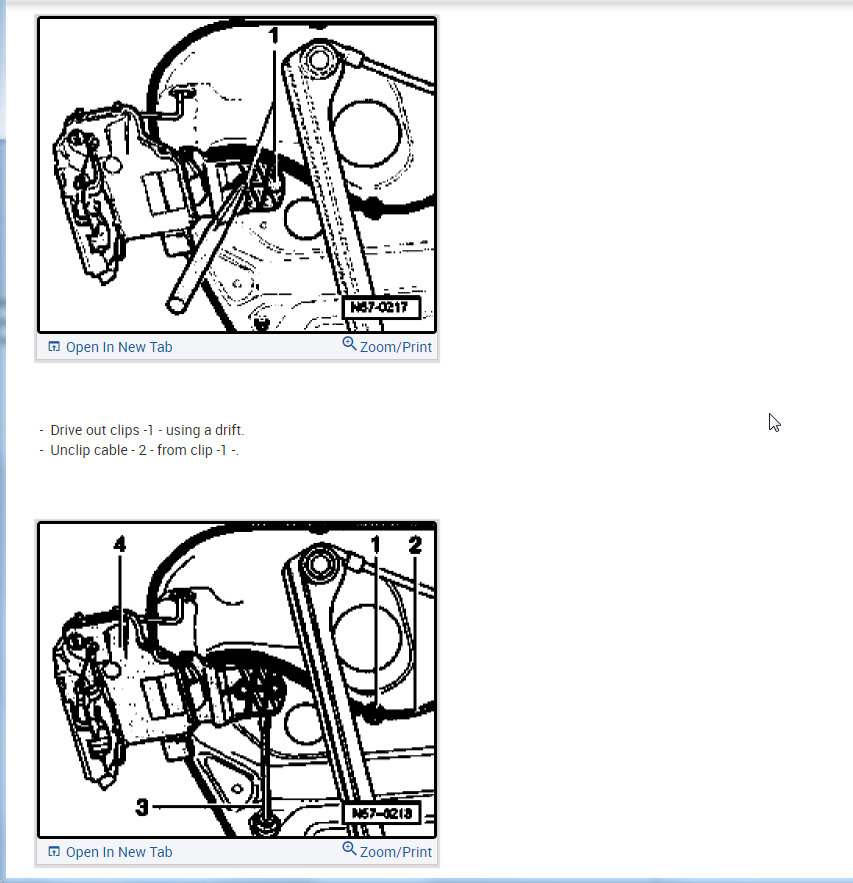

When i lock the doors of my car with remote one of the doors pops back up and unlocks itself. I have to open the door and push it back down for it to be closed when i leave the car on the street. What do i have to change or check to repair it, so the door stays locked when i lock the car with remote? Thanks
Dec 15, 2020 at 9:08 PM

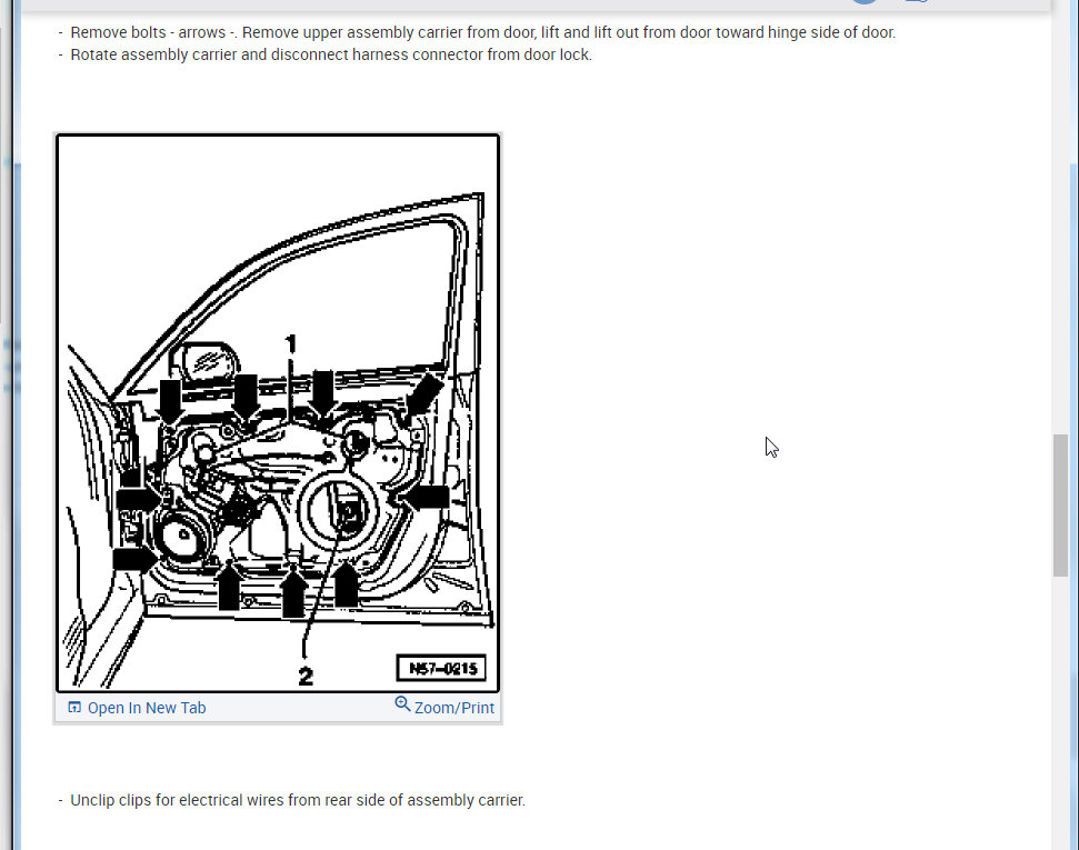

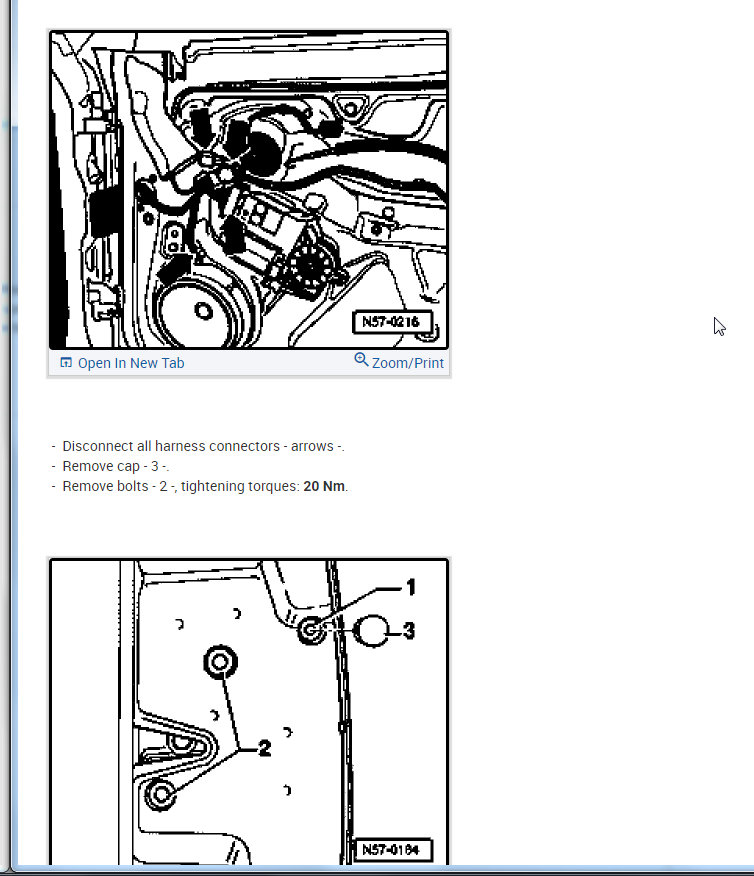

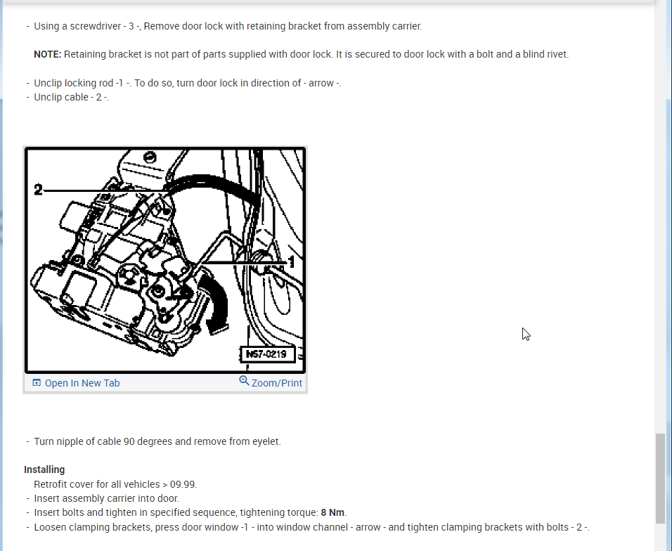

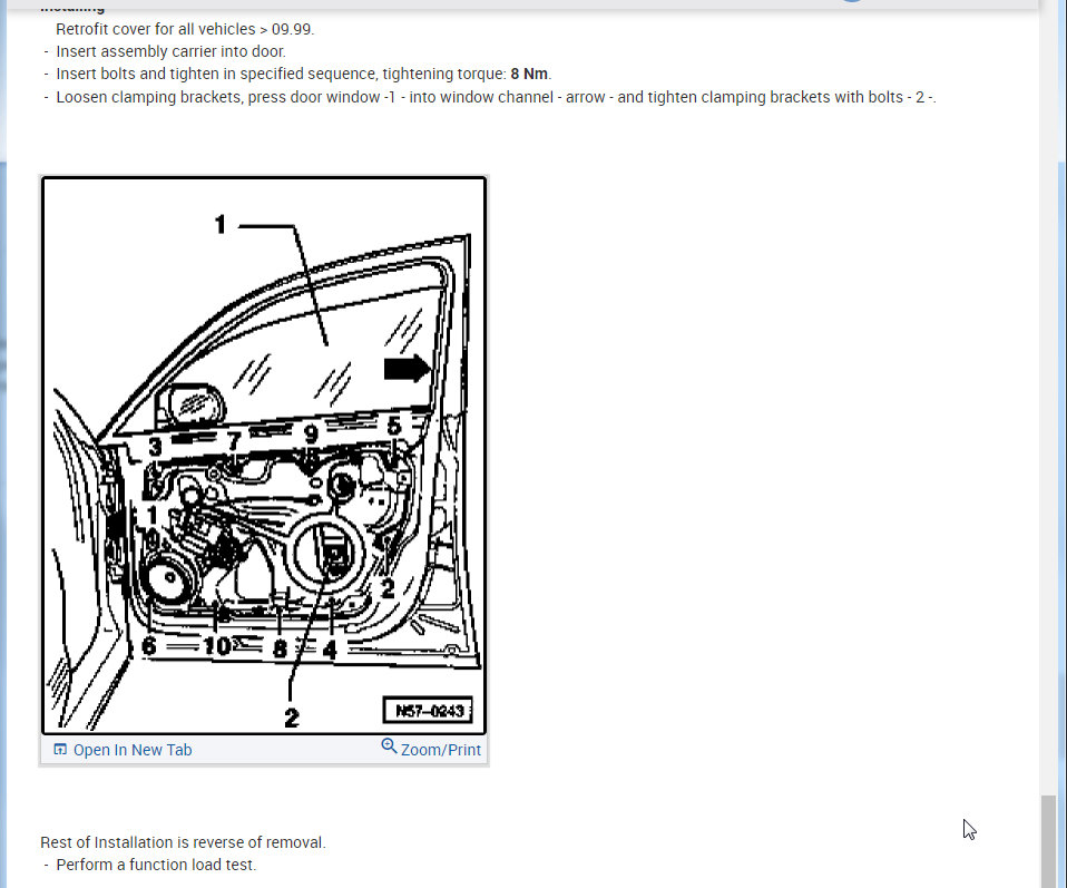

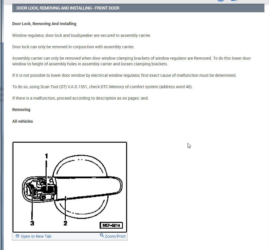

More then likely this actuator is failing. I am attaching the process on how to replace this but can you get a video of this just so we can see what it is doing?
There may be a chance that this is unlocking the door for a reason so seeing what the lock is doing will help us tell what could be happening.
Here is a guide that will help with removing the door panel:
https://www.2carpros.com/articles/door-panel-removal
Let us know what questions you have and if you can get a video. Thanks
