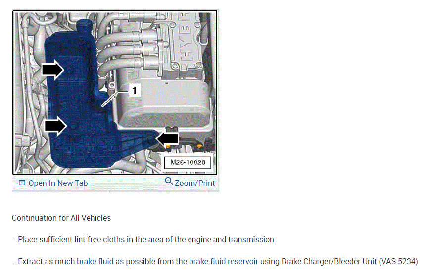

My car has a brake warning light on they say I need a brake master can you help me please?

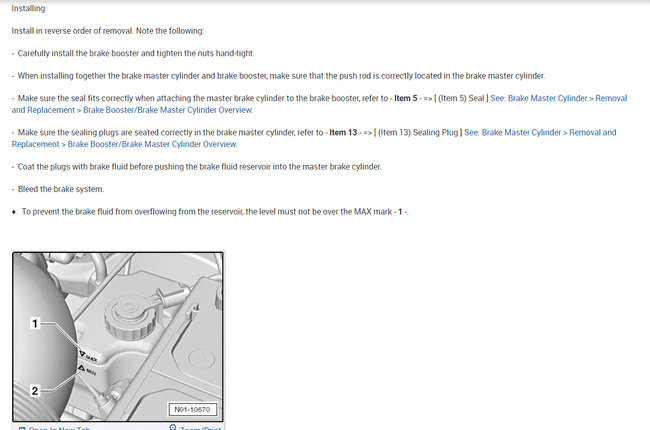

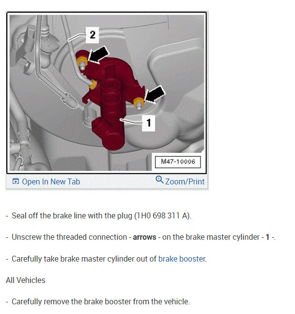

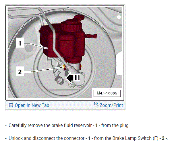

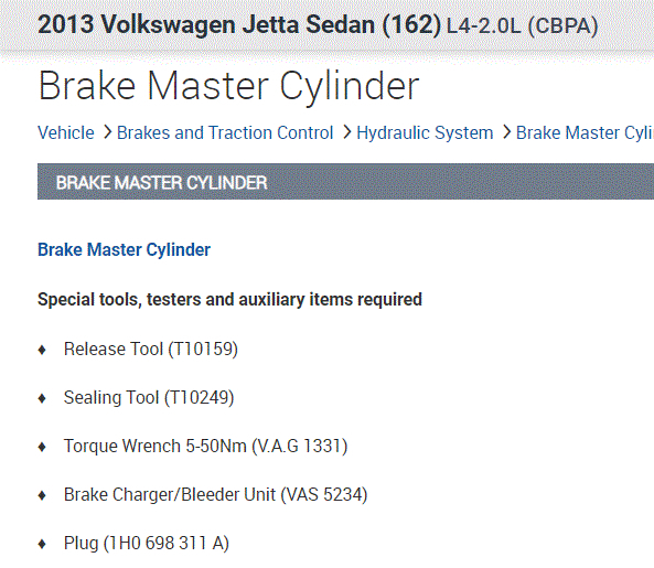

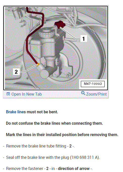

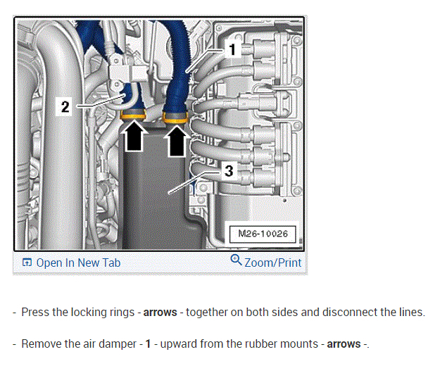

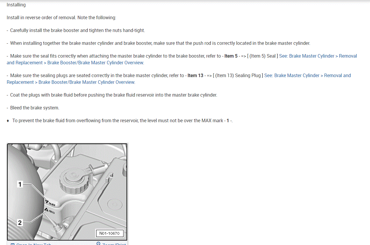

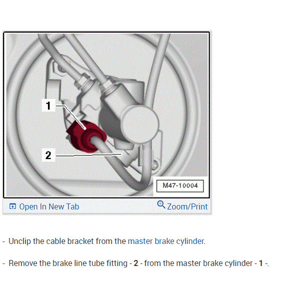

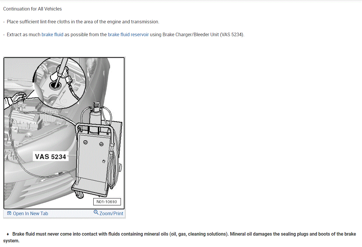

Replacing the brake master cylinder isn't too hard of a job. One thing I suggest is to get a new one that has a lifetime warranty. That way if it fails in the future, you don't have to pay for a new one again.
To get you started, here is a link that shows the procedure in general. You will have to bench bleed the new master cylinder prior to installing it. I will provide a video showing how that is done.
https://www.2carpros.com/articles/how-to-replace-a-brake-master-cylinder
Here is the video:
https://youtu.be/WDxvEQrMkBg
__________________________

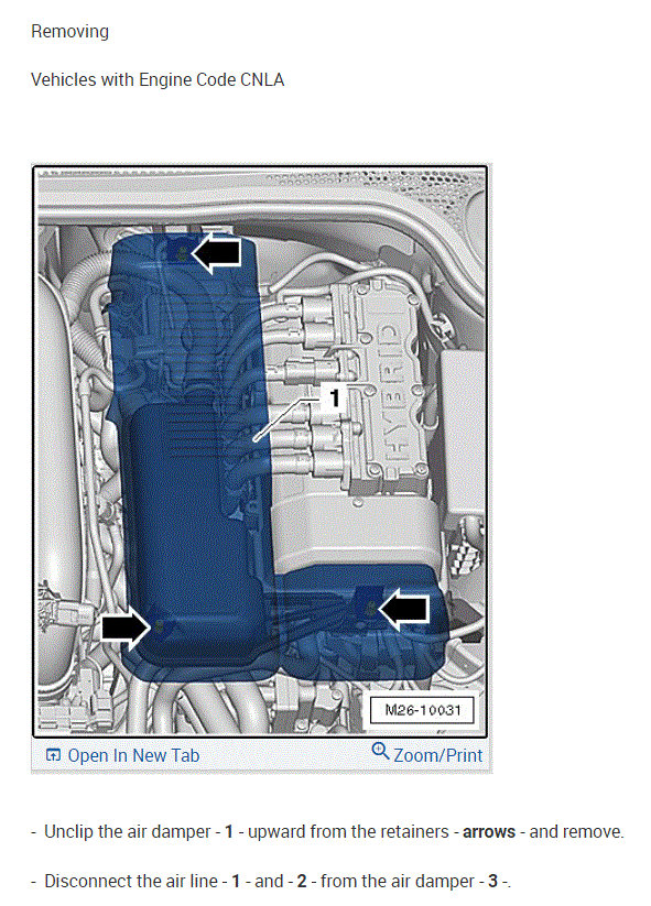

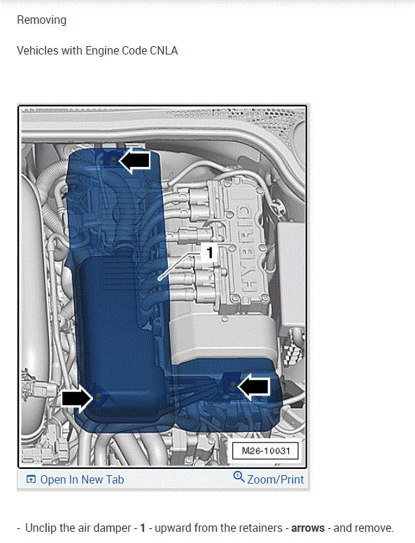

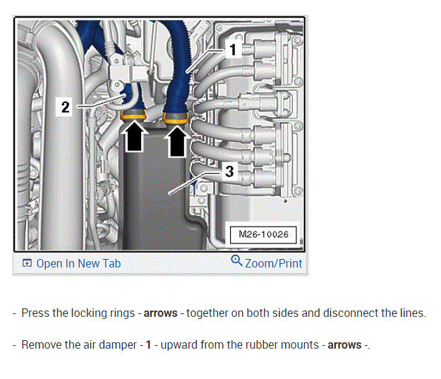

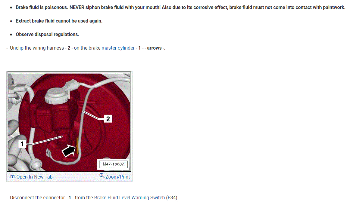

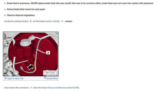

If you look at the attachments below, they provide the directions and pics specific to your vehicle for removal and replacement of the master cylinder.
