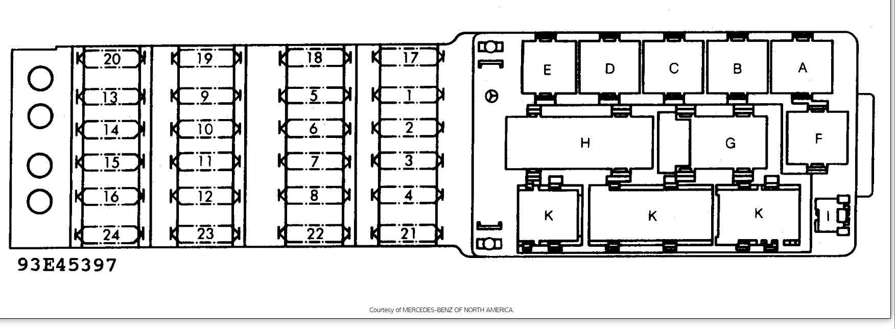

relays in fuse box
1986 MERCEDES BENZ 300E
132,000 MILES • 3.0L • 6 CYL • RWD • AUTOMATIC
SHAR1
need to know what relays are for and diagram.

Fuses
1 - 8 Amp - Glove Box Light & Radio, Cigarette Lighter & Rear Defogger, Rear Head Restraint System
2 - 16 Amp - Wipers & Washers, Headlights, Power Windows & Seats
3 - 8 Amp - Park, Tail, & Side Marker Lights, Warning System & Instrument Illumination, Headlight Wiper & Washer
4 - 8 Amp - Foglights
5 - 8 Amp - Courtesy Lights & Clock, Gauges & Warning Indicators, Cruise Control & Tachometer
6 - 8 Amp - Horns, Hazard Lights & Warning System, Gauges & Warning Indicators, Clock & Tachometer
7 - 8 Amp - Auxiliary Fan & Engine Overload Protection, Automatic Climate Control
8 - 8 Amp - Auxiliary Fan & Engine Overload Protection, Automatic Climate Control, Back-Up Lights
9 - 8 Amp - Gauges & Warning Indicators, Clock, Radio & Tachometer, Warning System, Courtesy Lights & Power Seats
10 - 25 Amp - Turn Signal Lights & Rear Defogger, Wipers & Washers
11 - Blank
12 - 25 Amp - Automatic Climate Control (Blower Control)
13 - 8 Amp - Headlights (Left Low Beam)
14 - 8 Amp - Headlights (Right Low Beam)
15 - 8 Amp - Headlights (Left High Beam)
16 - 8 Amp - Headlights (Right High Beam)
17 - 16 Amp - Central Locking System & Heated Seats, Rear Head Restraint System & Sliding Roof
18 - 8 Amp - Outside Heated Mirrors
19 - 8 Amp - Automatic Antenna & Courtesy Lights
20 - 16 Amp - Auxiliary Fan
21 - 25 Amp - Power Seats, Seat Motors & Memory
22 - 25 Amp - Power Seats & Telescopic Steering Column
23 - 16 Amp - Power Windows (Left Front & Right Rear)
24 - 16 Amp - Power Windows (Right Front & Left Rear)
Relays
A - Power Seats
B - High Speed Auxiliary Fan
C - Auxiliary Fan
D - Headlight Washer
E - Auxiliary Fuse Holder
F - Power Windows
G - Blank
H - Combination Relay
I - Power Seat Diode
K - Exterior Light Failure Monitor
(Diagram BELOW)
