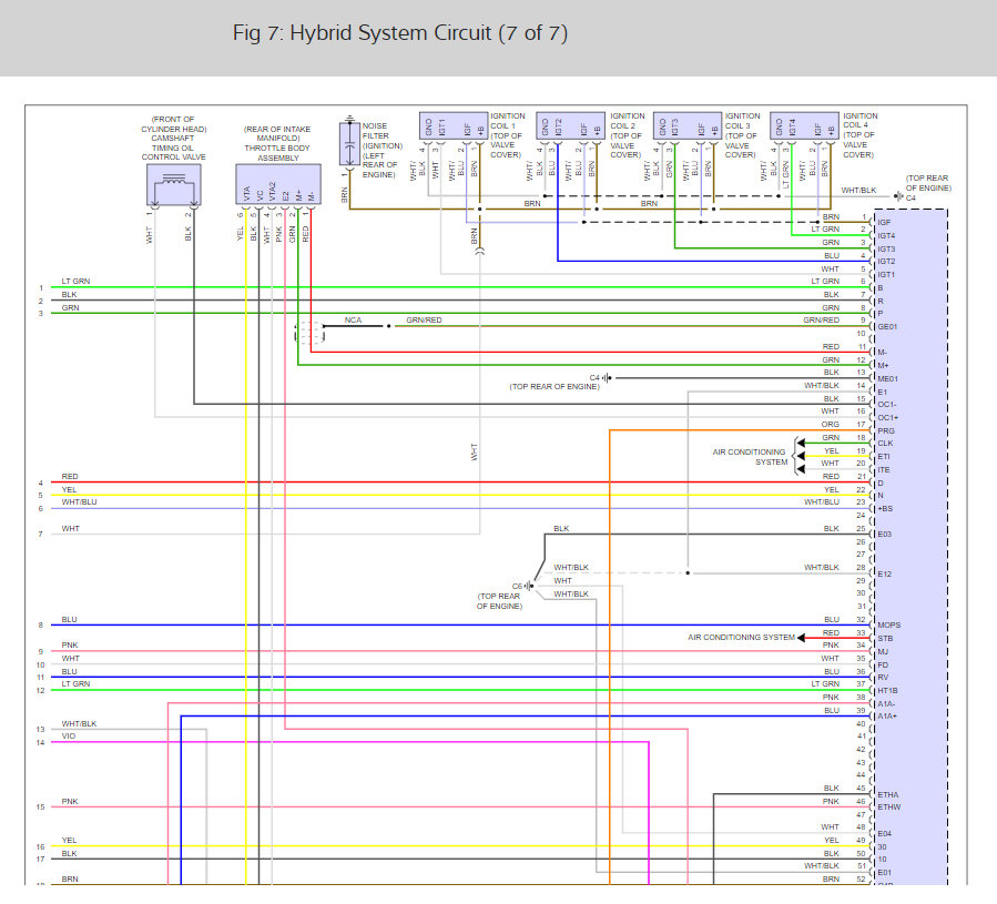

wiring diagram needed for the fuel system relays and fuel pump
255,000 MILES • 2.4L • 4 CYL • FWD • AUTOMATIC
JOE1953
  • 809 POSTS

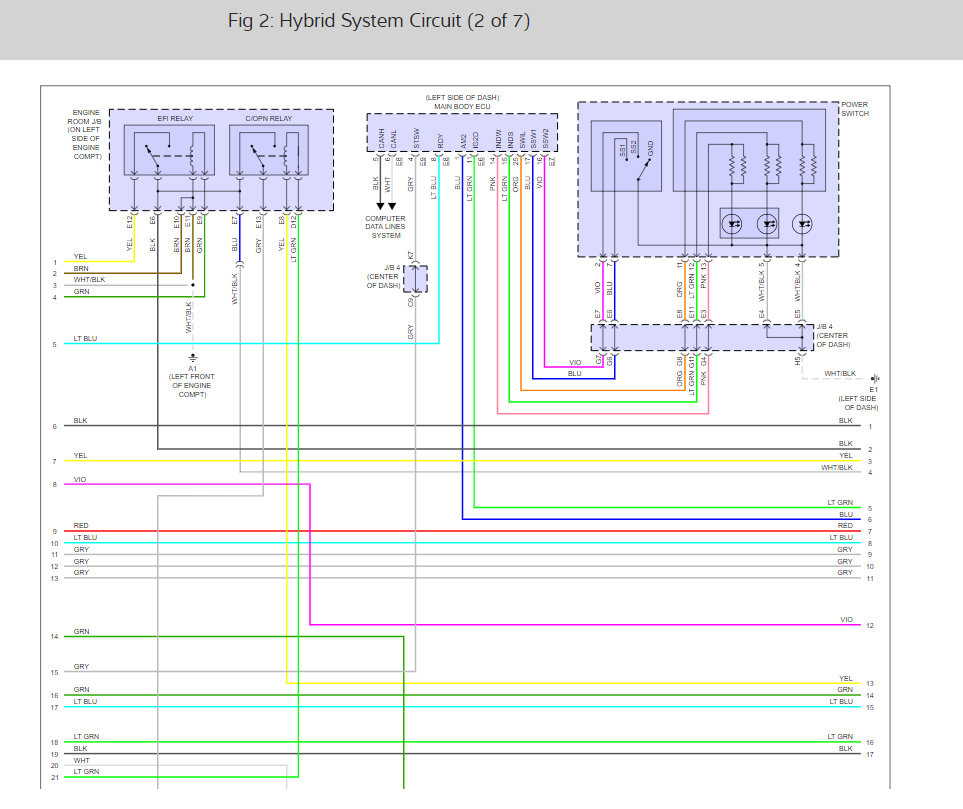

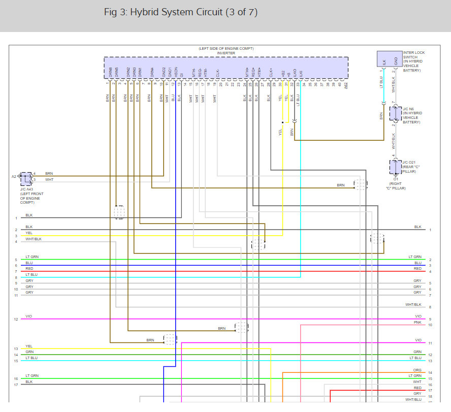

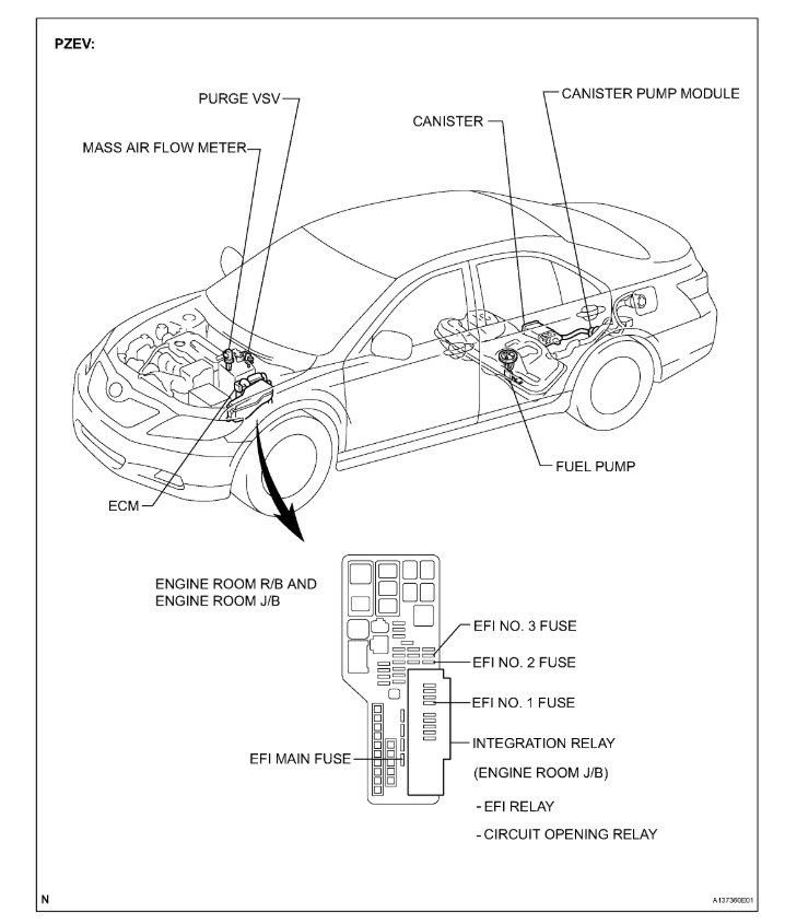

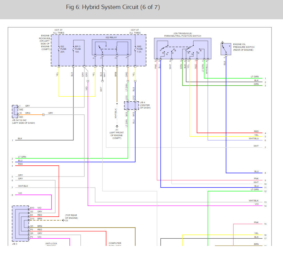

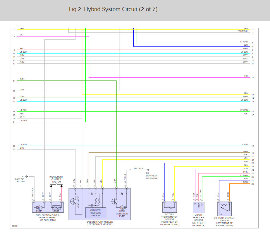

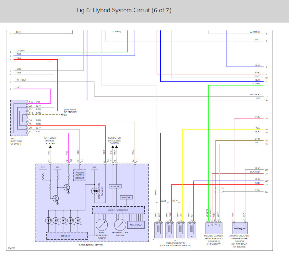

does this car have two relays for the fuel system a main relay and fuel pump relay? where are they located? I am not sure i have located them yet to check them. can you send me a wiring diagram on the relays and fuel pump? dose this car have a fuel pump check connector? if so can i jumper wire it to see will fuel pump run?
Oct 25, 2016 at 5:50 PM
WRENCHTECH
  • 20,760 POSTS

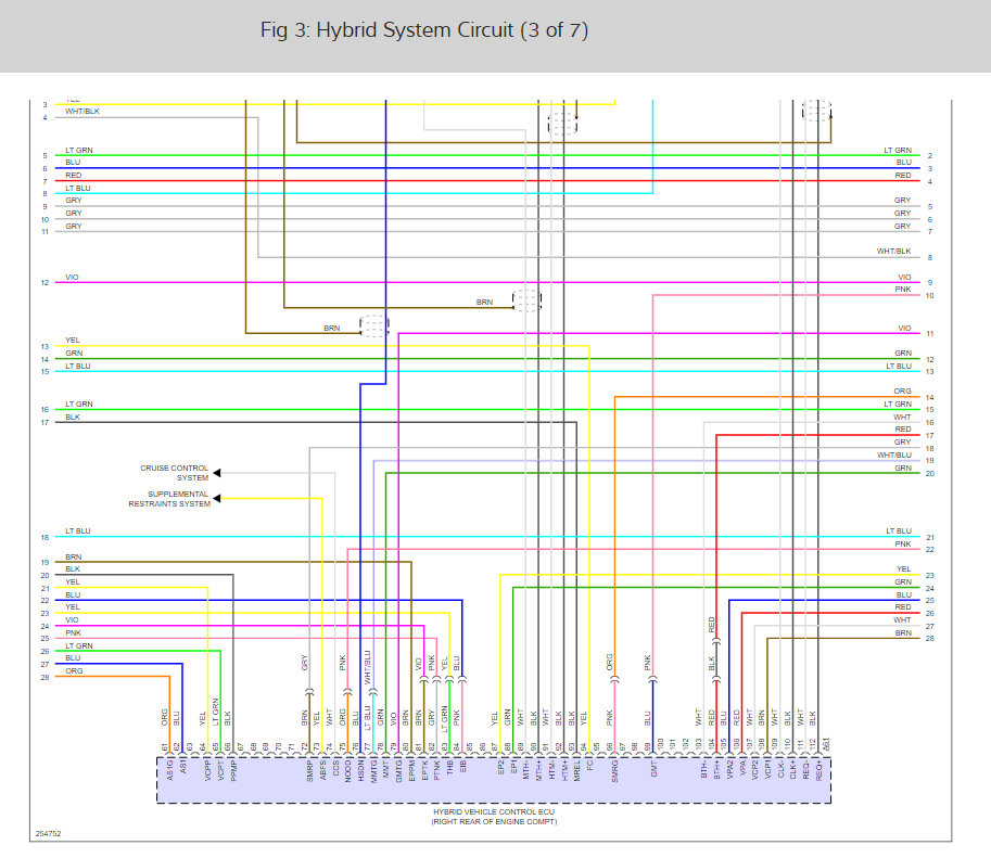

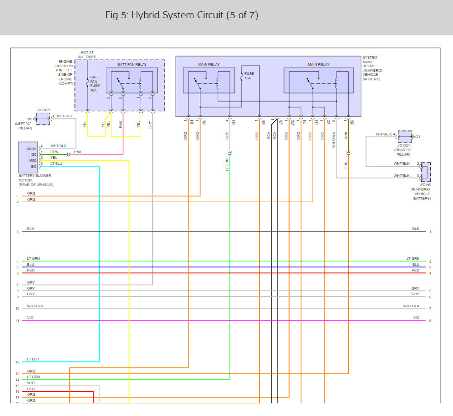

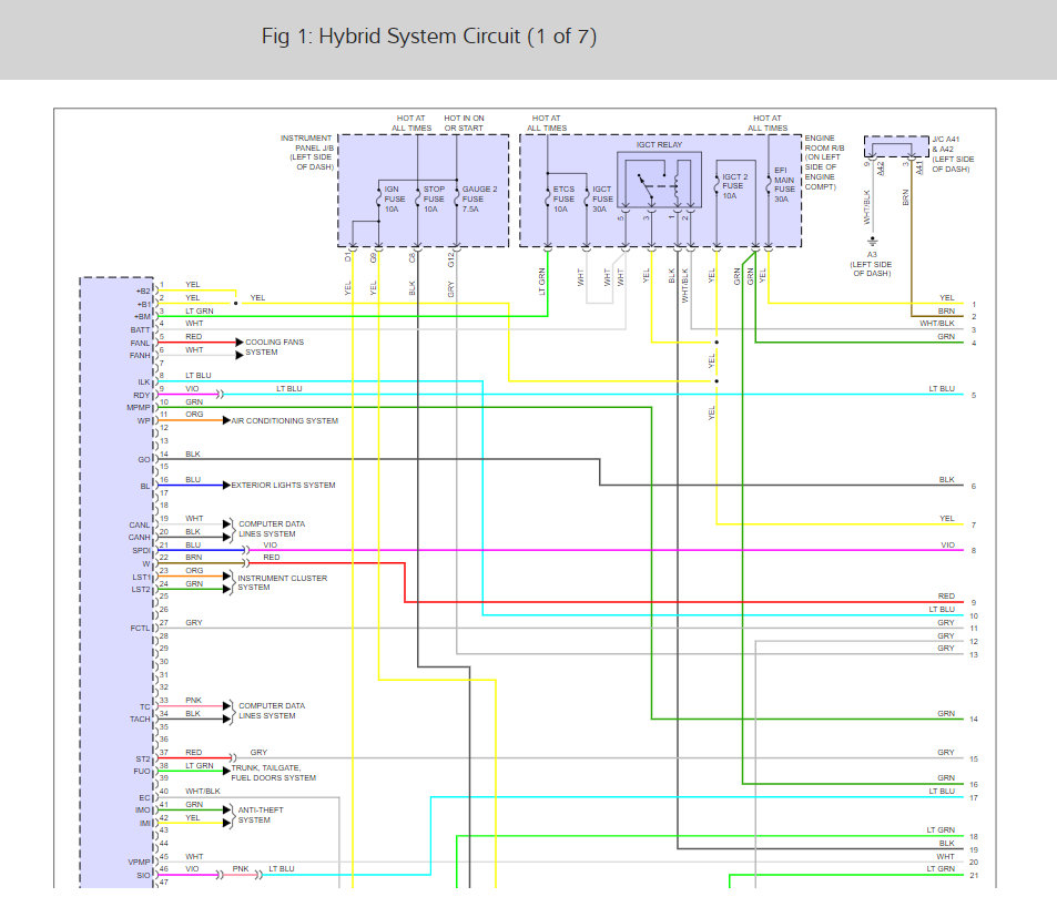

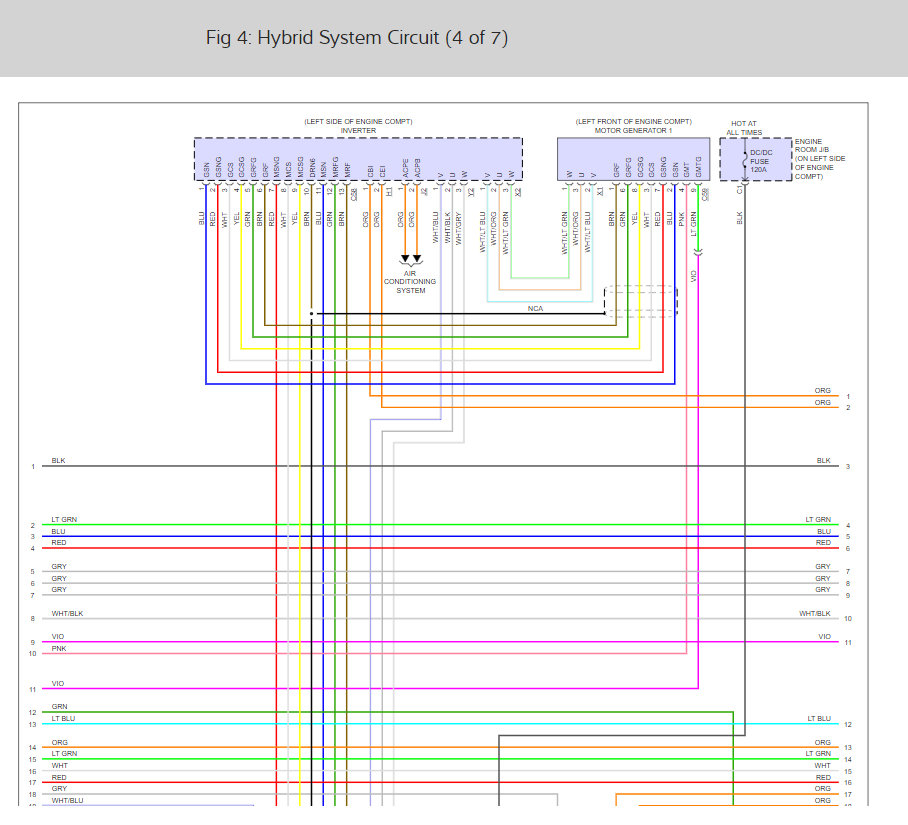

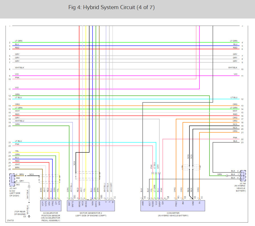

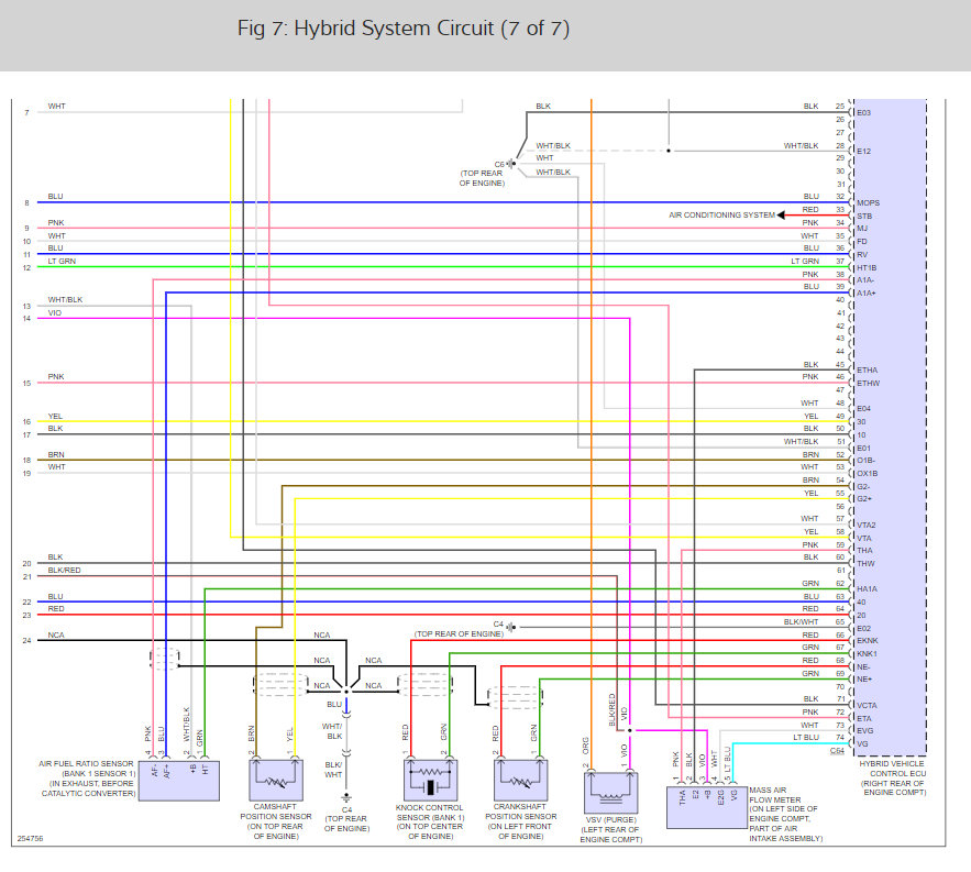

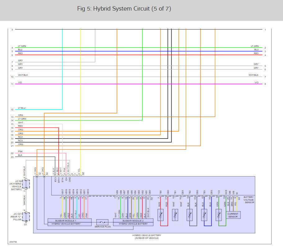

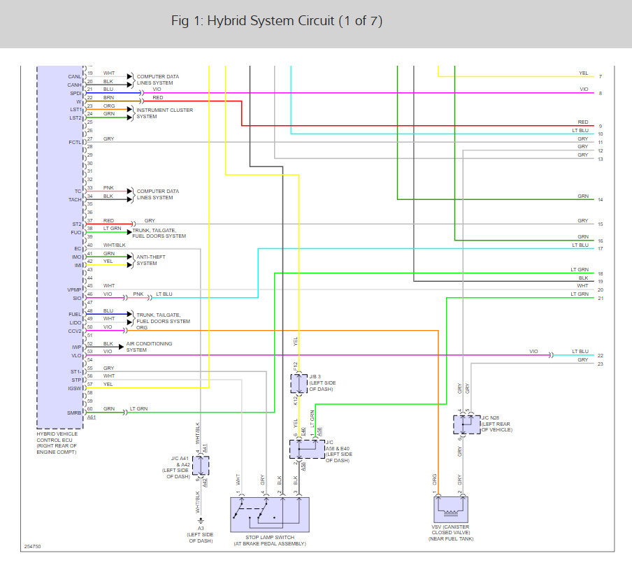

Here are the engine and fuel pump wiring diagrams and a guide to help you check the connections. in the images below as well.

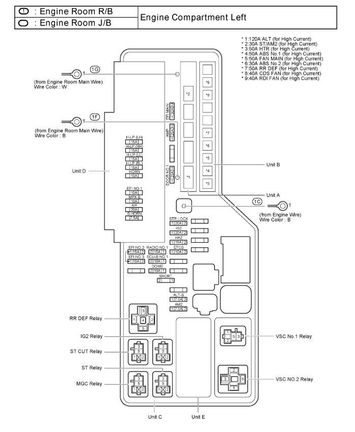

the relays i found under the hood near the battery on the relay cover it show FAN NO.2
FAN NO.3
FAN NO.1
ST
IG2
ST CUT
RR DEF

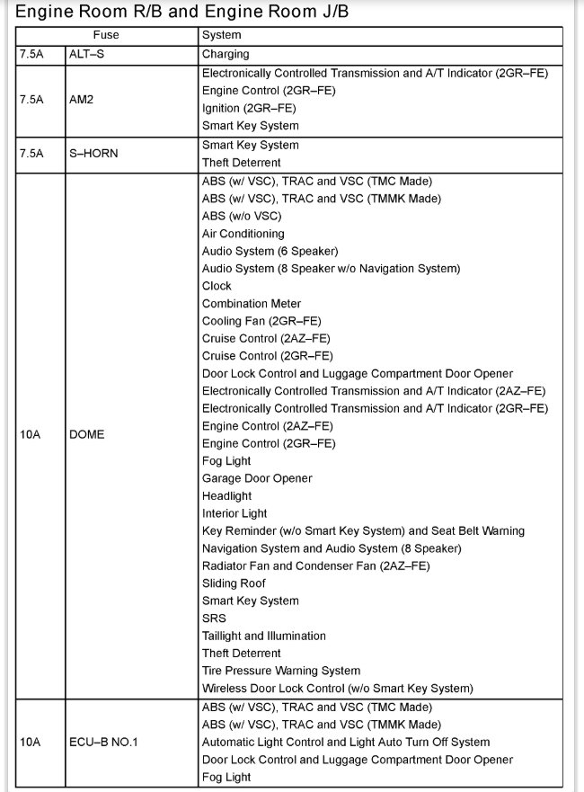

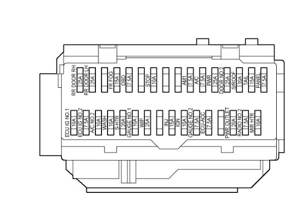

I do not see the fuel pump relay that say fuel pump relay or main relay unless it has another name.
Oct 26, 2016 at 2:34 PM
WRENCHTECH
  • 20,760 POSTS

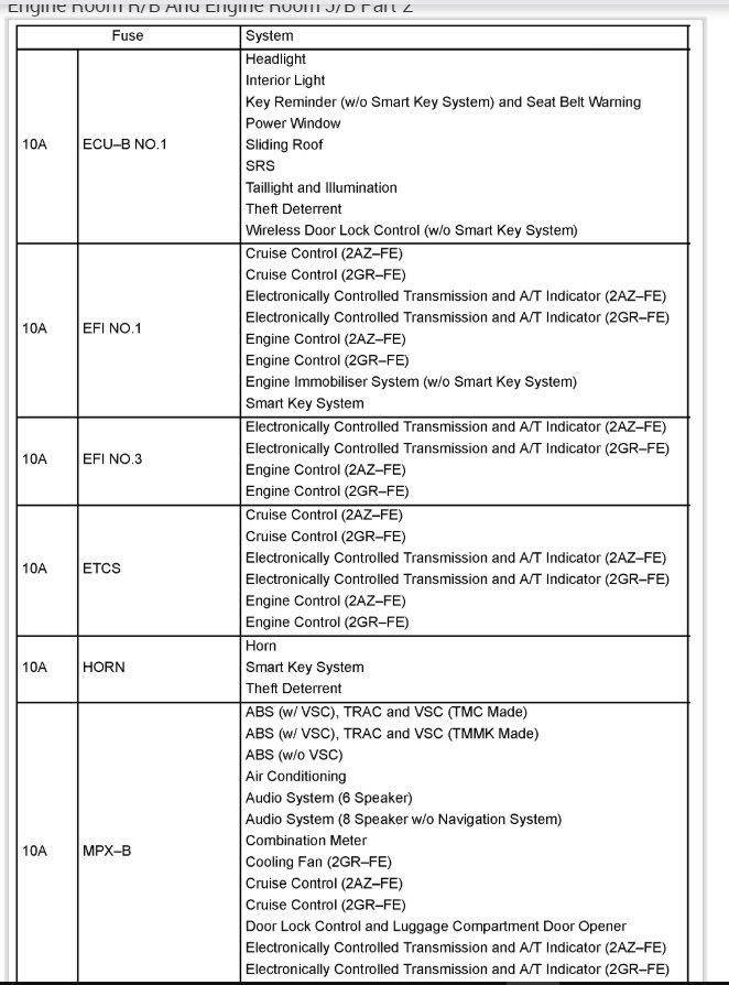

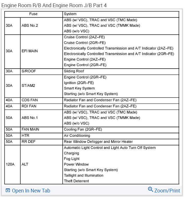

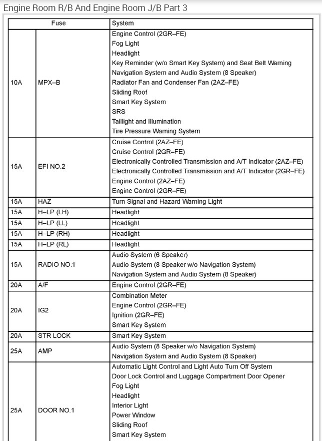

Toyota calls it a Circuit Opening Relay (C/OPN). (interrogation relay) Here is the fuse panel and relays locations for the car keep this in your favorites. Check out the diagrams (Below). Please let us know if you need anything else to get the problem fixed.
