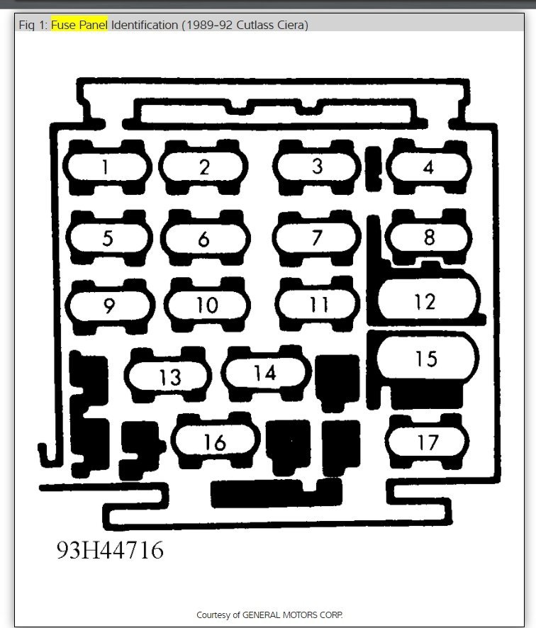

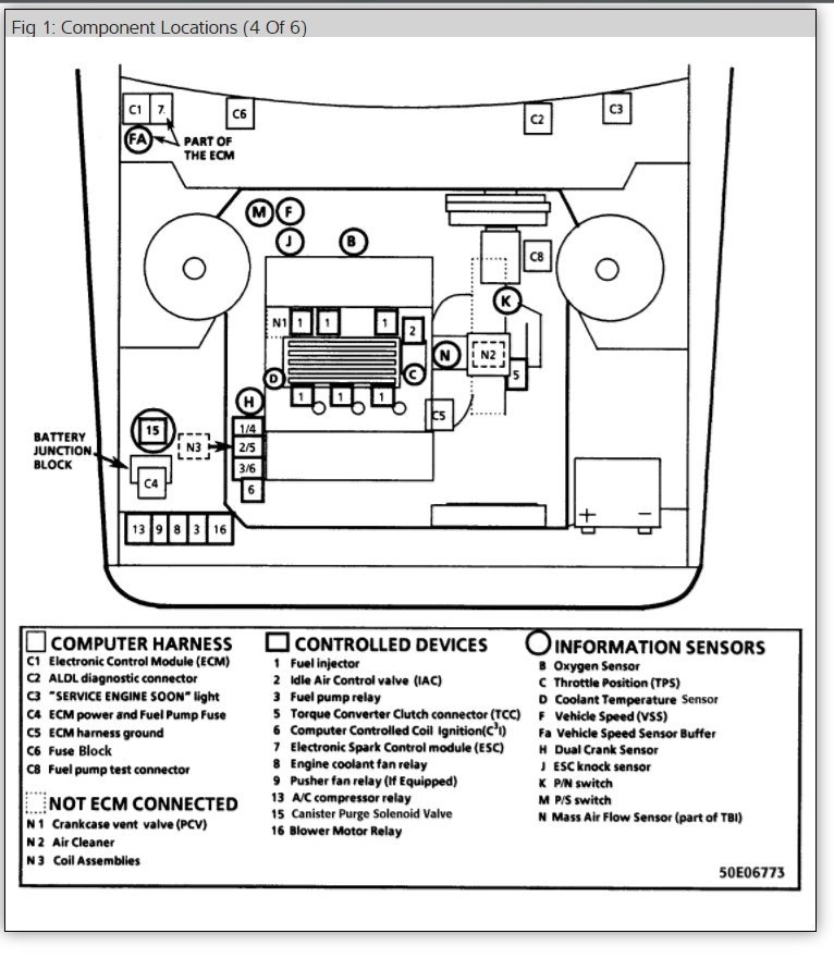

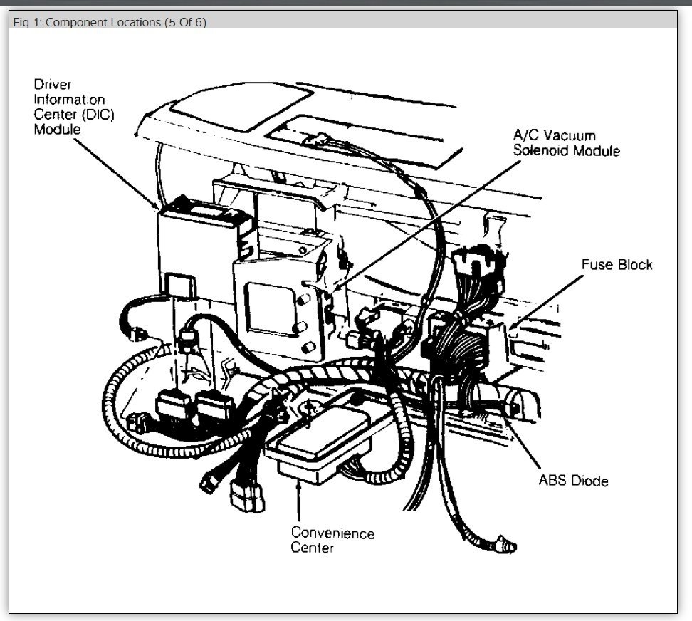

Need to know what the order of the relays.

Here is a diagram (below) of all of the relays and fuses so you can get the problem fixed.
1 - 15 Amp ECM Injectors (1989-90), Ignition (1989-90), ECM, MAF Sensor LG7)
2 - 20 Amp ECM Injectors (C3I & LG7), Coil (1992)
3 - 20 Amp (1989-90) 10 Amp (1991-92) Engine A/C Relay, EGR Solenoid, Canister Purge Solenoid
4 - 10 Amp Fan/Electrical, Heat Resistor (1989-90), Alternator, DRL Module
5 - 15 Amp Turn Signals, Back-Up Lights, Trunk/Tailgate Release (With Automatic Transmission), Fog Lights Relay (1989-90)
6 - Blank (1989-90) 15 Amp (1991-92) Remote Lock Control
7 - 20 Amp Tail, Park Lights, Side Marker, License Plate Light, Stop/Turn Signal
8 - 25 Amp (1989-92) Heater & Air Conditioner
9 - 10 Amp Gauges, Warning Indicators, Torque, Convert Clutch, Audible Warning, System, Computer Command Control, Trunk Release, BRAKE Warning, Indicator, Rear Defogger Switch, A/C Relay 1989-90), Speedometer,
10 - 20 Amp Stoplights, Hazard Flasher
11 - 20 Amp (Yellow) Interior Lights, Underhood Lights, Ashtray, Courtesy Lights, Instrument Panel, Trunk Lights, Passive Restraint (1989-91), Door Locks, Horn Relay
12 - 30 Amp (Circuit Breaker) Tailgate Release, Power Windows, Sun Roof (1989-90), Rear Wiper/Washer (1989-90),
13 - 5 Amp Illumination Lights for: Instrument Panel, Radio, Pod Lights, Ashtray Console, Heater-A/C Control, Driver Info System 1989-91), Defogger Switch, Foglights Switch (1989-90), Headlight Switch (1991-92)
14 - 10 Amp Radio, Cruise Control
15 - 15 Amp (Circuit Breaker) (1989-92) Seats, Door Locks, Rear Defogger, Rear Wiper (1989-91)
16 - 25 Amp Windshield Wiper/Washer
17 - Blank (1989-90) 20 Amp (1991-92) Seat Belt Light, Cigarette Lighter
