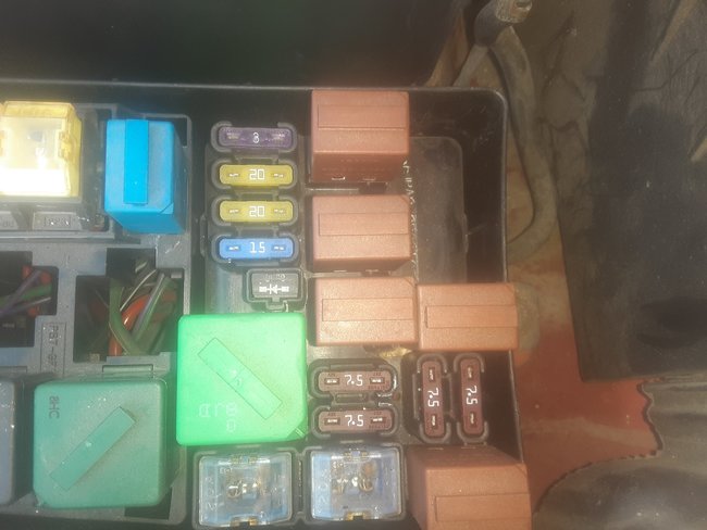

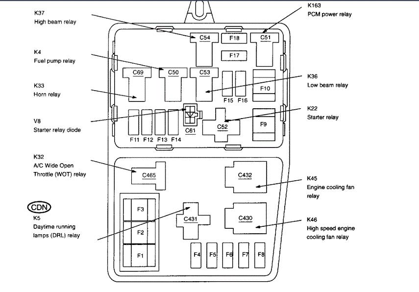

I changed my starter a few weeks ago and now my car isn't starting. I had a relative look at it and he said it's my starter relay. So he switch the starter relay (R7) with the high speed engine fan (R8) and it started right up. I looked in the manual I have and it doesn't tell me the amperage for the R1-15 or whatever to get to replace any of them. Are all of the same amperage, if not what is the amperage for the high speed engine fan so I can at least replace that one immediately?

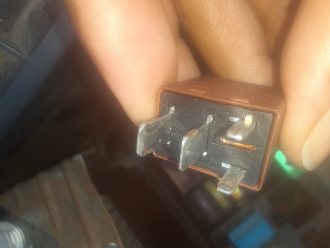

Thank you very much for the quick reply. Thank you for stating the need to switch them back. Those fuses do not match the female part on my vehicle. I attached a couple of photos to show you what it looks like. The relay I need has four prongs and it's the brown relays that you see in the photo.
Aug 10, 2020 at 12:33 AM
Both relays I attached are 4 prong relays.

The four prongs are not aligned the way the housing unit is. I thought this picture was on the other response. There are two that face each other length wise that are small. Then there are two width wise.

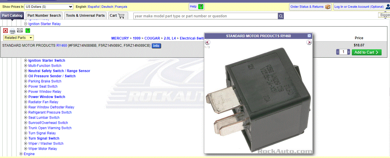

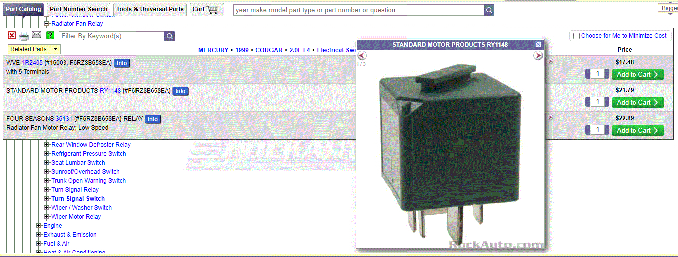

Where can I find these 70 amp relays that are designed the way I need them to be? I have checked almost every where for them.

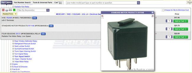

I guess this will be a needle in the haystack search. I checked all of them and the only ones they have like that are 20 amp and I need 70 amp correct. There's one on Rock Auto but it only states that the voltage is 12 2H, is that what I need.
Aug 10, 2020 at 6:09 AM
Correct. The voltage is correct for the fuse.
Get the one from rock auto.

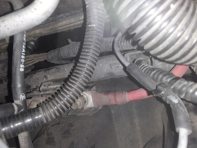

So I finally found the relay I needed but my car doesn't want to start. I played around with the wires from the alternator to the starter and it cranked up. I checked to see if anything was loose but can't find anything.

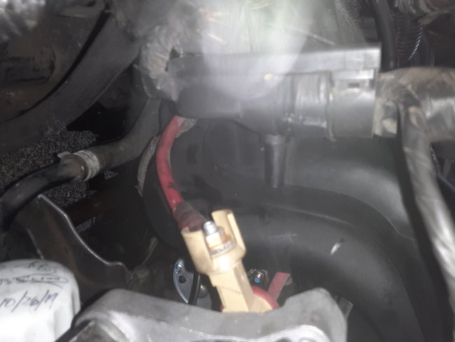

I got it to crank and it worked for a day, but the next day it wouldn't do anything.
Sep 3, 2020 at 1:34 AM
Did you grab the wires again as you did before?
Can you upload a picture of where you grabbed the wires?

When I tightened the red wires on the alternator and starter the car cranked. But it didn't crank the next time I did it.

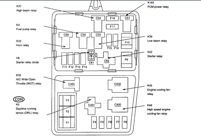

Okay, you have something in the harness that making the connection intermittently.
I attached a diagram for you.
Check the relay for power when it does not start. I am wondering if you are losing power to the control sod when it does not start from the ignition switch.
