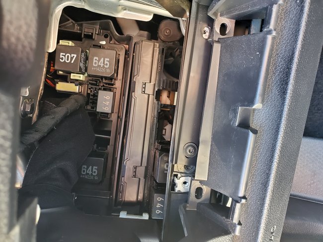

Trying to find out what these relays are for.

Where are the relays located in your vehicle?

They are located under steering column on driver side. I have been having issues find out why my low beams aren't working wondering if one of these could be the issue?

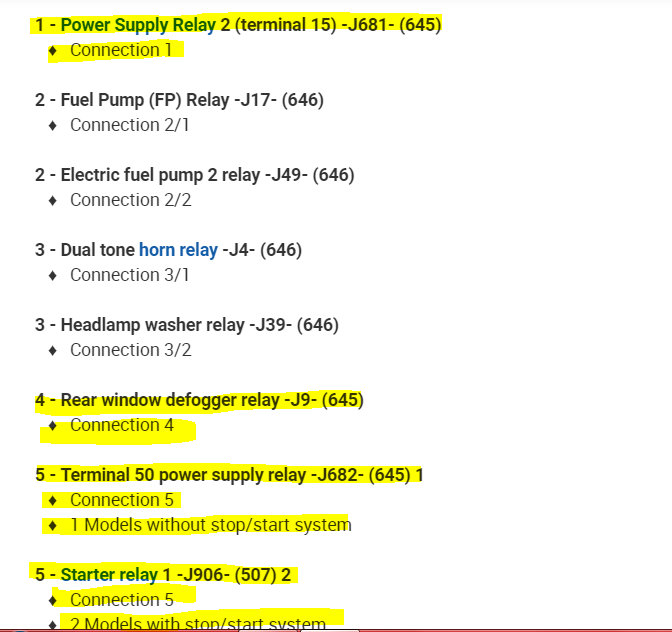

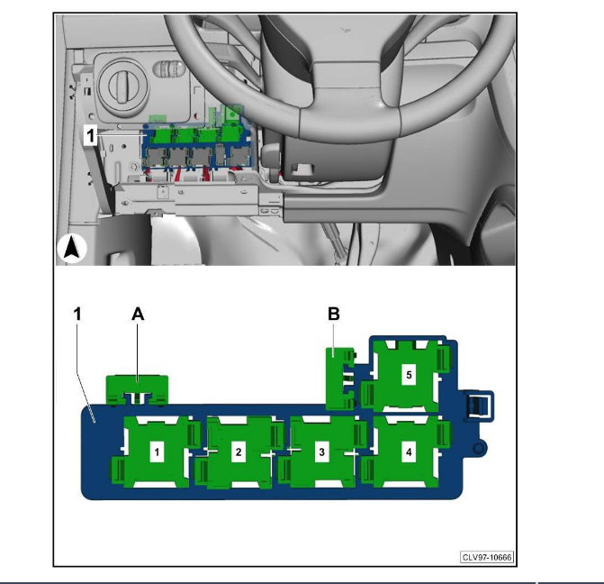

In the diagrams down below I have included a diagram of the relays in this fuse panel. Please go through them and get back to us with what you find.
