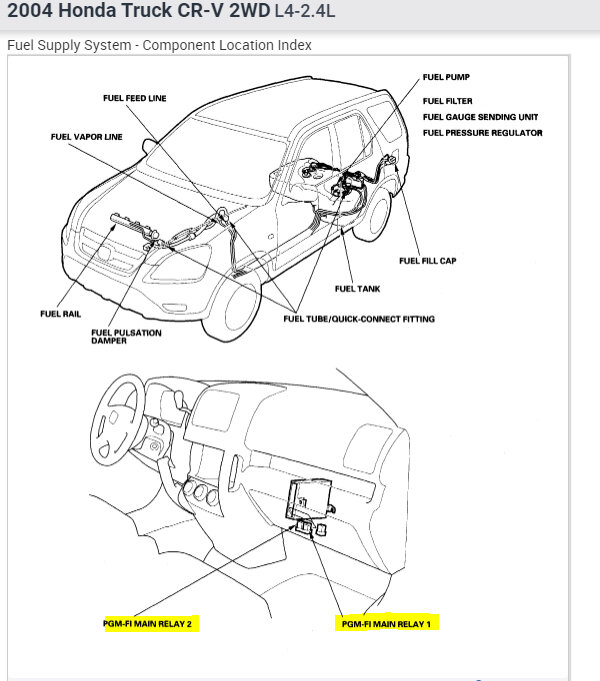

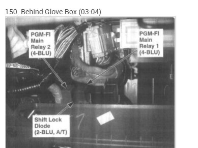

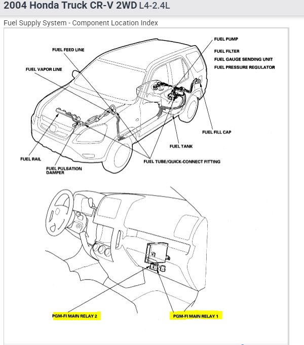

2004 HONDA CRV
2WD
AUTOMATIC
300,000 MILES
Relay switch location needed?
Friday, December 16th, 2022 AT 4:35 PM
3 Replies
SQM
MECHANIC
6,383 POSTS
The relay is located behind the glove box.
See attached diagrams.
Let me know if you have any questions.
