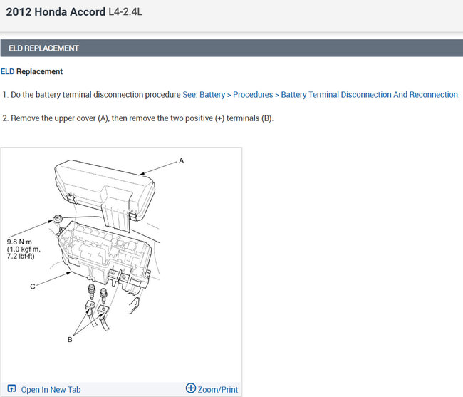

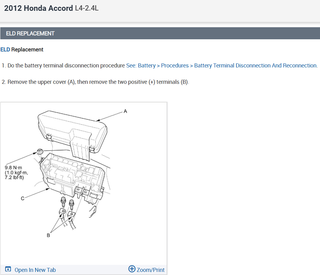

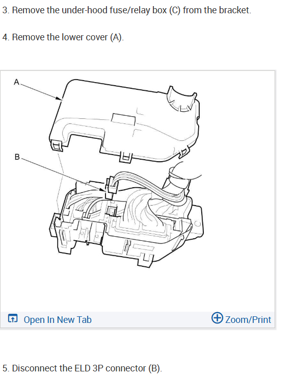

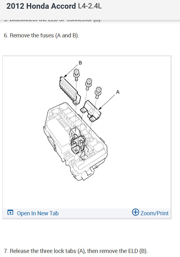

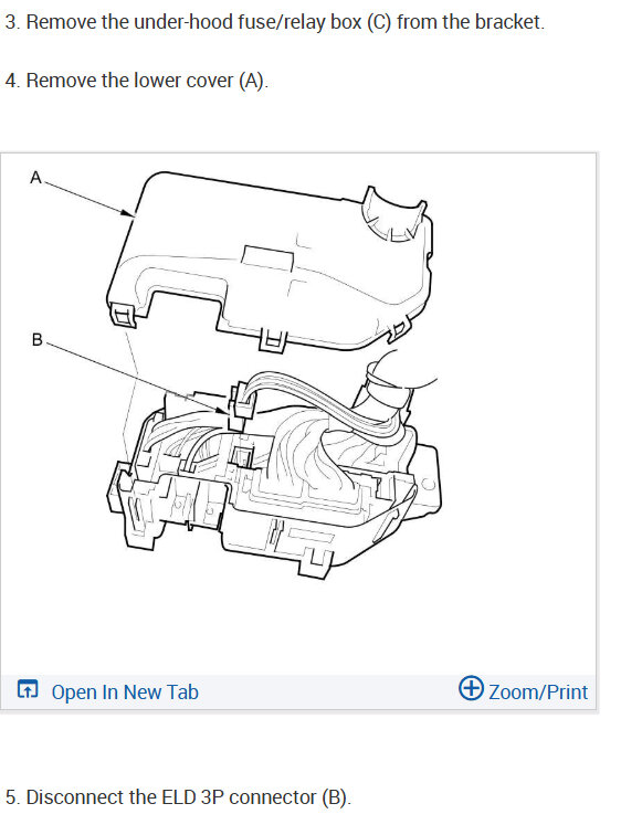

So this code is telling us the electric load sensor has gone out which is common with this code, here is how to replace it and I would clear the codes once the repair has been completed.
The P1658 diagnostic trouble code (DTC) typically indicates an issue with the Electric Load Detector Circuit.
