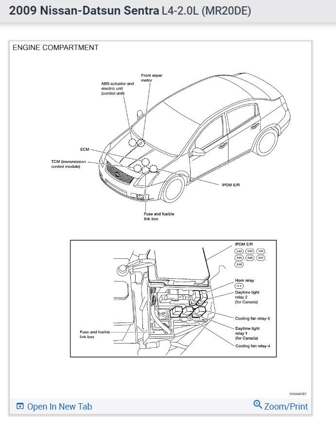

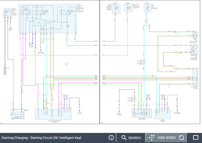

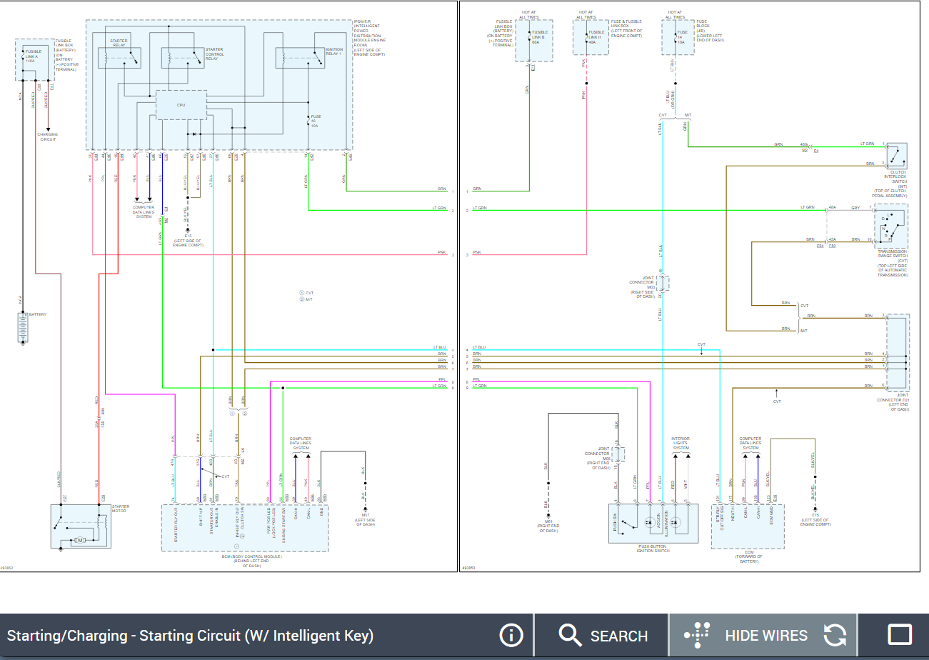

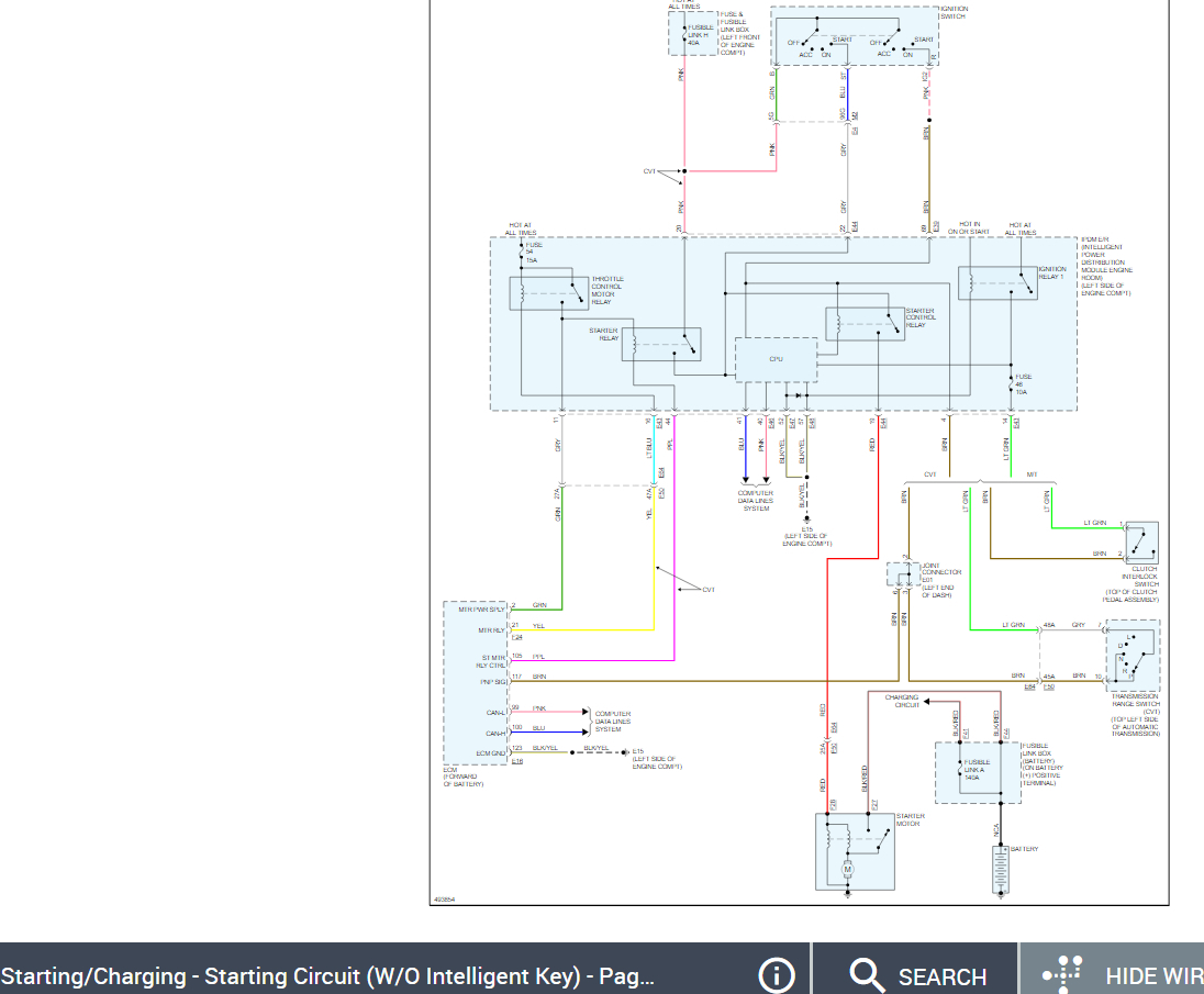

We bought this car used with 54,000 miles on it just under a month ago. On Saturday the car had trouble starting and we used push to start approximately 20-25 times before it started up. It was fine on Sunday and Monday but Tuesday morning and since then it refused to start. We picked up a replacement starter relay part but when we open the fuse box (?) inside the drivers side, we are unsure which plug should be replaced and some are behind a sort of metal shield.
Really trying to replace this ourselves versus pay for a tow, the parts and labor at the dealership.
Help!
Feb 13, 2019 at 8:19 AM
SCGRANTURISMO
  • 4,897 POSTS

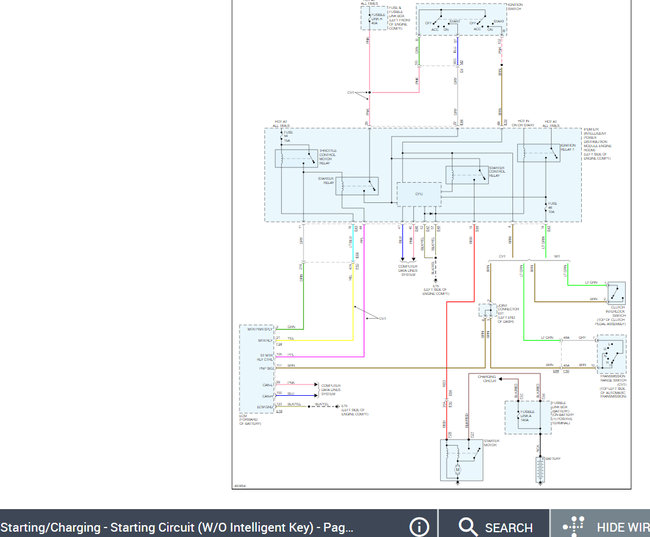

Engine starting system functions by controlling both starter relay and starter control relay. Both relays are integrated in IPDM E/R. Starter relay is controlled by BCM, and starter control relay is controlled by IPDM E/R on request from BCM. IPDM E/R transmits starter relay and starter control relay status signal to BCM via CAN communication. I have included for you in the diagrams below wiring diagrams with and without intelligent key options. Both have the location of the starter relay location on them. I hope this helps.
Thanks,
Alex

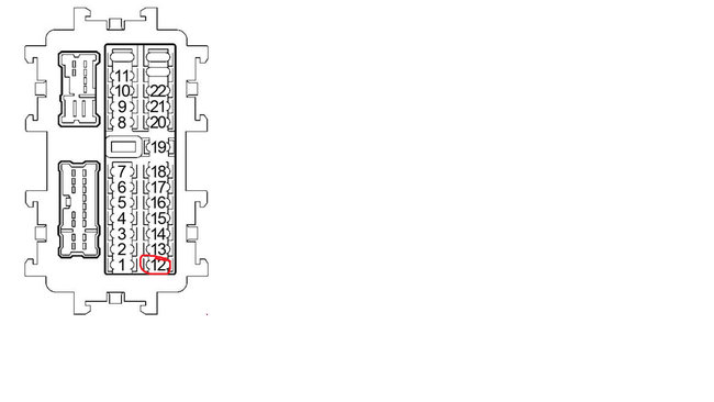

Hey SCGZ,
The starter relay looks like it is integrated into the intelligent front power distribution (IPDM E/R)
Another issue you could have is with the P/N safety switch.
The vehicle will not start unless it is getting a signal that it is in Park or Neutral.

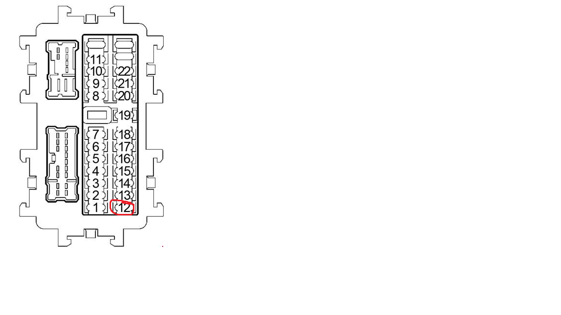

Can you please check fuse 12 in the interior fuse board, should be behind the dash on the left hand end.
If this is okay the easiest way to check switch function is with a scan tool check the status of the neutral safety switch.
Do you have access to a multi-meter?
The next stage will be to test what you have as values in/out of the integrated power module.
Regards, Joe
Dec 28, 2020 at 5:18 AM (Merged)
SCGZ
Just finished checking the fuse 12 and it looks okay. So if I was to replace the intelligent front power distribution (IPDM E/R), is that something I can purchase online and its like a plug and play? With a multi-meter how would i go about testing values in/out of the integrated power module?
SCGZ
This the fuse I pulled and checked.

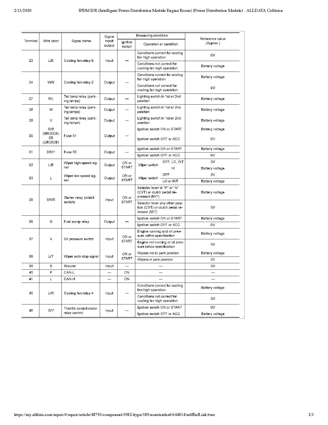

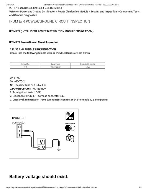

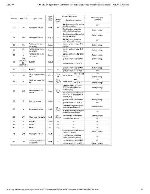

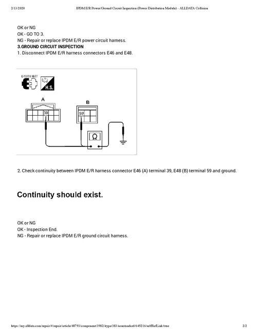

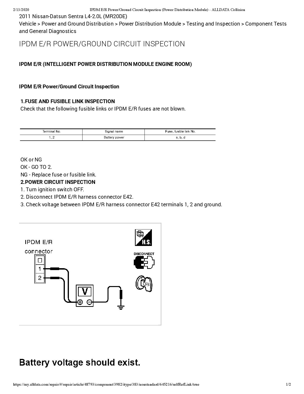

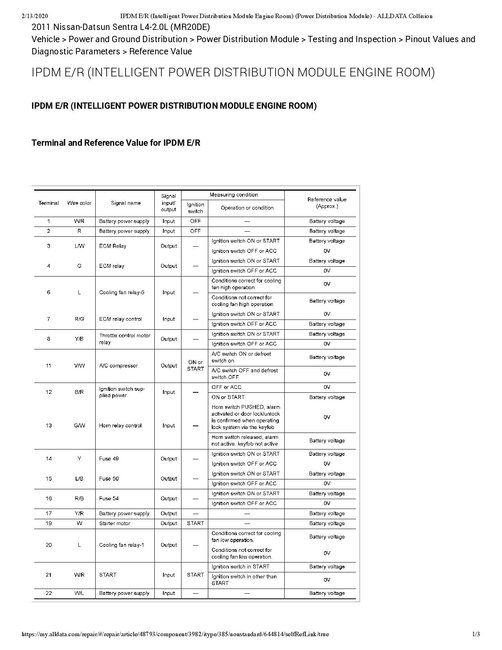

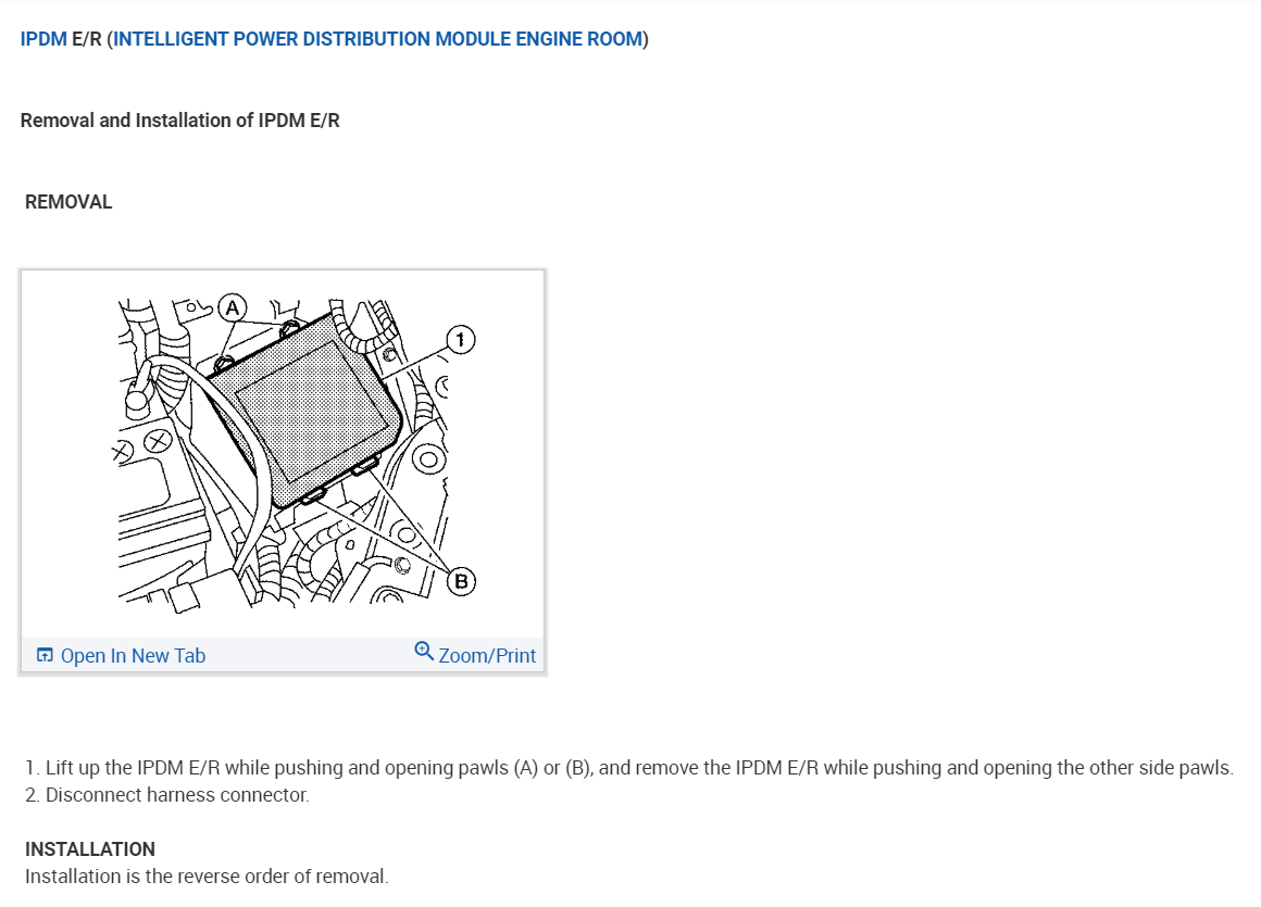

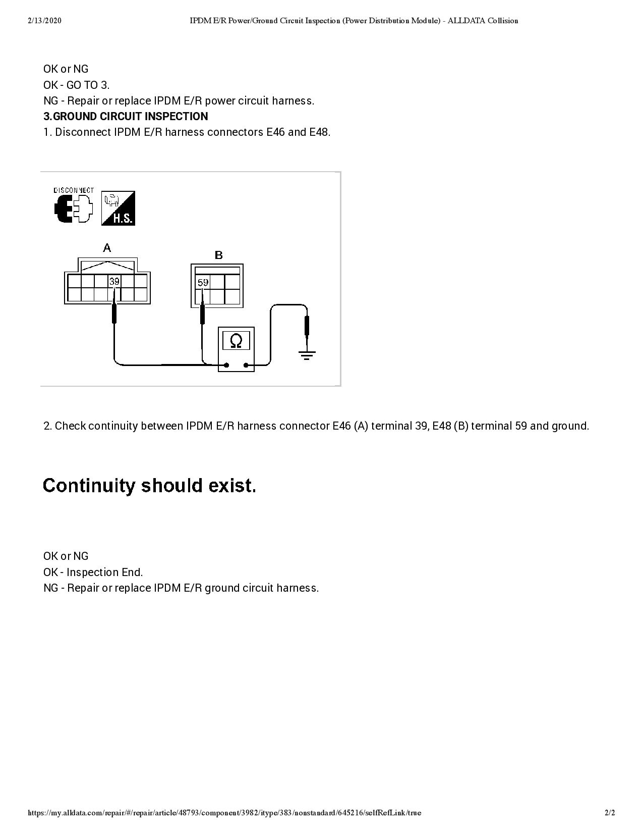

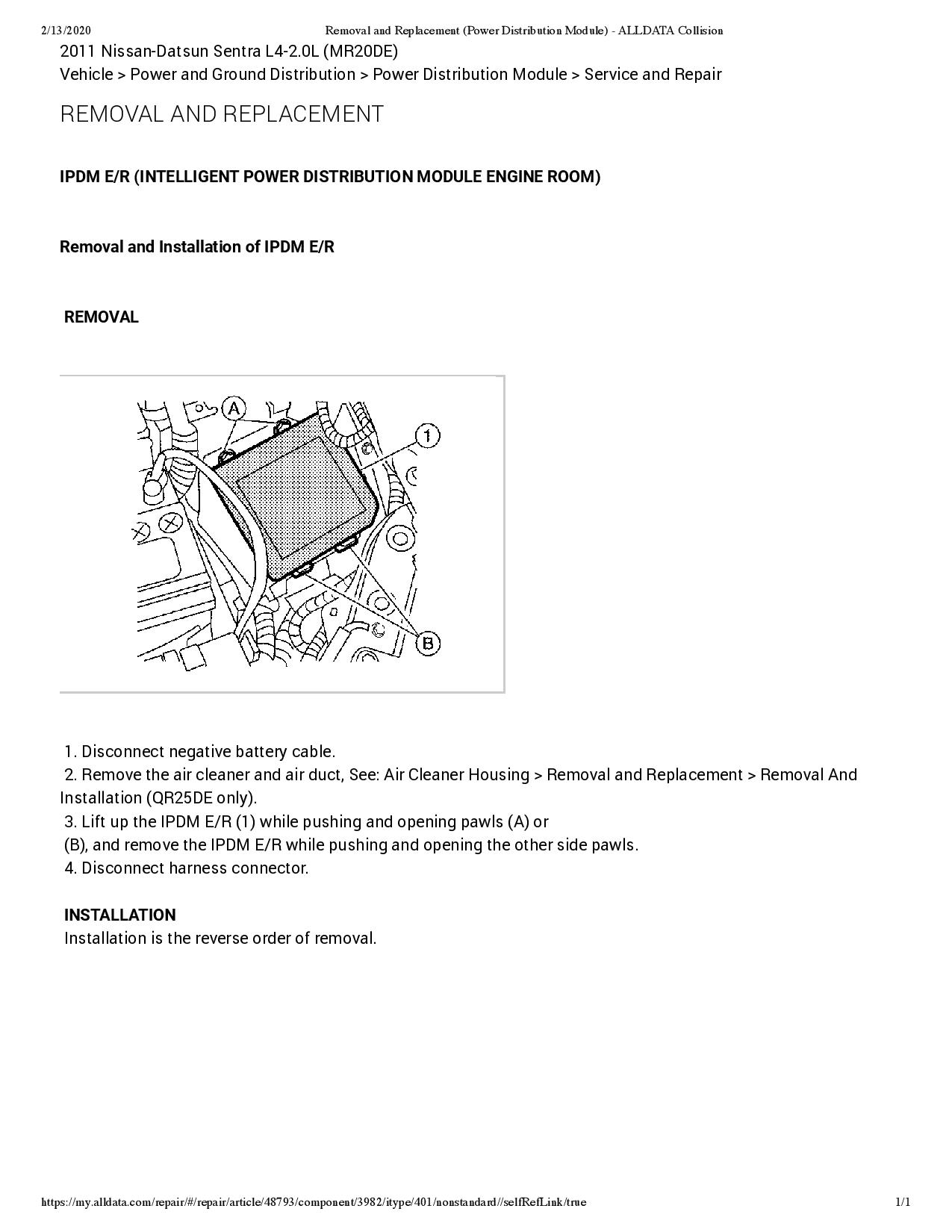

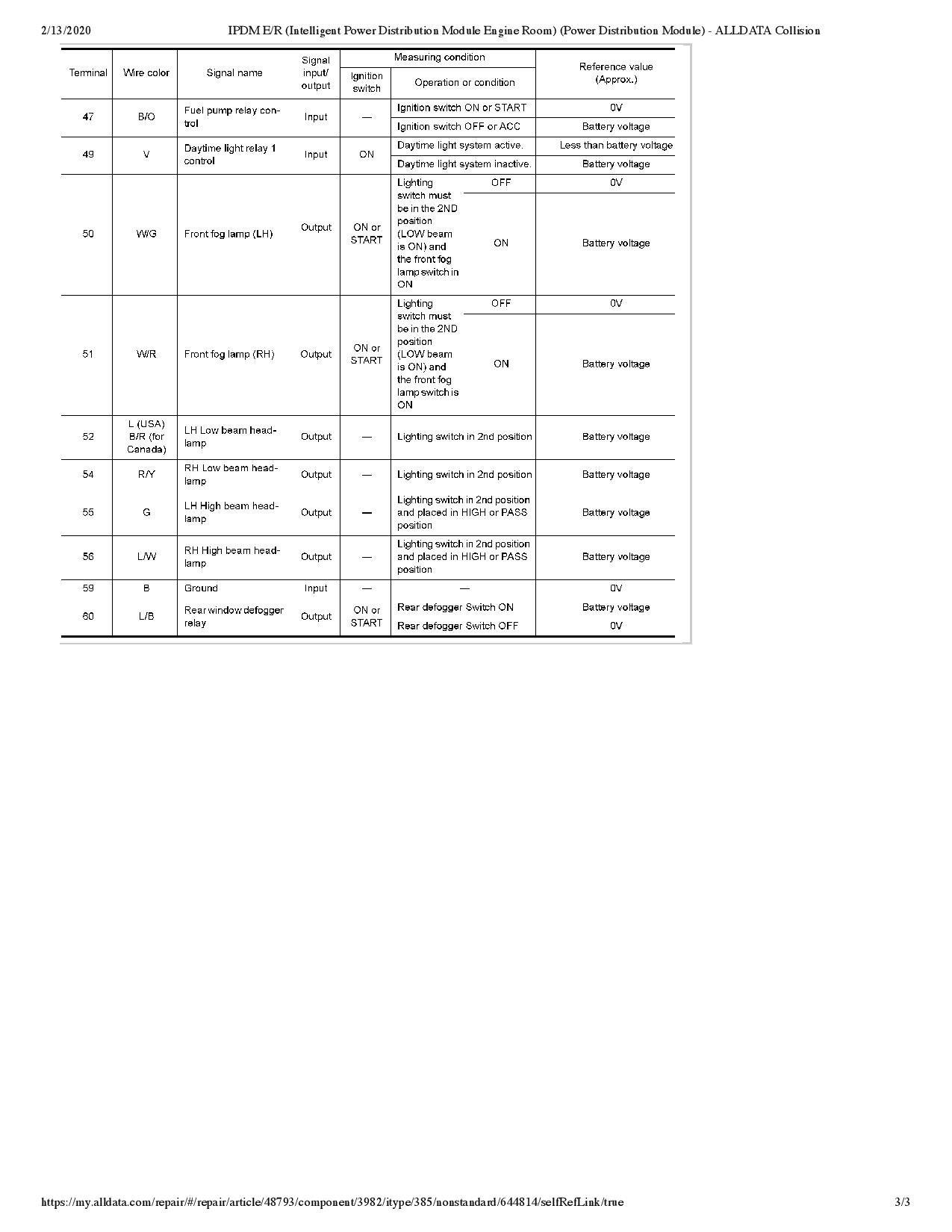

JOETECHPRO
  • 705 POSTS

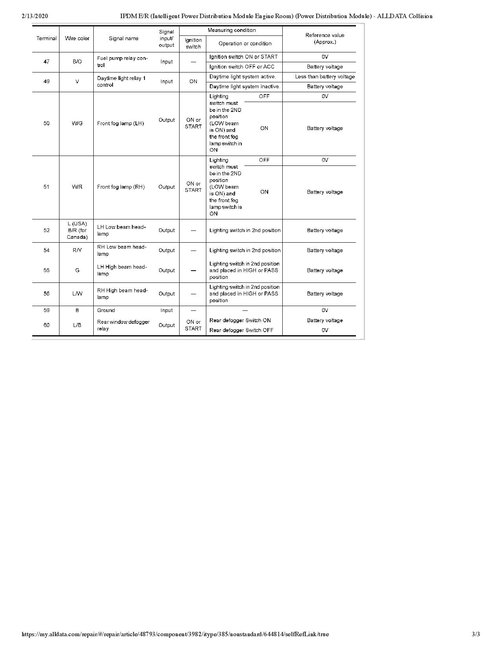

Hey SCGZ,
I have attached information for the pin reference values at the IPDM E/R
There is a document that describes checking the power and ground for the module.
Please check the power and ground and let us know what you get.

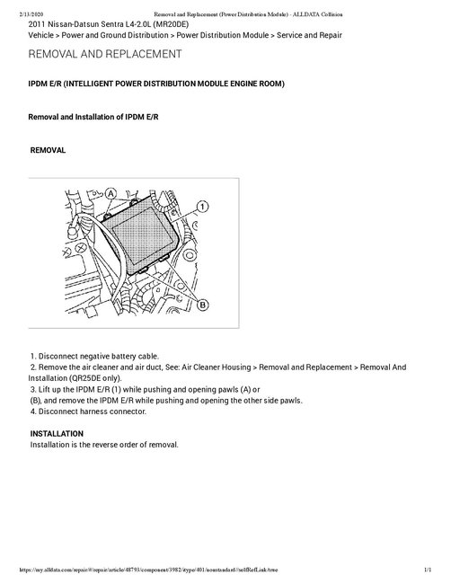

I have also attached the instructions for replacing the IPDM E/R module.
Appears to be plug and play if you can source one online this should work for you.
Regards, Joe

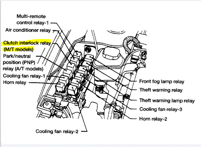

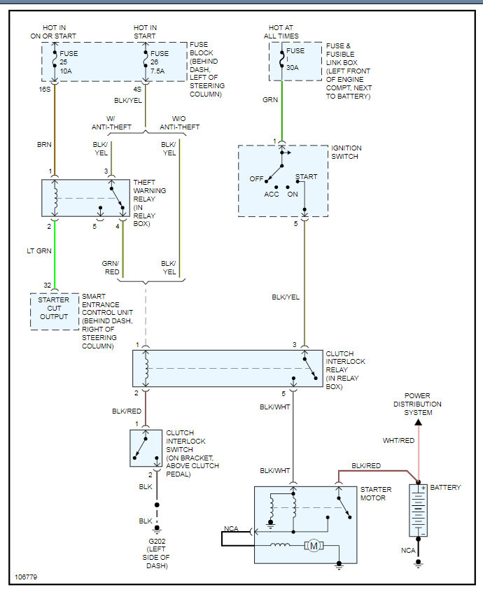

HELPGORDO921

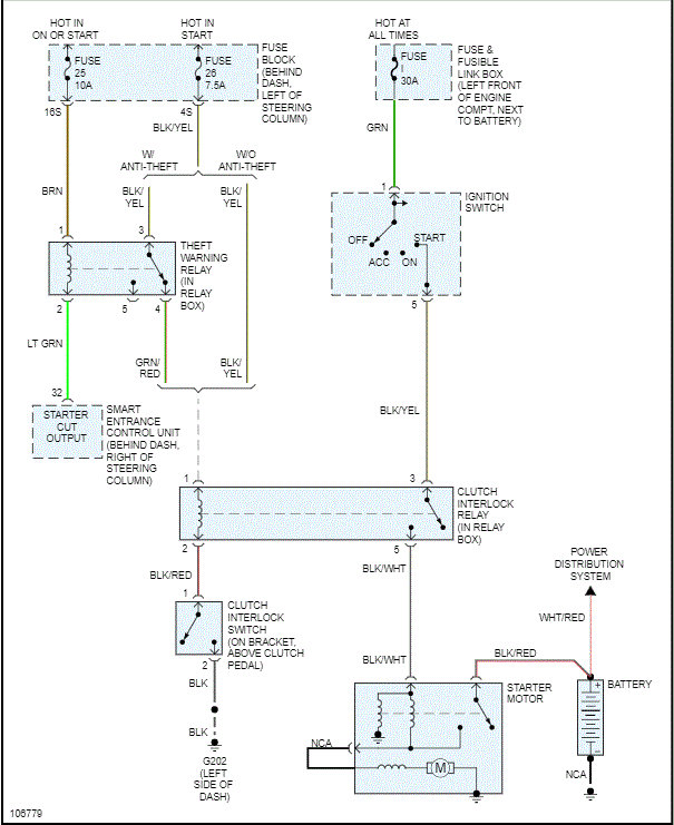

Car won't start, no crank. i replaced clutch relay no difference. my car has new starter and fuel pump all fuses are good.
Your engine being a manual transmission does not have a starter relay.
What happens when you crank the engine? Does it click at all? If not, do you have a security light on?
The other thing we need to check is the clutch interlock switch. This is on the clutch pedal and if you just jump it with a paper clip and see if the engine cranks and starts.
This switch is what is needed to ground the interlock relay. Let me know what you find and we can go from there.
Dec 28, 2020 at 5:19 AM (Merged)
  • 110,241 POSTS

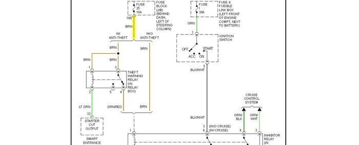

Is there power to the relay? That clutch relay does the job of the starter relay. Take a look at pic 2. I attached the entire starting system schematic.
If you look at pic 1, I highlighted the relay shown in the schematic. Is that the one you replaced? If it is, confirm power to the black wire with the yellow tracer. It should get 12v when the key is in the start position.
Let me know what you find.
HELPGORDO921
Thank you both for the advice. I bypassed the clutch pedal and no difference. but looking at the shamanic I traced it to the ignition cylinder after I bypass that car crank and started.
Okay. Great. So at least you found it. Let us know if you need other info but thanks for the update.
  • 110,241 POSTS
I'm not sure I understand. What did you trace to the ignition switch? Was it a black wire with a yellow tracer? Was it broken or disconnected?

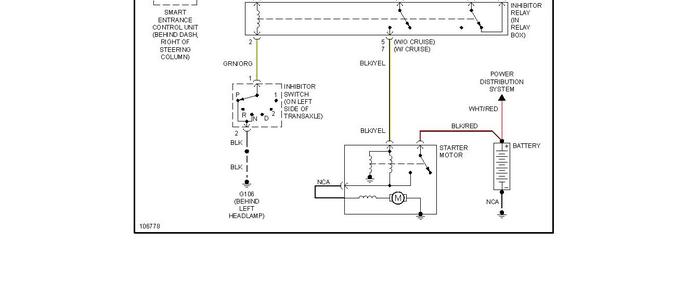

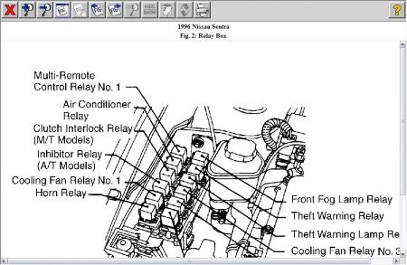

  • 55,402 POSTS

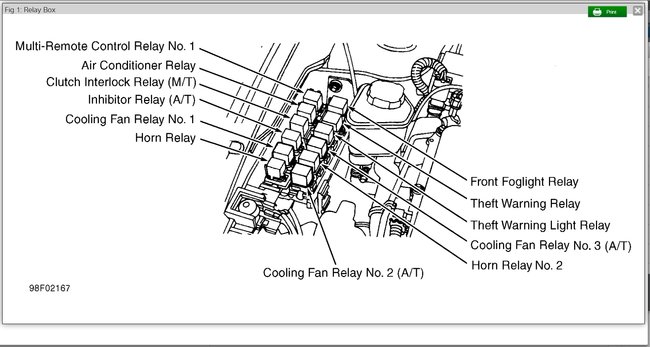

Hello, sorry for the confusion, our experts try their best, the starter relay is called an inhibitor relay, here is its location.
Let me know if it helps
Best, Ken

  • 75,992 POSTS
The inhibitor relay is also the starter relay located in the image below
https://images.2carpros.com/forum/automotive_pictures/12900_inhibitor_relay_1.jpg
Please let us know happens so it will help others.
