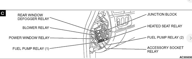

Where is the relay located for the heater blower motor? My heater/AC does not blow on any speed. It came on then went back off a couple times but now not at all. I need to know where the relay is so I can replace it.

Picture attached with relay location. Check out the diagrams (Below). Please let us know if you need anything else to get the problem fixed..........................................
