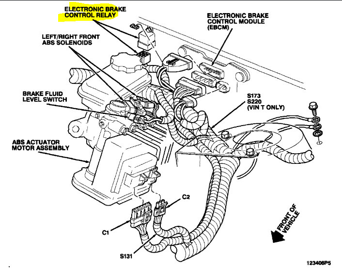

ABS light on and brake light. Tried swapping relays, no blown fuses, bled brakes and master cylinder where abs pump resides. I need to know the location of the ABS relay in case I missed it. I also need to know ohms rating for the wheel speed sensors.

The relay is located under the hood and mounted on the firewall. See pic 1 below.
