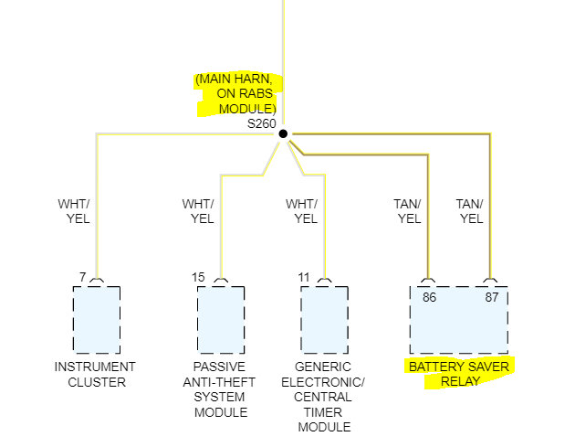

After replacing the battery, fuses started blowing. I gave a new gem ordered but I need to make sure the battery saver relay isn't bad first. Located what I thought was it behind steering wheel, but need specifics to make sure I have the correct relay before ordering a replacement.
Sep 7, 2022 at 6:31 AM
  • 110,248 POSTS

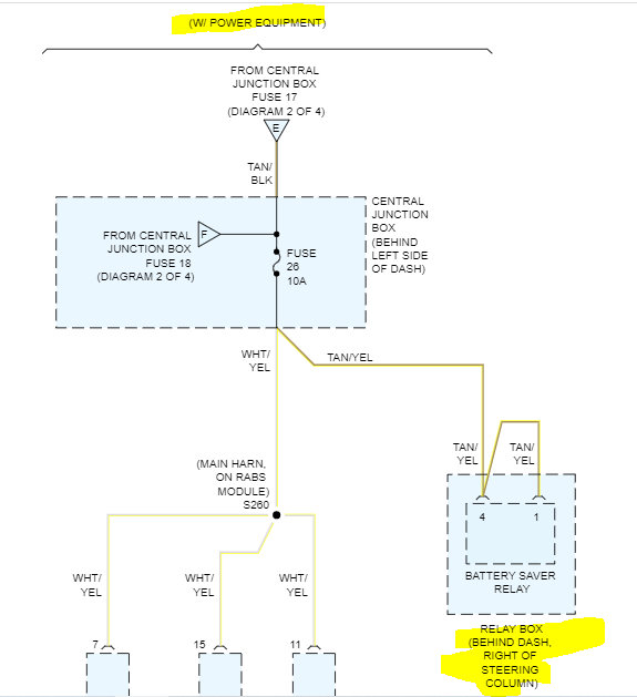

I went through the wiring schematics. I found there are two possible locations based on options. If the vehicle has the power equipment package, it will be behind the dash to the right of the steering column. If it only has rear anti-lock brakes, it is mounted in the main wiring harness at the RABS module.
I attached a pic of both options.
Let me know if this helps.,

Joe, thank you, you're a genius for including the correct color of the wires. That was how I knew for sure I found it
