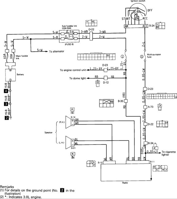

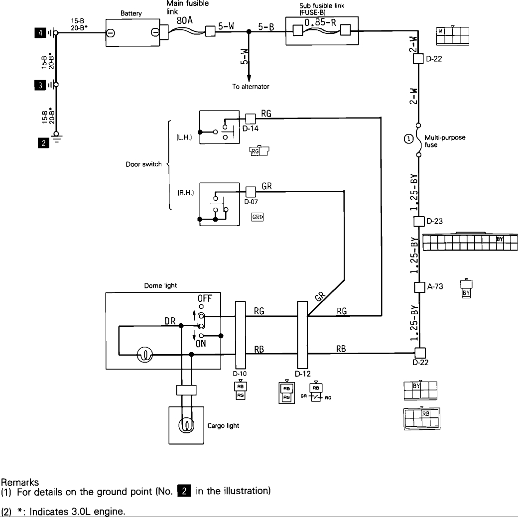

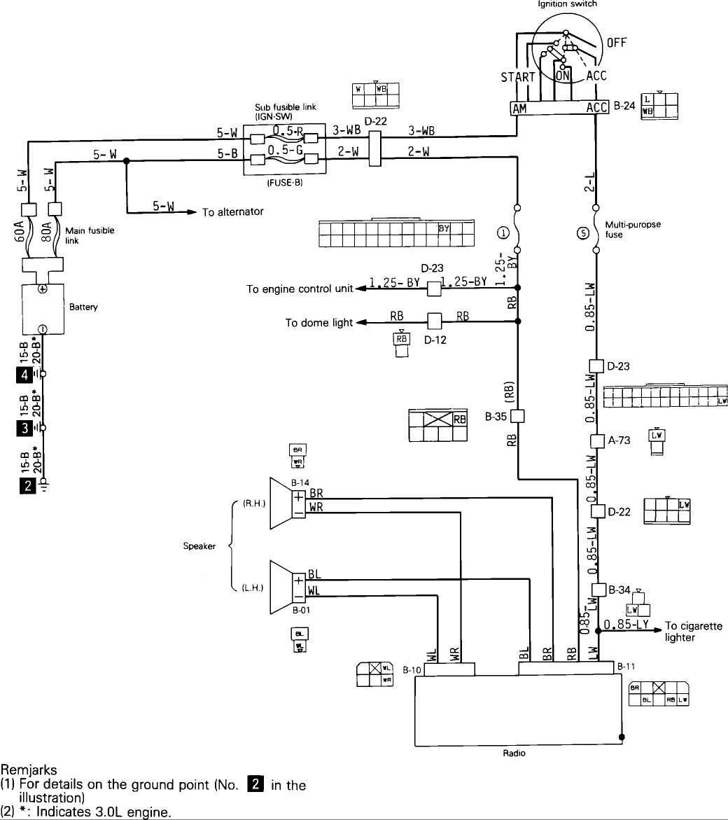

No radio dome light and buzzer stopped working at the same time. All the fuses are good. So I assume there is a hidden relay somewhere and I need to know where it is?

Do not see a relay but there are multiple fuses that feed those items. Including a fusible link. I would test the fuse sockets as they can fail and leave you with no power on the circuit.
That method using the test light might show you if you at least have power to the fuses themselves.
