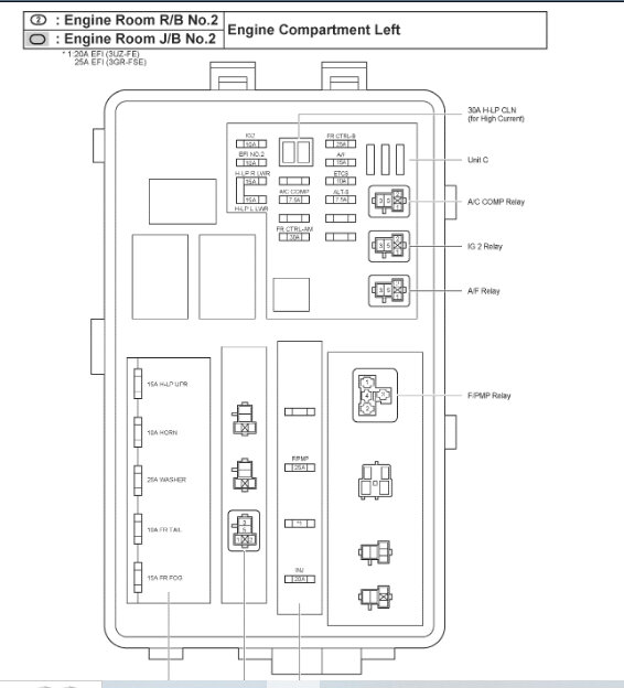

relay location?
2006 LEXUS GS 300
190,000 MILES • 3.5L • 6 CYL • 4WD • AUTOMATIC
LEE1938$
not start.
Jan 13, 2023 at 10:23 AM
  • 110,244 POSTS

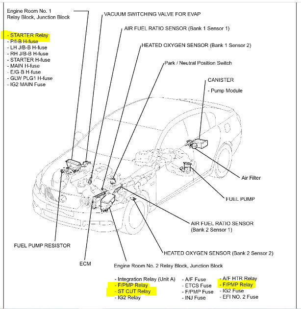

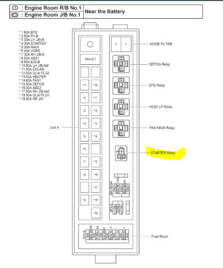

I'm not sure which relay you are looking for, but since it isn't starting, I assume it is either the fuel pump relay or the starter relay.
If you look at pic 1 below, it shows two different locations for the relays. One will be in each. The remaining pics are the relay locations.
Let me know if this helps. Also, here is a link you may find helpful:
Take care and let me know if you need help.
