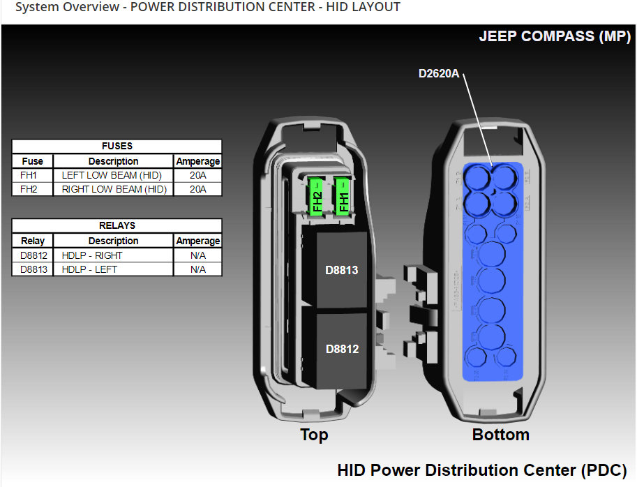

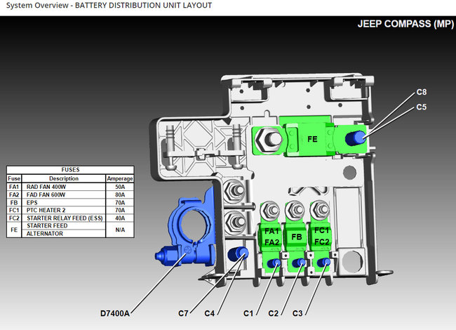

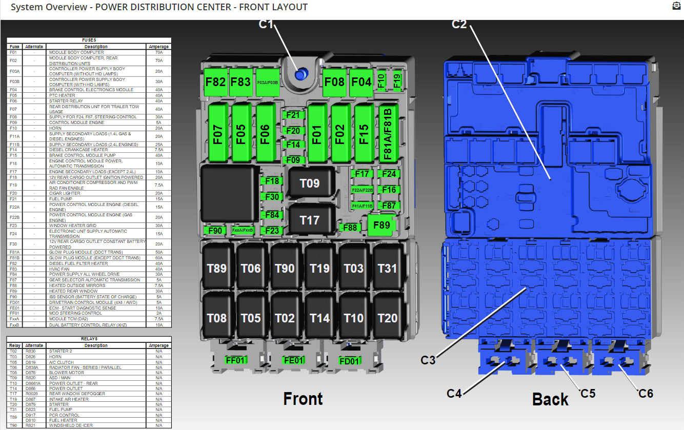

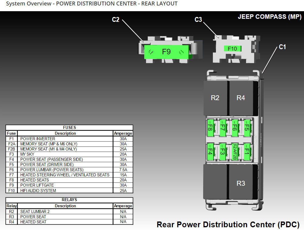

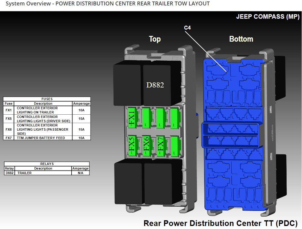

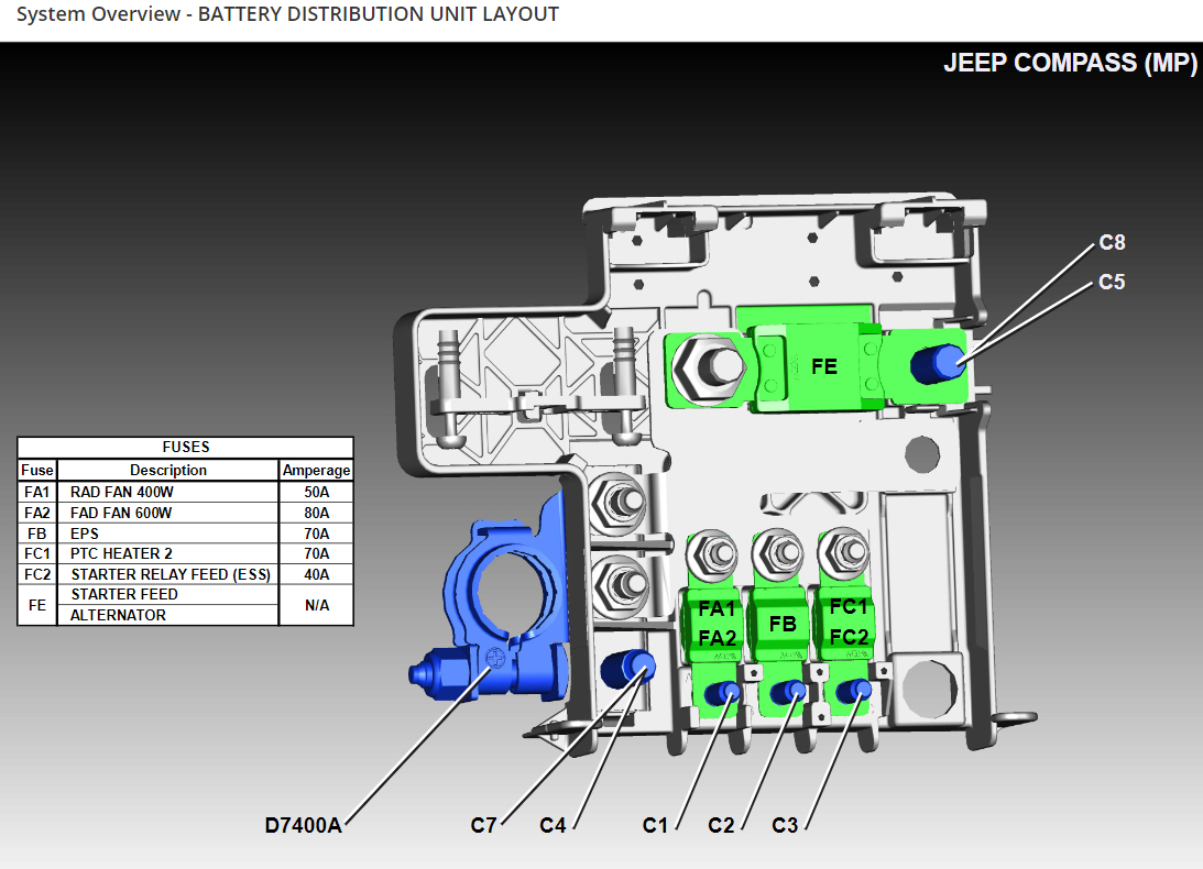

I just need a relay diagram for the vehicle listed above. I've looked everywhere and can't find it online or in the manual.
Jul 20, 2022 at 4:36 PM
BORIS K
  • 836 POSTS
Please see below images.
Hope this helps.
Cheers, Boris

How did you drain the fuel tank and associated fuel system?
Have the spark plugs been replaced? These would be fouled up with diesel as the engine had been running with the incorrect fuel.
Also, please check fuse F21, 15A in PDC (fuel pump) and fuse 23, 10A in TIPM (ignition coils).
Cheers, Boris
