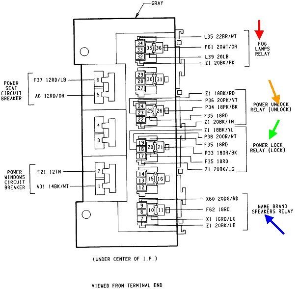

The only diagram I could find is of the rear of the relay box. Can you figure out which relay is chattering and tell me the color of the arrow pointing to it?

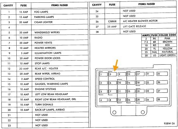

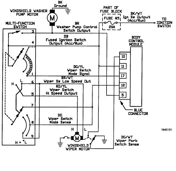

Before we get too involved with the wipers, turn them on to the low or high speed, then tug gently on one of the arms. If they suddenly start to run, even intermittently, there is an easy solution for that.
If the wipers do not run when tugging on an arm, check if the front washer pump runs. If it does not, check fuse # 5 in the fuse block under the dash. That is a yellow 20-amp fuse. If that is blown, there is a good chance the "park" switch in the wiper motor's gear box is shorted. In that case, a new fuse will not blow if the front wiper motor is unplugged.

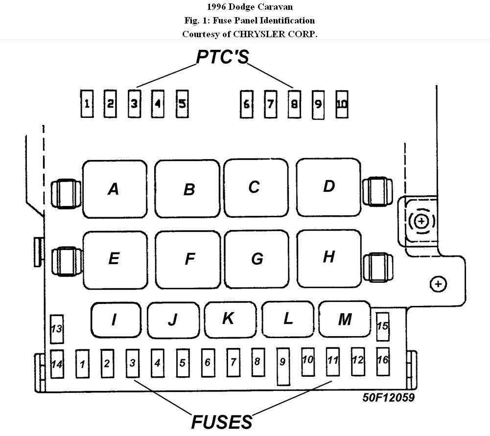

Attached is a diagram that depicts the fuse box under my dash.
in this, it is the relay 'I' that is chatting constantly when the lights are on.
I will try your wiper suggestion when I go outside.
I have checked every fuse and all check okay (I used a Light probe on each side of every fuse).
I have an additional question the "PTC'S" in this diagram what is their function? They appear to be blades that perhaps push in or can be pulled out.

Are you sure about the model year? I have a 1994 and a 1995. Neither of them use PTCs. The fuse box layout you posted is for a 1996 or newer model. That is totally different from front to back from a 1995 model. 1996 models were the first to use PTCs. Those are "positive temperature coefficient" current limiters. They are two-terminal semiconductor devices that act like a dead short up to their rated current. Once that current is exceeded, they instantly go open, just like a fuse, and stop all current flow. Once the short is gone, they instantly reset and start passing current again. These are soldered to the circuit board in the fuse box.
This diagram is what I found for a 1996 model. The inside fuse box on a 1995 is right under the dash panel, just in front of the parking brake release lever. On 1996 and newer models, it is attached to the Body Computer, then the whole assembly is bolted to the firewall, in front of the parking brake pedal assembly, and left of the brake pedal.
