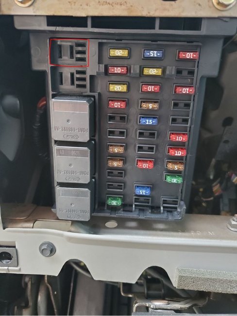

This morning I went to drive to work and when I opened the door, I discovered that my HVAC blower was on. There was a faint humming nose from under the dash as well. I started the engine and runs with no problem. I can turn off the blower and the A/C at the HVAC panel. But, with the key off, i am still able to turn the A/C and blower on. This shouldn't happen and has never happened before. No work has been done to the vehicle recently that would involve anything like that.
Last night it rained really hard and I didn't think about it much at first but upon further inspection I noticed the carpet was wet under the area between the clutch pedal and the kick panel. I'm thinking I might have a leak in the windshield seal but I'll have to check that out.

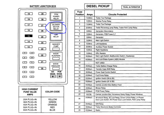

The relay that was buzzing (pictured below) is relay number 1 on the interior fuse panel inside the vehicle. This relay is labelled "interior lamp" and is not shown in the picture and I have removed it for testing.
Anyone with a 2000 F250 Super-duty had a problem with water intrusion causing weird things like this?

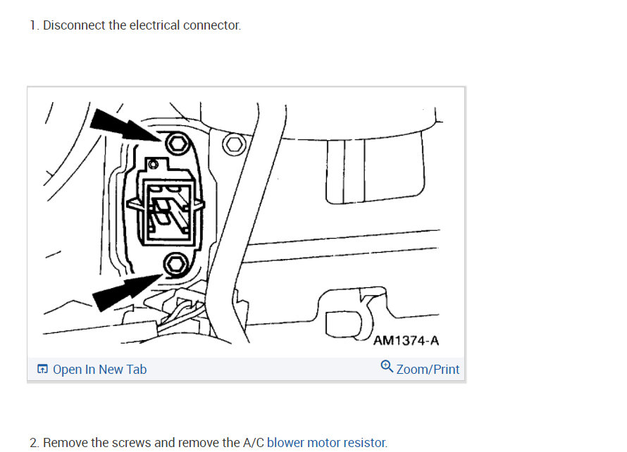

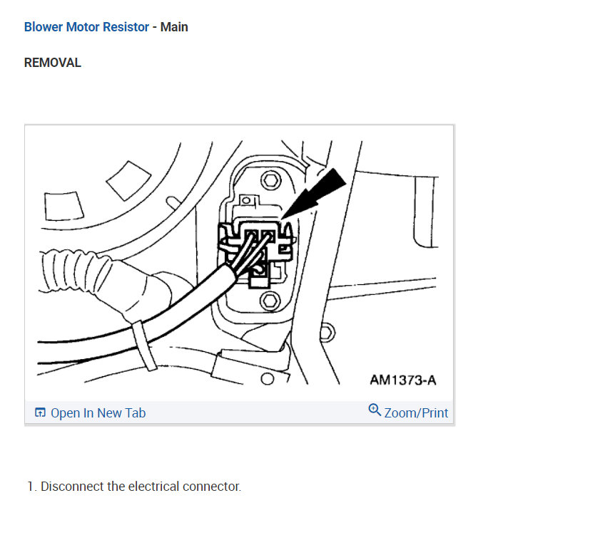

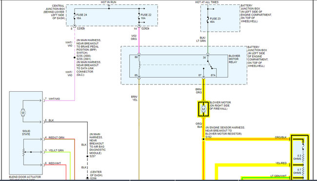

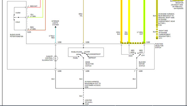

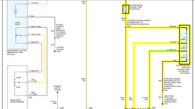

Go under the dash and disconnect the blower resistor and see if the issue stops.
The resistor may be shorted to power sending power all the time to the blower and the control head.
I attached the wiring diagram of the system. There is also a relay for the blower. Remove it as well.

After reinstalling the interior fuse panel and GEM assembly, the problem is still there. With the Key off and the HVAC switch to off, nothing happens. Switching the HVAC switch to on will make a relay click out in the engine compartment (RH side). So playing with it a little more, if I rotate the HVAC selector to the right (one click "Bi-level") the relay clicks and the fan will blow at whatever speed it is set on. I can turn the fan speed up or down as normal. When turning the mode switch back to "off" the passenger airbag disable light comes on for a few seconds and then goes out. Back on again with the mode switch, several relays begin to hum. one under the radio, The interior lamp relay, under the hood, the two relays next to the junction box, (i think these are for the towing package?) my Alldata is not working so I cannot look up any schematics and such.

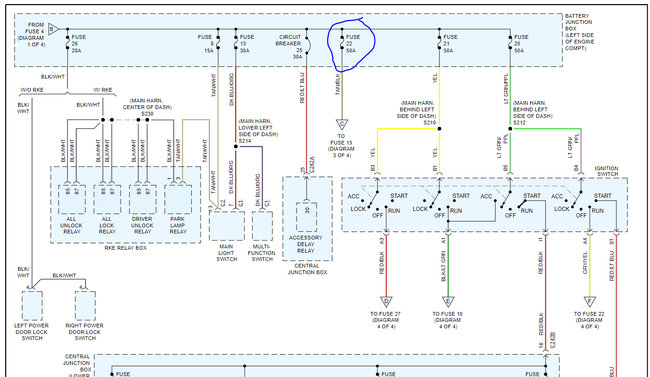

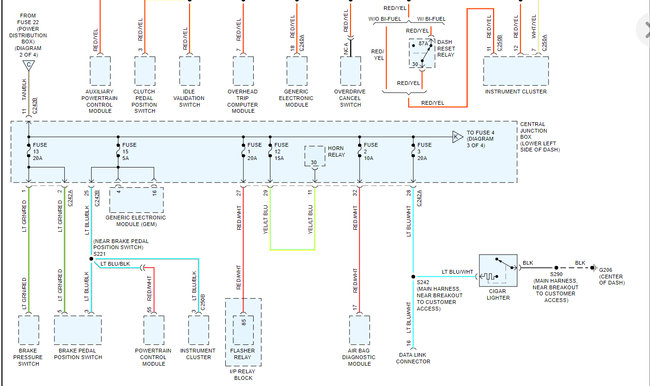

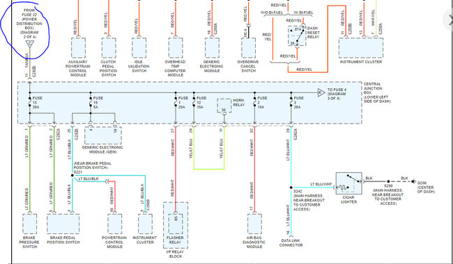

Roy, could you grab me the schematic for what feeds Fuse 22? This should only be hot when the key is on, and it is hot when the key is off. Can you help me trace this back? I have a feeling my issue might be in the CJB in the engine compartment.
Jun 22, 2021 at 2:06 AM
Okay, 22 feeds a lot of fuses. I attached the diagram for you to view.
If there is no power, the bus bar in the fuse block may be the issue. It would require removing it and either repairing it or replacing it.

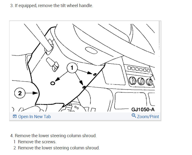

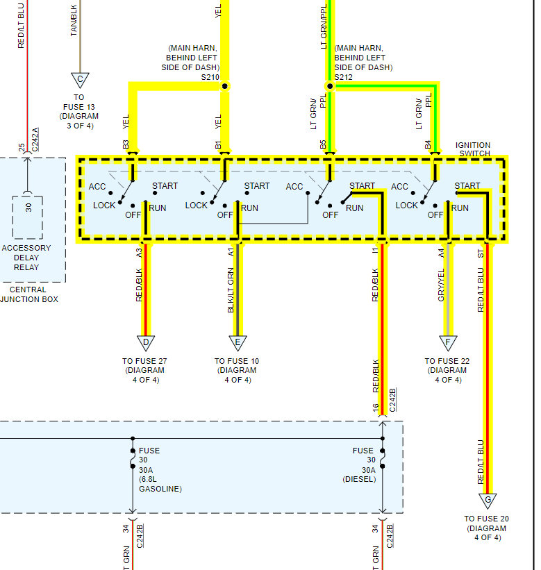

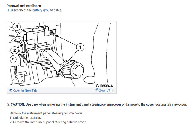

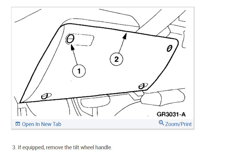

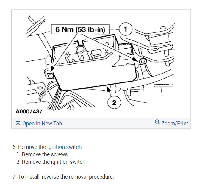

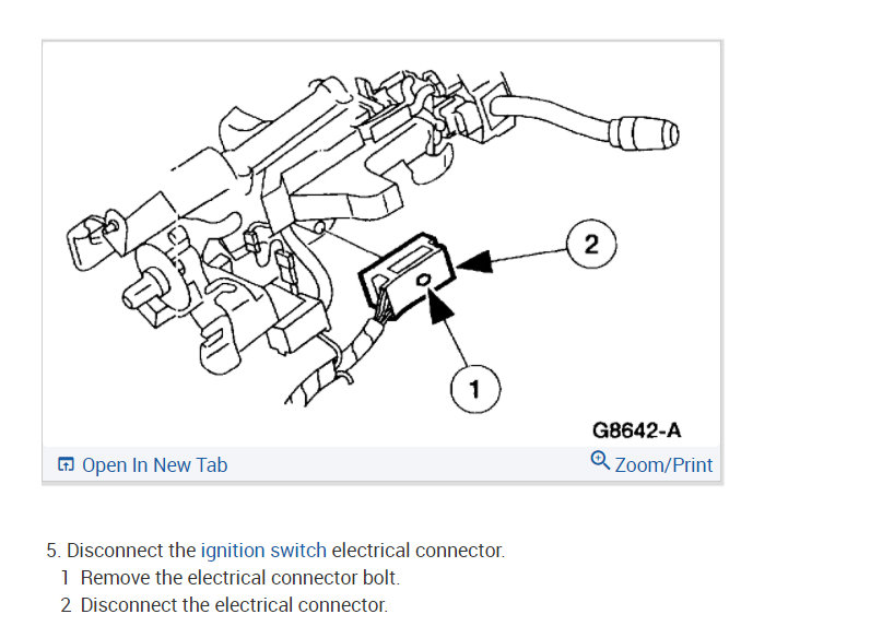

Actually I have the opposite problem. I have power to things that should have power only in "run" and "start" With the key "off", they should be dead. Instead I am getting power. I finally got back into Ford PTS and looked over the schematics. It appears to me that a probable cause could be the ignition switch. I don't have time tonight but I'm going to pin that out tomorrow and see if it has a short in one or more of the outputs for "run". Particularly pins A4 and B4.
Jun 22, 2021 at 11:18 AM
I attached the procedure for the switch below.
I also attached the diagram for the switch as well for you to check.
Let me know the results.

I agree with Roy did you check the blower motor resistor? If the resistor is burnt, melted, etc it can do funny things. Hope this helps.
