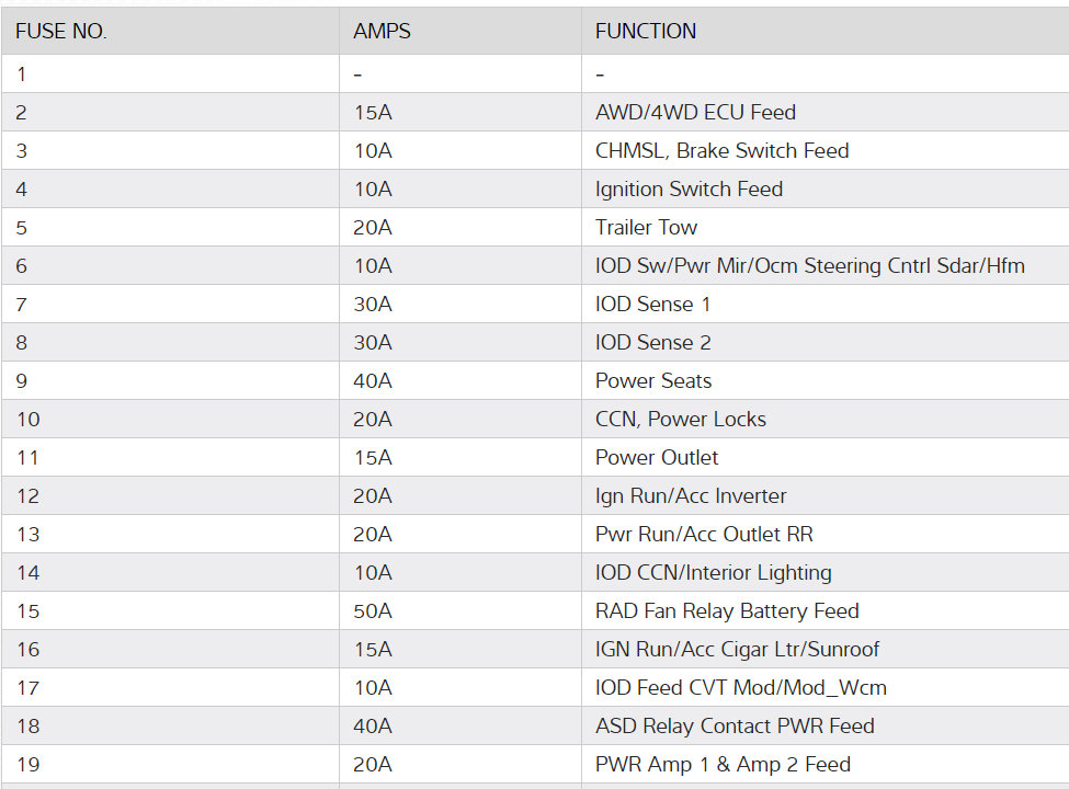

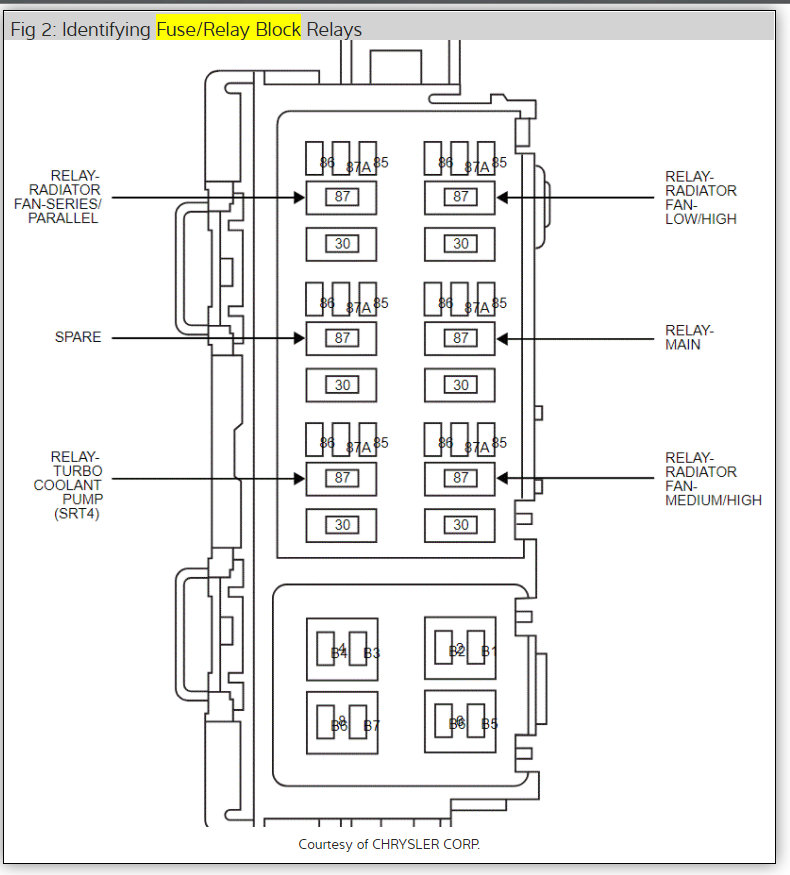

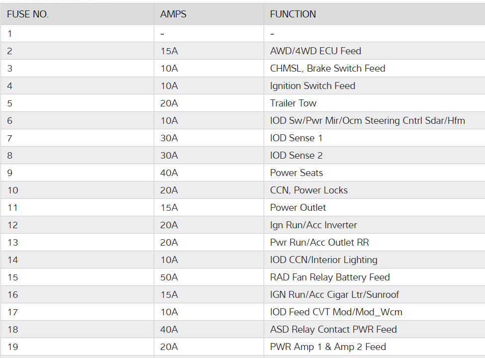

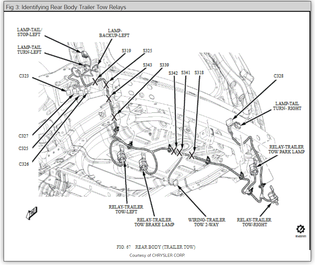

I need a color coded wiring diagram for the four relays that are behind the head lights.

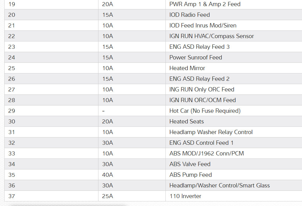

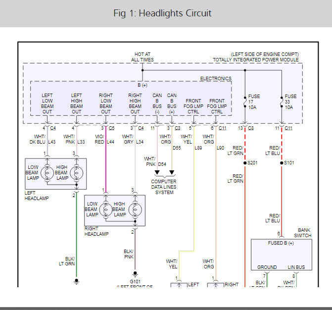

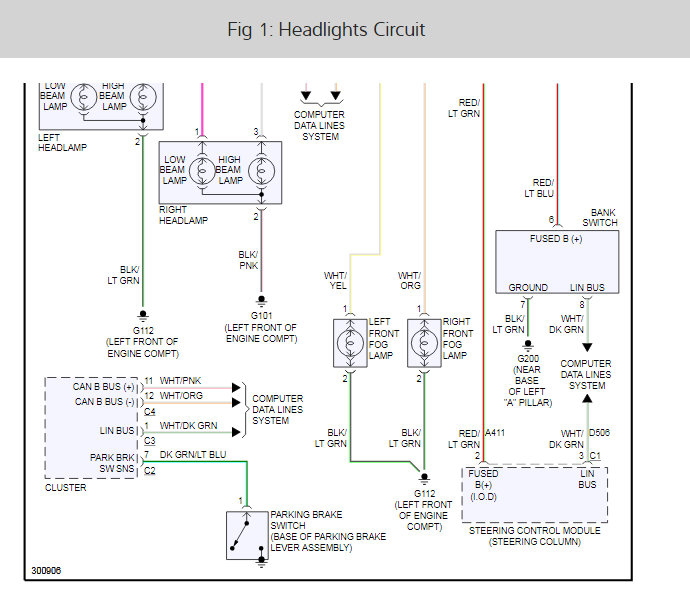

In the diagrams down below I have included the wiring diagrams for your vehicle's headlights as well as the location, diagram, callout, and connector end views for your vehicle's Totally Integrated Power Module (TIPM). I hope this helps, and please get back to us with how everything turns out.

I have a 2007 Dodge Caliber and I recently took it to the shop because I had a headlight out and the headlight was not blown. They told me that I had a circuit blown in my fuse box that controlles the low beam to my headlight and they would have to replace the whole box and they could not just fix the circuit that had blown. They informed me that the part would be $745. Is it true that they cannot fix the circuit or am I just getting ripped off?

This is interesting because I have the exact same problem. My passenger low beam doesn't light.
I didn't take it to the shop, but I traced the circuit all the way to the fuse box. I removed the entire fuse block from the car and disassembled it to the circuit board, then traced the connector to an integrated circuit chip. It's apparent that the chip that controls it is defective.

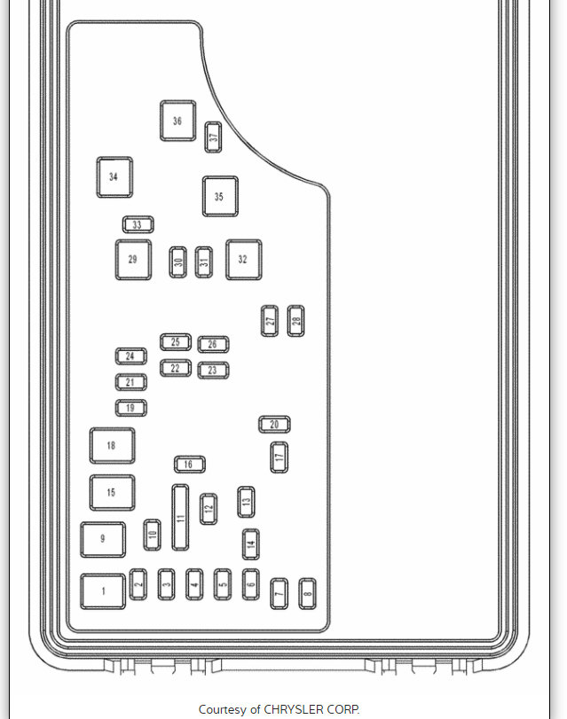

Where is the fuse for headlights?

If both headlights are out and bulbs are good then it is either the headlamp switch, wiring of the headlamp circuit or a faulty totally integrated power module (TIPM)
Here is a guide to help you test for power at the fuses
Check out the diagrams (Below). Please let us know what you find.
