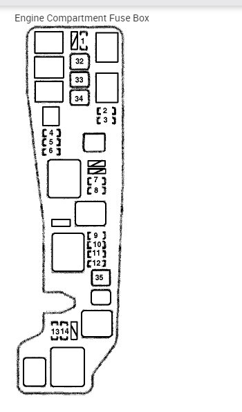

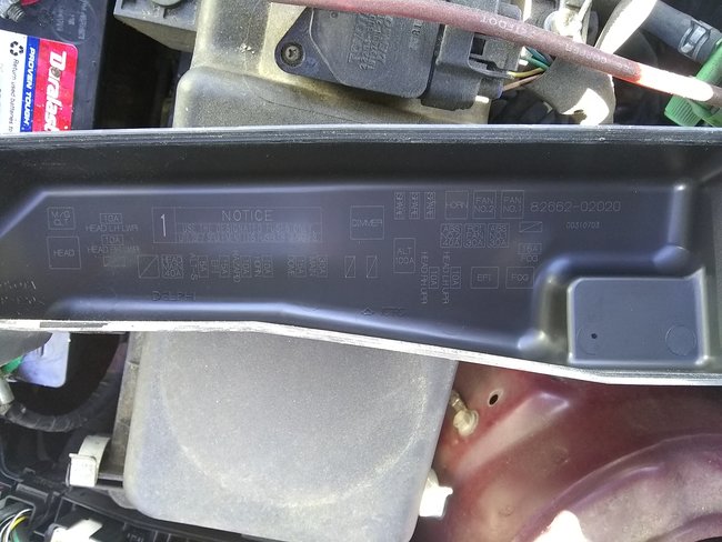

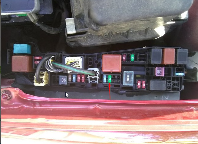

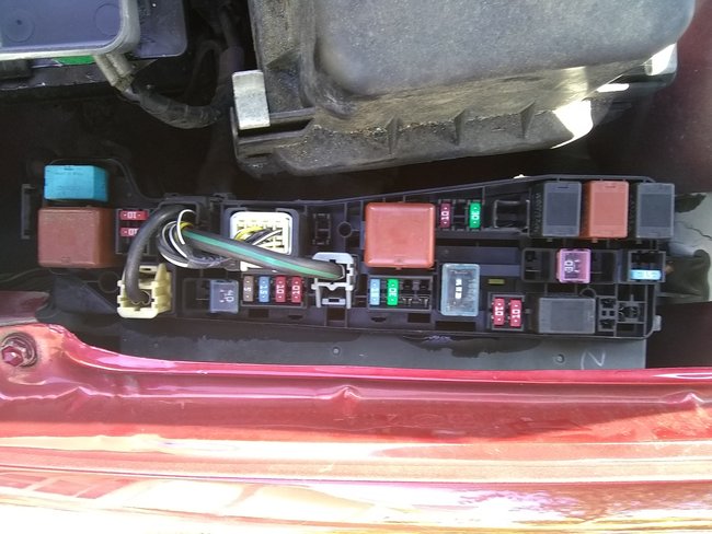

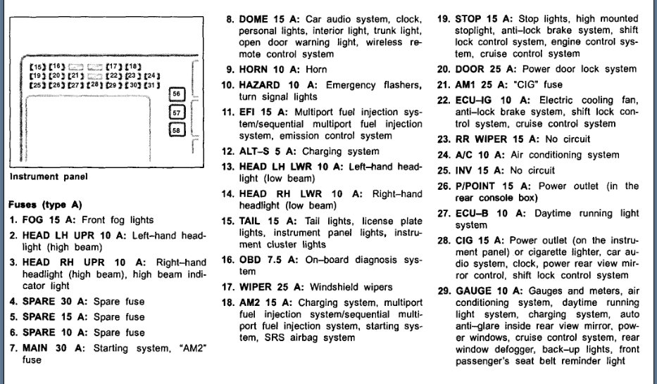

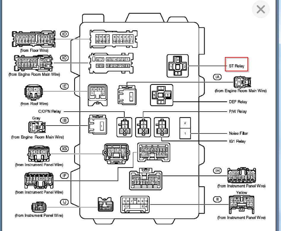

Hi Expert, I would like to know from the attached pictures where is the starter relay and fuse in my car listed above LE model?
Please can you crop on them?
By the way, I am not able the start my car, I have a new tested battery, the starter is also tested and working fine, I am thinking the issue is limited between the relay, fuse and ignition.

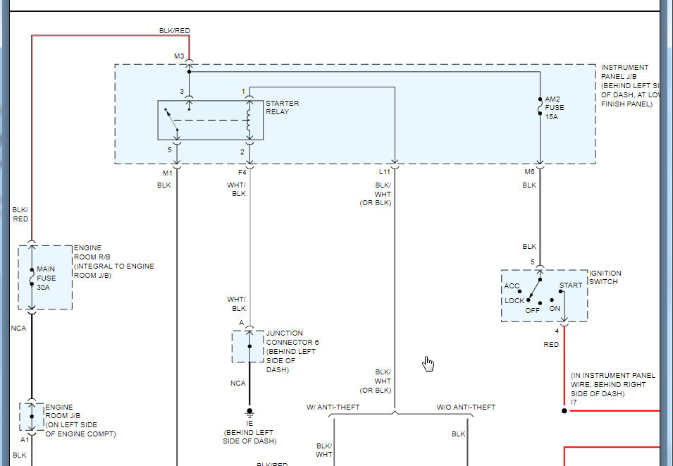

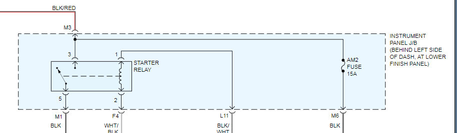

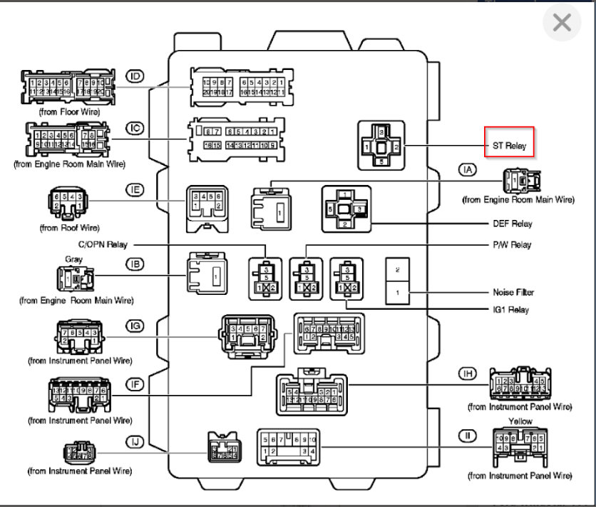

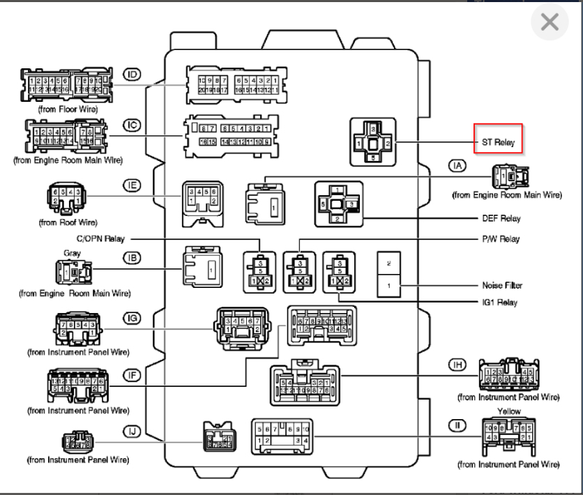

That is a picture of the engine compartment box. The fuse is located in this box and I pointed to it, but the relay is located in the instrument panel. I attached an illustration of that one for your review.
