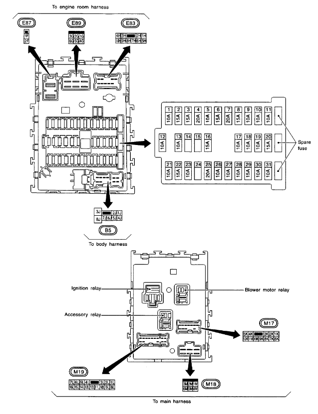

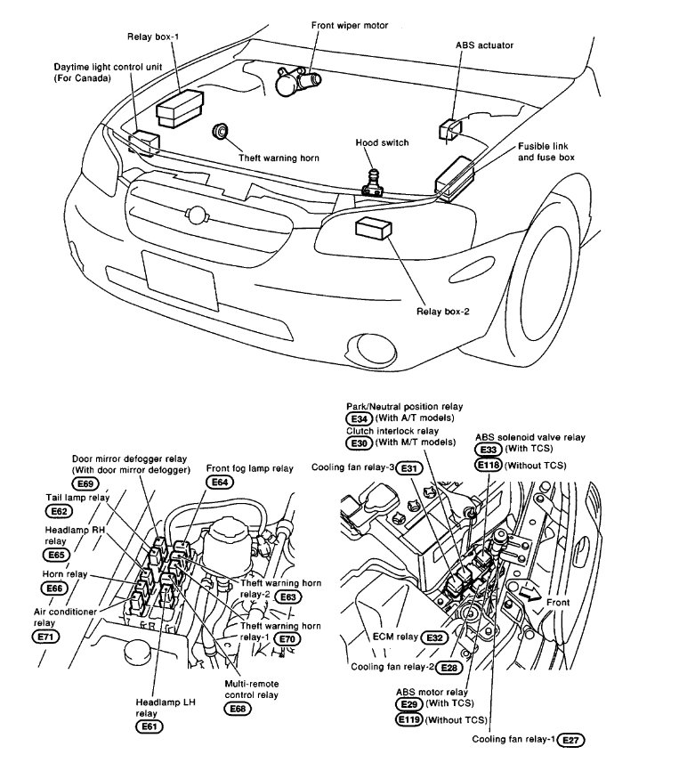

I am trying to remove the relays from relay box #2 in front of the battery and check them, but they all seem to be stuck in place. What do I do?
Aug 3, 2021 at 9:21 AM
SQM
  • CAR REPAIR CONTRIBUTOR
  • 6,383 POSTS
Is there a specific issue you are having?
Relays can be tested using a test light or voltmeter.
Here is some helpful info to get you started:
I have also attached the relay diagram for your reference.

Yes, my cooling fans and dash lights stay on and my power windows still have power until I disconnect the battery. I wanted to check the fan relays but they are stuck in the box, any suggestions will be welcomed.
Aug 3, 2021 at 10:26 AM
SQM
  • 6,383 POSTS
Those relays come straight out of the socket. They are probably just seized on there, or something could have melted and made it to be stuck.
Try using a needle nose plier to pull them out. You can try wiggling them back and forth. But there are no special trick to it.
If you use the pliers careful not to crush the relay.

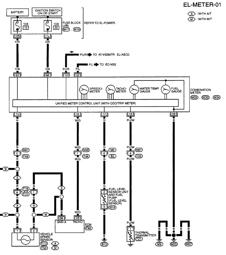

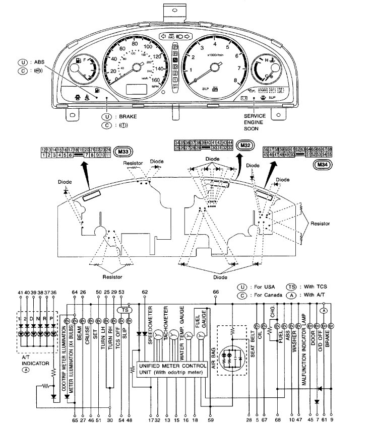

Thanks. Do you know what would keep my dash lights on even with the key out? I've changed the ignition switch but now I'm just scratching my head.
Aug 3, 2021 at 2:30 PM
SQM
  • 6,383 POSTS
It sounds like you have a short somewhere in the wiring harness. Which keeping the circuit complete without your key in the ignition.
You might have to trace the wirings to find the short. Look below for the wiring diagram.
Were you able to pull the relay out?
Aug 4, 2021 at 11:23 AM
DARRELL ANDREWS
  • 23 POSTS
Yes, I finally got the relay out, it took some patience wiggling back and forth. I guess it should be expected for 20 year old relays. Thank you. now it's time to tackle these wires.
