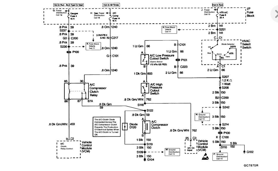

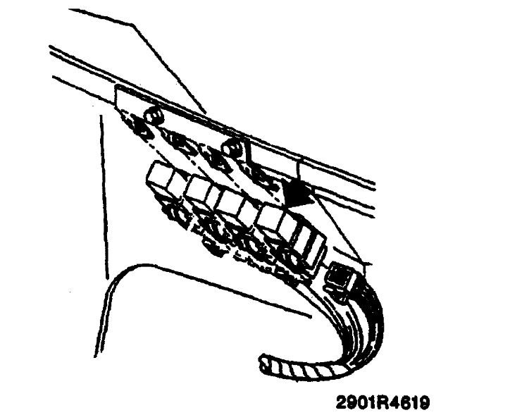

I cannot find a diagram or any information to tell me which of the three relays on the passenger side under the hood is the one to the A/C compressor.
May 4, 2018 at 7:24 AM
Good afternoon.
Attached is the diagram for you and the location.

Can you tell me what the far left relay is? I see now where there should be four and I am missing one.
May 4, 2018 at 8:07 AM
Does not identify which relay is which. Is there a connector hanging with no relay attached?
May 4, 2018 at 8:17 AM
HEATHER DAWN HILLHOUSE
  • 5 POSTS
Yes.
May 4, 2018 at 9:28 AM
  • 5 POSTS
There is just a slot where a fourth could go.
May 4, 2018 at 9:29 AM
It most likely was for a accessory that was not part of your package.
