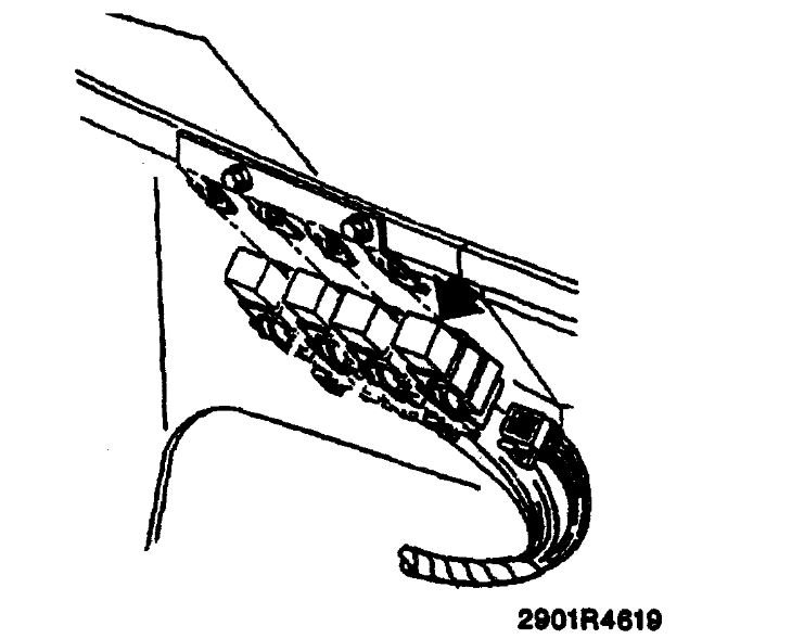

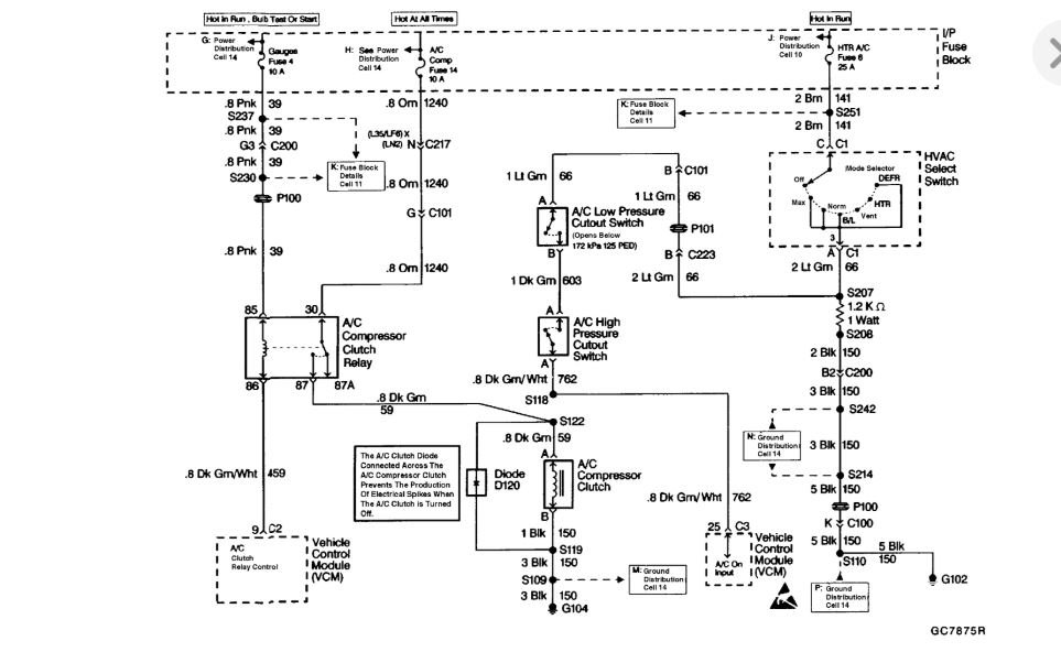

I cannot find a diagram or any information to tell me which of the three relays on the passenger side under the hood is the one to the A/C compressor.

Attached is the diagram for you and the location.

Can you tell me what the far left relay is? I see now where there should be four and I am missing one.

Does not identify which relay is which. Is there a connector hanging with no relay attached?

Yes.

There is just a slot where a fourth could go.

It most likely was for a accessory that was not part of your package.
