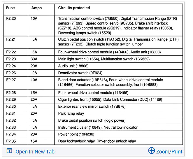

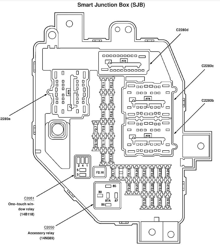

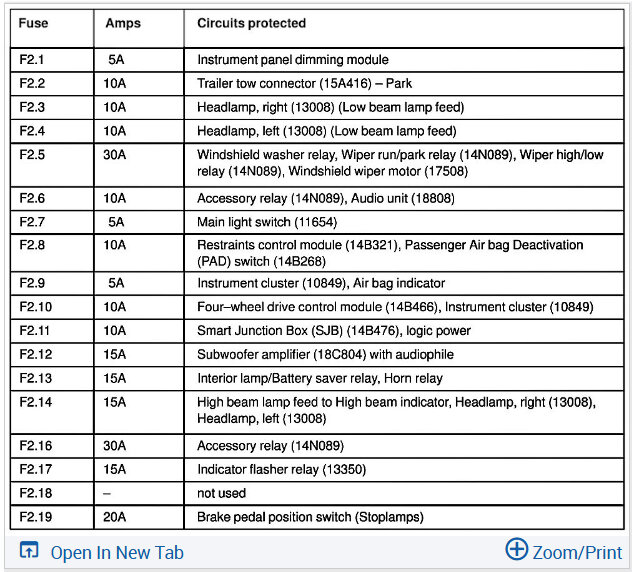

I was installing a radio/aftermarket and forgot to ground out or unhook neg battery terminal and threw a tiny spark then no power windows or wipers or dash lights but other accessories work.
Nov 5, 2024 at 1:55 PM
  • 55,224 POSTS

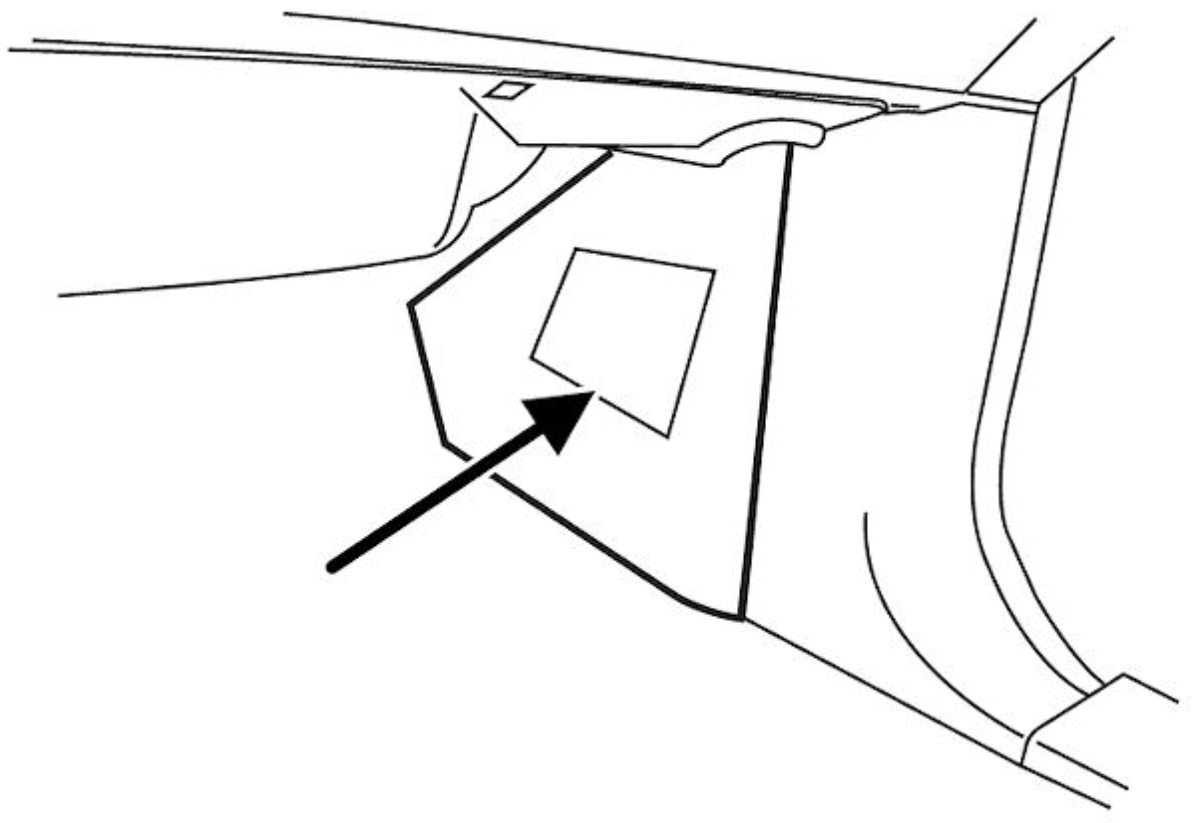

It might have taken out the smart junction box (SJB) but we should check the fuses with the ignition key on. Here is a guide to help and the fuse locations in the diagrams below:
The fuses should have power as well. Check out the images (below). Please let us know what happens.
